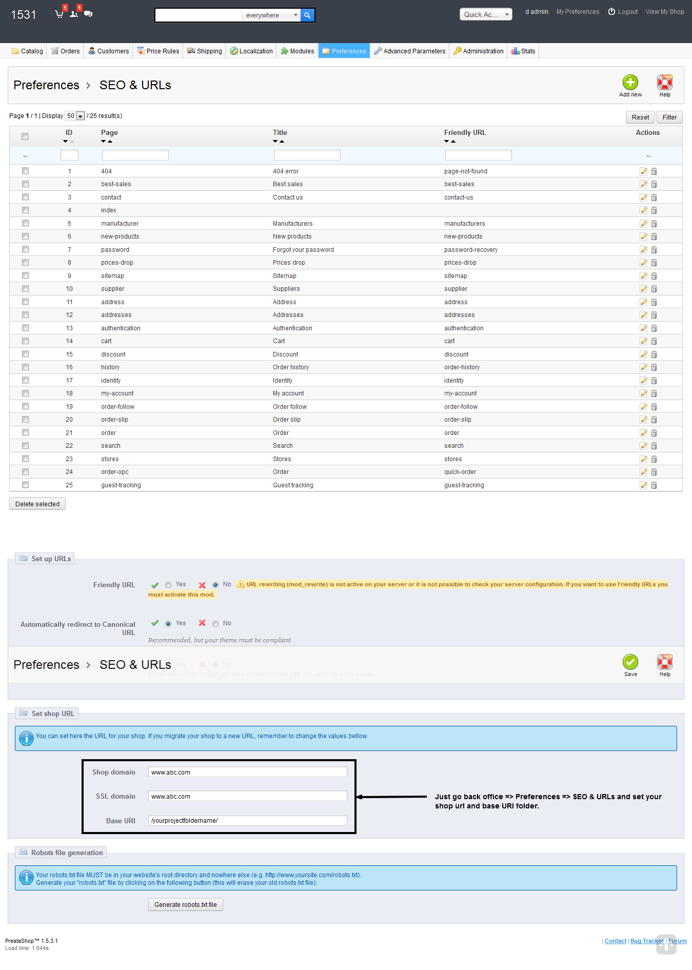

Solved!
Best way to set URL please follow this attachment, enjoy it - :)
i think this isn't the best way because sometimes I cannot get to prestashop admin panel and I must edit this pools in PHPMyAdmin.
Of course you propose nice option to change this parametr :) thanks!
Edited by Epredator (see edit history)
