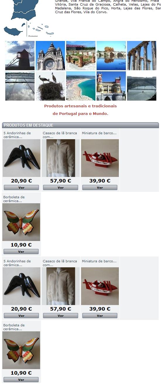

1 - What I basically need is to show the "Featured Products" module inside some CMS pages, not all (you can find an example in 1.jpg). Is this possible? If so, how can I do?
2 - One other thing I'd like to change, in "Featured Products", is the font type, size and remove bold from the first line (as seen on 2.jpg). I tried a few things but none of them worked...

I did what you said and got something like this (see attached file).
It is actually showing the content of home text editor followed by featured products. I'd like to show only the featured products and remove the home text editor content.
Other issue may occur in the featured products width which is breaking each line and moving the 4th item to a new line...
