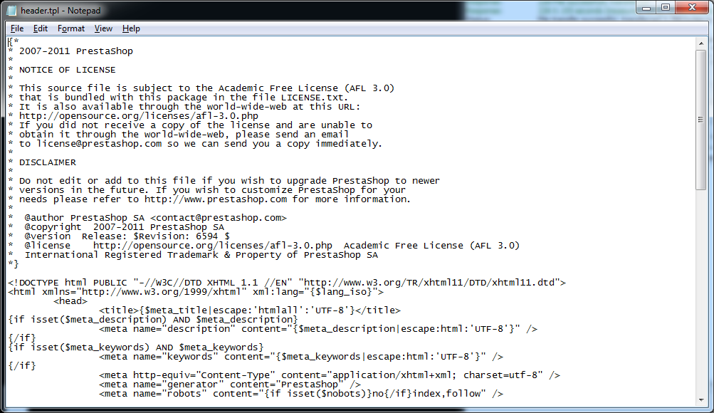

CartExpert.net Posted April 2, 2012 Share Posted April 2, 2012 I have added this code to my theme/header.tpl but it has not seem to have fixed it. I have deleted internet files / ensured force complie is on and cache is off Your doctype is not recognised in IE9. You need to change this line in header.tpl <!DOCTYPE html PUBLIC "-//W3C//DTD XHTML 1.1//EN" "http://www.w3.org/TR/xhtml11/DTD/xhtml11.dtd"> to <!DOCTYPE html PUBLIC "-//W3C//DTD XHTML 1.1 //EN" "http://www.w3.org/TR/xhtml11/DTD/xhtml11.dtd"> Link to comment Share on other sites More sharing options...

john.mcdowell Posted April 2, 2012 Author Share Posted April 2, 2012 Have you recompiled the template files? In IE9 go to: http://www.cartexpert.net right click anywhere on page and select 'View source' . You will see the doctype. Do this with your site, and you will not see the doctype. And for now remove the script from Google. No I didn't recompile the template files, I had a look at your site in Internet Explorer and can see the clean layout and mine seems like a jumbled up mess ? Is there something that would have caused this ? I have taken a scren cap of my header.tpl (attached) Link to comment Share on other sites More sharing options...
CartExpert.net Posted April 2, 2012 Share Posted April 2, 2012 (edited) We can not re-create the issue you have using your header.tpl . It must be something else causing the problem. Edited April 2, 2012 by CartExpert.net (see edit history) Link to comment Share on other sites More sharing options...
