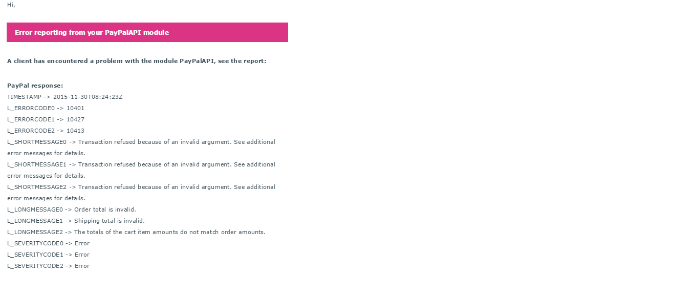

Hi, I have 1.0.6.9 of prestashop and this form has always worked but today I received these emails whit this text:
Error reporting from your PayPalAPI module
A client has encountered a problem with the module PayPalAPI, see the report:
PayPal response:
TIMESTAMP -> 2015-11-30T08:24:23Z
L_ERRORCODE0 -> 10401
L_ERRORCODE1 -> 10427
L_ERRORCODE2 -> 10413
L_SHORTMESSAGE0 -> Transaction refused because of an invalid argument. See additional error messages for details.
L_SHORTMESSAGE1 -> Transaction refused because of an invalid argument. See additional error for details.
L_SHORTMESSAGE2 -> Transaction refused because of an invalid argument. See additional error messages for details.
L_LONGMESSAGE0 -> Order total is invalid.
L_LONGMESSAGE1 -> Shipping total is invalid.
L_LONGMESSAGE2 -> The totals of the cart item amounts do not match order amounts.
L_SEVERITYCODE0 -> Error
L_SEVERITYCODE1 -> Error
L_SEVERITYCODE2 -> Error
post-1119372-0-96920100-1448874506_thumb.pngmessages
anyone can help me?
