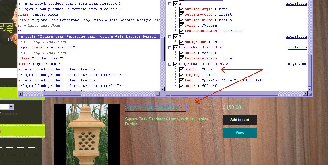

tdr170 Posted February 7, 2012 Posted February 7, 2012 Find the file style.css and look for the section labeled UL#products list LI H3 A and change the width to 200. 1 Share this post Link to post Share on other sites More sharing options...

tdr170 Posted February 8, 2012 Posted February 8, 2012 My post as how to fix your issue was done using my Developer tool and works. 1 Share this post Link to post Share on other sites More sharing options...
