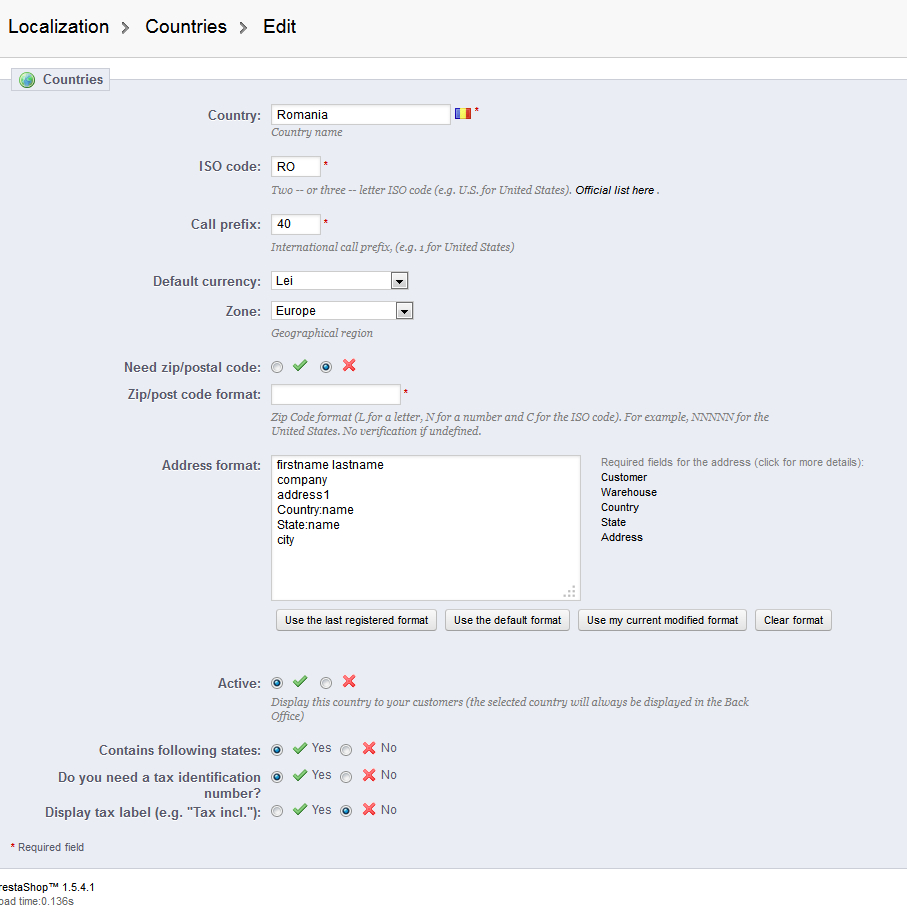

Hi guys,
I need some help. What should i do to make DNI field optional and not required? I'm very confused - i don't know which files must be modified. I read so many solutions...
PrestaShop™ 1.5.4.1 - default theme
Thanks!
can you please open the /classes/Address.php file and check the object definition?
you've got there something like:
'dni' =>	 array('type' => self::TYPE_STRING, 'validate' => 'isDniLite', 'size' => 16),
you've got the same?
@cornelm i think that the problem is somewhere else, but im waiting for your answer related to the object definition
everything depends on it :)
Guest cornelm
Also, please see enclosed entire content of address.php
Thank you vekia for your help - I just know what to do.... :D
PS: my shop in my signature.
address.php.txt
Edited by cornelm (see edit history)
Guest cornelm
If i switch to "no", dni field disappear - i wanna be optional (but not required). Thank you for your help i guess i will get some help from a programmer because this basic features (registration form) of prestashop is not that simple to customize.
Now i have this settings
Guest cornelm
I still have the problem: DNI field is REQUIRED cannot make it optional. Maybe i will find a paid module for this sh**t.
