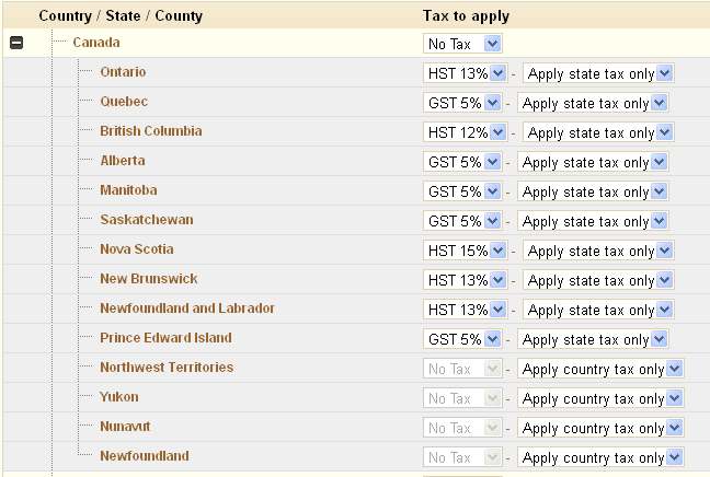

Carl Favre Posted December 6, 2011 Share Posted December 6, 2011 I have just installed again PrestaShop with Canada as main country and it works fine here. See below my 2 screenshots. Could you also attach pictures of what you have in taxes/tax rules ? Link to comment Share on other sites More sharing options...

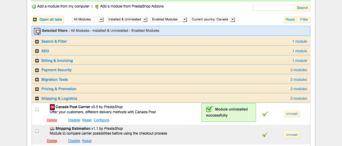

BadgerDog Posted December 6, 2011 Author Share Posted December 6, 2011 Thanks Carl.... I think I fixed it with a reload .... I can see the Canada Tax rates now on subsequent pages .... By the way, is there a bug in modules? On a LOT of modules, I choose configure and edit changes, updating it. However, if I go back and want to configure them some more, I click configure and the screen flashes, but it just returns to the module view. I have to RESET the module, then re-enter everything all over again just to get into it? The Canada Post add-on module installed won't let me configure it at all, even using the reset button. Am I missing something? Regards, Doug Link to comment Share on other sites More sharing options...
Sabrina Maréchal Posted December 6, 2011 Share Posted December 6, 2011 Hi Doug, Thank you for your message! I'll ask to Fabien, who developed the CanadaPost module to have a look at it. Being the Country Manager for Canada, I'd be very happy to get your feedback while you configure and setup your shop. Getting taxes perfectly working for Canada has been one of our priorities for PS V1.4.6, my mission is to listen to our Canadian community to continue to improve our software! Wish you success with your store, Sabrina Link to comment Share on other sites More sharing options...

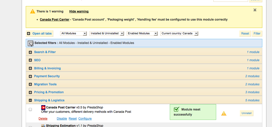

BadgerDog Posted December 6, 2011 Author Share Posted December 6, 2011 Thanks Sabrina .... There's something wrong with module management in general. Clicking on configure doesn't work for many modules unless you RESET them to the default status first. In the Canada Post module, one can't even get into configuration option and it (as do many) shows a successful "un-install" (green box), even though the module is installed and active (see check mark) and also the text indicating the only option is to uninstall it. Regards, Doug ---- Link to comment Share on other sites More sharing options...
Fabien Serny Posted December 6, 2011 Share Posted December 6, 2011 Hi BadgerDog, I'm the developer in charge of the Canada Post module. Your problem does not seems to be relative with the module itself. Did you enable memcache or filesystem cache ? Could you send me a back office and a ftp access by private message to look what is going wrong on your shop ? Best regards, Link to comment Share on other sites More sharing options...
BadgerDog Posted December 7, 2011 Author Share Posted December 7, 2011 Thanks Fabien ... I turned OFF the CacheFS system altogether and that fixed the problem. I also note that it also fixed ALL of the other module "configure" issues as well. Thanks for your help ... I'm still working my way through trying to understand the best way to configure our store, hopefully bringing it on-line in the new year. I need to find a good template theme that best mates with our primary vBulletin based military antique collector's site, so that's my next adventure with PrestaShop. Regards, Doug Link to comment Share on other sites More sharing options...

sbordun Posted December 7, 2011 Share Posted December 7, 2011 correct. Also I would suggest do not use predefined Canadian Taxes, because if the customer is not logged in, the system always calculates the Sales Tax as Canadian GST 5%. I do not want my customers see the Sales tax unless they logged in and system knows the correct shipping destination. Sample of my taxes: Once you start testing the Shipping Cart, could you share with me if you experience the same problem as me? I described the problem here (post #11): http://www.prestashop.com/forums/index.php?/topic/145262-canada-post-shipping-module-5-seconds-delay/page__view__findpost__p__698863 Regards, Sergei Link to comment Share on other sites More sharing options...

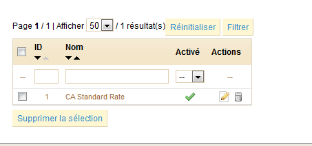

FreshElement Posted June 4, 2013 Share Posted June 4, 2013 I did re-install 1.4.10.0, selecting Canada as the country. That gave me the correct tax setup... to an extent! I've still got several tax-related issues: The "Tax to apply" rules are not all correctly set for each State/Region. Some are, some aren't. And since I don't know what they should be for each State, I'll have to depend on the client for that. The client told me that Canada taxes shipping as well. So I made sure to set "Tax" to "CA Standard Rate" for each carrier (there are 2 carriers setup, both are Canada Post, one is Regular, the other is Expedited). However, the tax is NOT being added to the shipping, only to the product price. I cannot find the "Display tax on cart" switch that the documentation says should be under "Tax options". I need to turn off the display of taxes in the shopping cart until the customer enters a destination. When the customer checks out, they are presented with the 2 carriers. However, regardless of the destination, both the Regular and Expedited option show the exact same shipping cost! If anyone has ANY suggestions, either on the tax issue OR the Canada Post issue, I'm open and would be grateful. This client has been waiting almost 6 months to launch his Canadian store. Thanks, in advance... Clem Link to comment Share on other sites More sharing options...

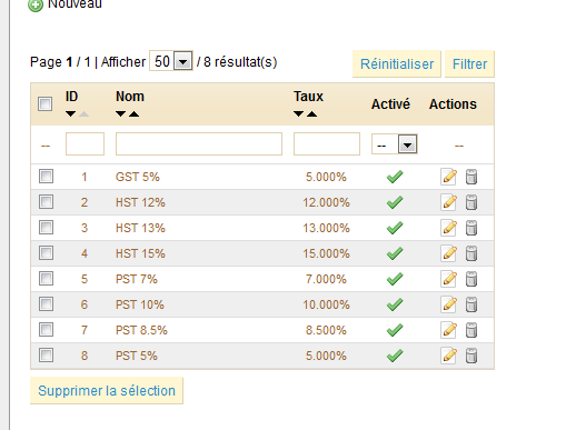

cedricfontaine Posted August 8, 2013 Share Posted August 8, 2013 If you are in Quebec, here is the tax configuration : http://www.spidmail.net/2013/04/06/2-changements-de-taxes-au-canada/ Link to comment Share on other sites More sharing options...
