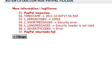

Hi Fabien,
Since I installed Paypal API to counter the problem with redirects, some of my customers are getting "Invalid Token" error while trying to make a payment. I reproduced the error and have attached a screenshot.
Can you help?
I have prestashop 1.3.5.0 and Paypal API v1.0.
Apparently, this is not a bug, PayPal has a time limit for the token and it may be or issue.
The last version of the module give more details about the problem (when there is one).

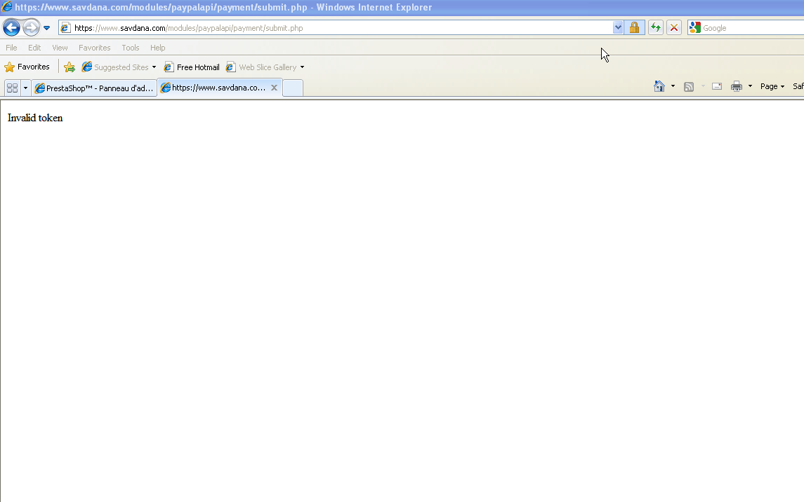

Hi Fabien,
Since I installed Paypal API module as a solution to the phishing attack message that google was sending, I have been getting many emails about PayPal API module error. Can you please tell me what is going on?
I am using prestashop 1.3.5.0 and 1.3.1.1 on both my sites with PayPal API v1.0 module.
Here's one of the error messages:
Un client a rencontré un problème avec le module PayPalAPI: Ouvre une nouvelle connection vers 'api-3t.paypal.com/nvp'
Connection réussie avec la méthode cURL
Envoie des paramètres :
METHOD=DoExpressCheckoutPayment&VERSION=53.0&PWD=*********&USER=pradnie_api1.hotmail.com&SIGNATURE=*********&TOKEN=EC-6KM41300F05046120&PAYERID=SX248H7TKXHG2&PAYMENTACTION=Sale&AMT=13.99&CURRENCYCODE=EUR&IPADDRESS=www.savdana.com&NOTIFYURL=http%3A%2F%2Fwww.savdana.com%2Fmodules%2Fpaypalapi%2Fipn.php&BUTTONSOURCE=PRESTASHOP_ECM&SHIPTONAME=+martin+m%C3%A9lanie&SHIPTOSTREET=16+parc+du+cailly+appartement+242&SHIPTOCITY=mont+saint+aignan&SHIPTOSTATE=&SHIPTOCOUNTRYCODE=FR&SHIPTOZIP=76130
Envoie réussi avec la méthode cURL
Réponse PayPal :
TIMESTAMP -> 2011-10-27T10:09:54Z
CORRELATIONID -> 882b1d13269a4
ACK -> Failure
VERSION -> 53.0
BUILD -> 2183220
L_ERRORCODE0 -> 10417
L_SHORTMESSAGE0 -> Transaction cannot complete.
L_LONGMESSAGE0 -> The transaction cannot complete successfully. Instruct the customer to use an alternative payment method.

Hi.
I am getting the exact same error. The paypal module has had numerous updates since this thread was published. I have contacted Google and requested a new crawl, but no cigar!
Is there any news about this error?
Best regards,
Gorm.
