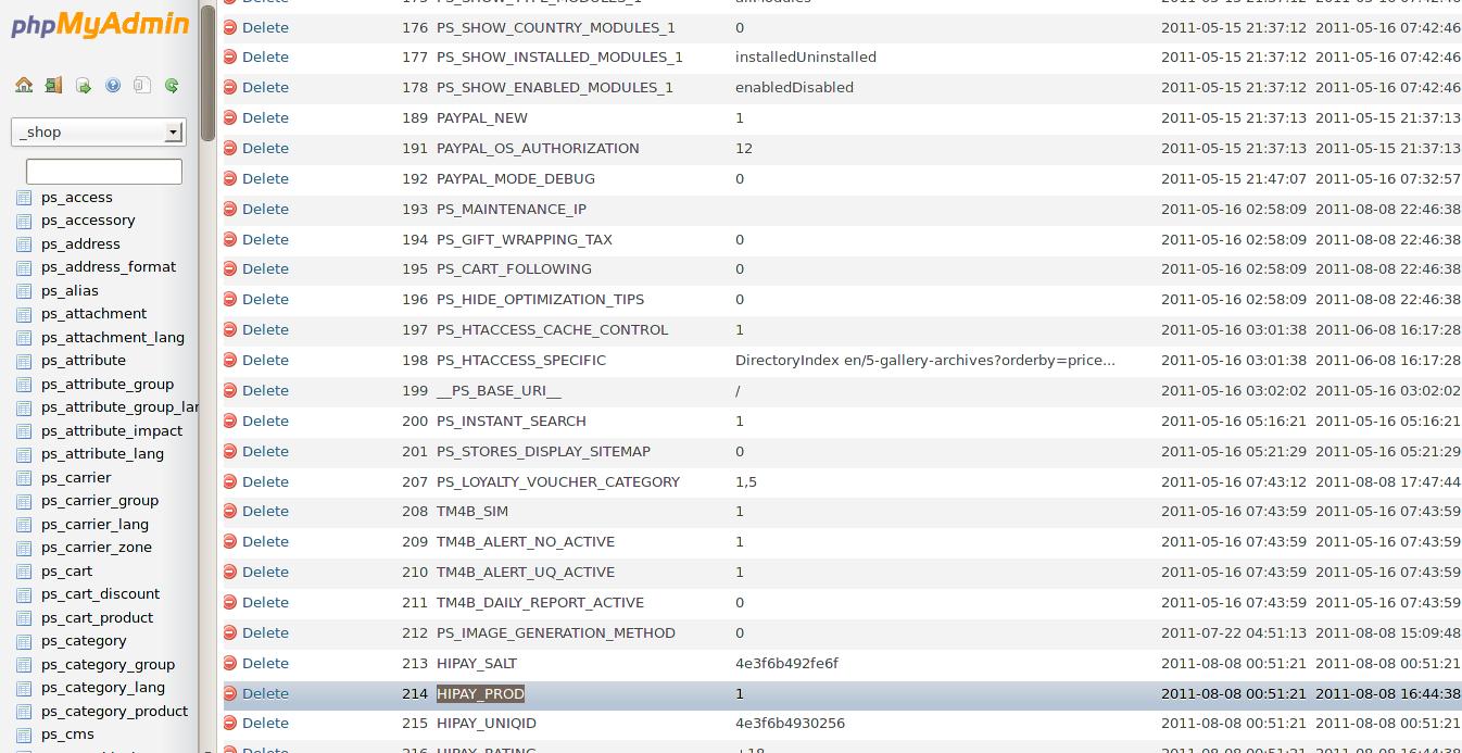

So basically, the simple fix is to open your prestashop database, select the ps_configuration table, and find the row with the name "HIPAY_PROD"
For me, the value field was completely blank. You need to change the value field to "1"
If you're using phpMyAdmin, you may need to delete the row, the re-insert it using the same information (excluding the value field).
So afterwards it should look something like this:
This fixed the module for me too, thanks! I can confirm that Hipay is now working and receiving payment.

After 3 days of persistence, I believe I've finally gotten the module working.
It turns out it was indeed a fault of the module itself.
Thanks to the help of affect on the #prestashop IRC channel via Freenode.
Here's a copy of our IRC conversation, since I don't think I could really properly format the entire issue here:
Spoiler
This is working i had done this with version 1.1 i think that someone need to upload this fixed module that there is no need for php thank you man!!!
