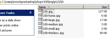

I have not test the same scenario, based on the information you provided I guess it is a bug.
you can check if it is already reported in bug tracker, if it is not there you can report it.
the latest version 1.4.4 is just released, you can also check if it is fixed in this version.

I think the issue was cased by this:
If the image number is 100, the path for the 100.jpg will be your_shop/img/p/1/1/0/100.jpg, however, the path was not created. I have checked my path, after "p" folder, it only has 2 leaves that is /1/1/ that's all.

I just tried to reproduce the problem you mentioned.
I did get an error one it reached 100 images.
but just one time error, when tried it again, it created the images without problem.
I guess the first time error is because the folder is not ready yet, after that, it works fine.

have you tried to create the folder manually then redo the upload to see if it works?
I still think it could be some issue the permission of folders.
And are you using Windows platform or Linux? is there any folder path depth problem?

Thanks. Yes, you are right. It's a permission issue. The folders were not rithtable. changed thier permission and it works. thank you!
