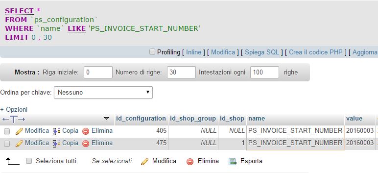

I met this issue on PS 1.5.4 and my solution was to delete PS_INVOICE_START_NUMBER from table ps_configuration because this was there two times.
I thought that was an error too but It seem to relate with multistore function: it would have 2 tables, one for each store.
I solved this error changing the Id_shop number for 1 (in my case) instead "null" in one of the PS_INVOICE_START_NUMBER
Cheers!
