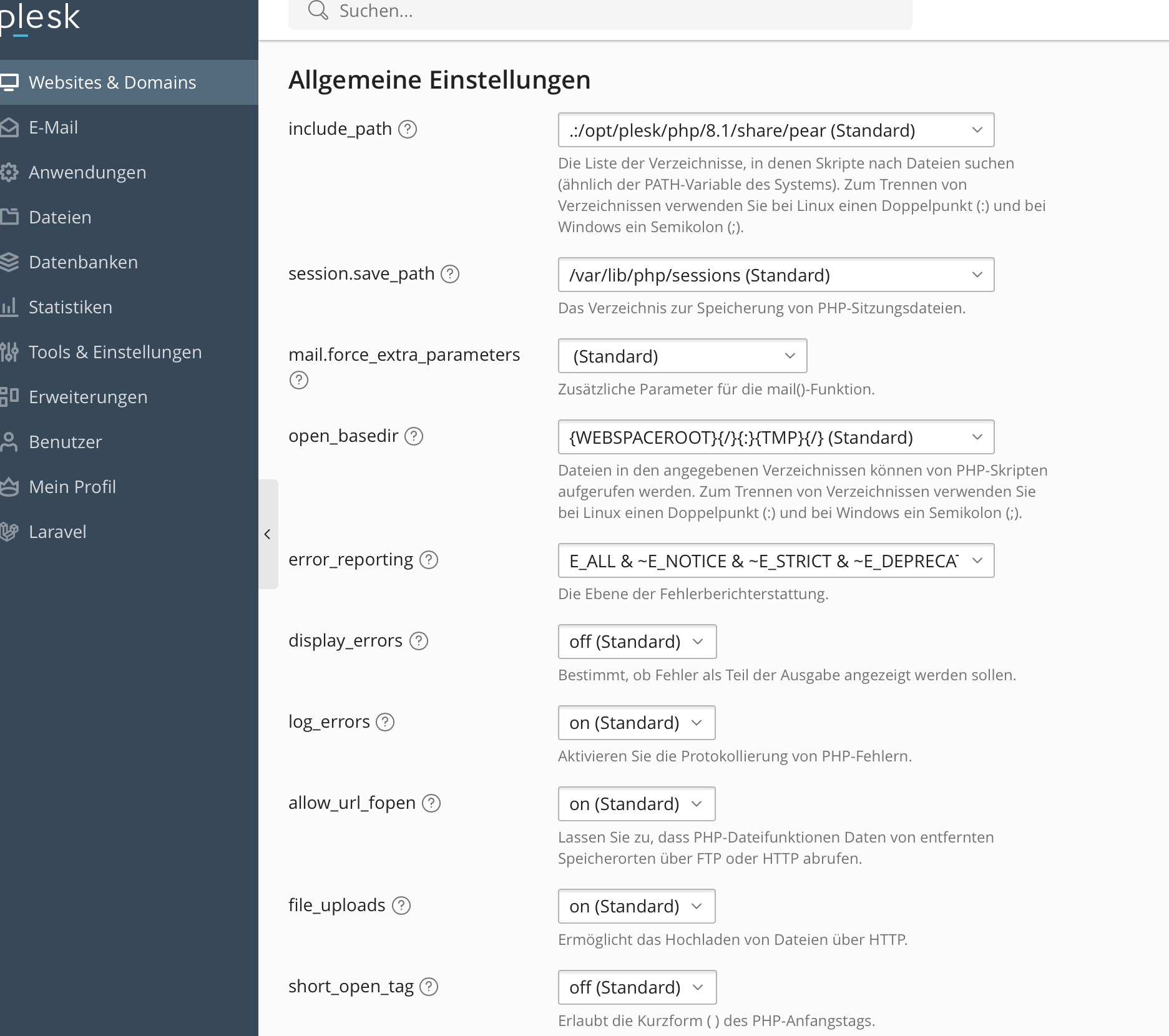

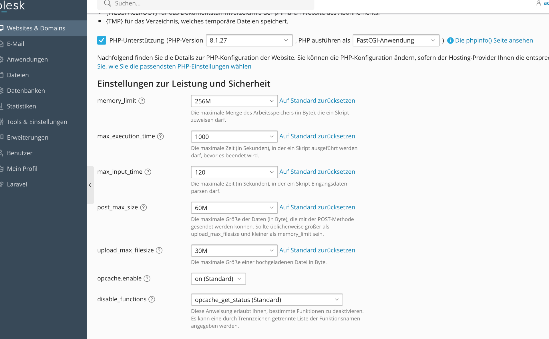

Selma Posted February 9 Author Share Posted February 9 Hallo Dirk, hier die php Einstellungen in plesk Link to comment Share on other sites More sharing options...
