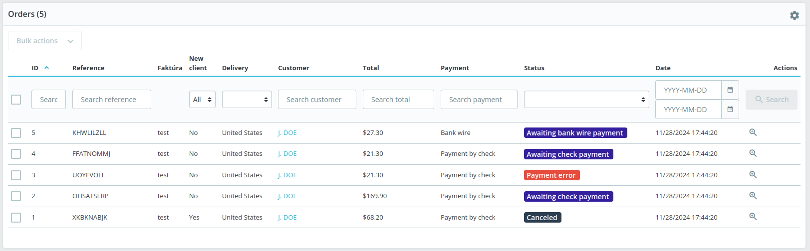

Andrei H Posted November 30 Share Posted November 30 (edited) Hello, I just had a look over the provided module. The problem seems to be the fact that you are not storing the .twig file in the correct location. Moving the .twig file to /modules/fadoorders/views/PrestaShop/Admin/Common/Grid/Columns/Content/custom_html.html.twig should fix your error (I haven't tested but this is most likely case sensitive too), as highlighted in the official documentation I have not tried with your specific .twig file, but creating one with the following code: <div>test</div> outputs the result as in my screenshot. Please let me know if you have any additional queries and I'll try and see if I can help. Edited November 30 by Andrei H Change customhtml to custom_html to match the provided name (see edit history) 1 Link to comment Share on other sites More sharing options...
beshop Posted November 30 Author Share Posted November 30 I tried moving it, but it still doesn't work. I don't understand why. 🤕 Could you please send me the module? Big thanks Link to comment Share on other sites More sharing options...
Andrei H Posted November 30 Share Posted November 30 Hello, Sure thing. I attached it. I actually edited the above message, but the file name must be custom_html.html.twig I also had to comment the line 67 as that was throwing an error. You most likely edited your orders table to have one more column, that's why you do not get that error. fadoorders.zip 1 Link to comment Share on other sites More sharing options...
beshop Posted November 30 Author Share Posted November 30 big thanks.. 1 Link to comment Share on other sites More sharing options...
