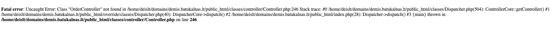

PushyMr Posted October 30, 2024 Share Posted October 30, 2024 Hello, after updating my prestashop from 1.7.8.2 to 8.1.2 with one click upgrade I encountered a lot of issues HOWEVER the biggest one is - my checkout is not working. After an order summary when i press button to proccess to checkout process i get this error I cannot seem to find any relevant information in my logs and etc, furthermore, based on my controllers - I assume this would be the one used for checkouts controllers/front/OrderController.php it does not have an override and the only override controllers for front that i have are - override/controllers/front/CartController.php override/controllers/front/ProductController.php this a crucial issue for me, because we are about to upgrade our main server to be on prestashop 8.1.2 and we would loose a lot of business if I cannot fix this. I've been struggling for 2 weeks to solve this issue, with no success, anyone has any insight? Link to comment Share on other sites More sharing options...

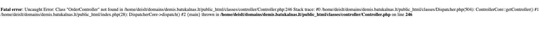

PushyMr Posted November 6, 2024 Author Share Posted November 6, 2024 after renaming and turning off the module i get still the same error but now its Link to comment Share on other sites More sharing options...

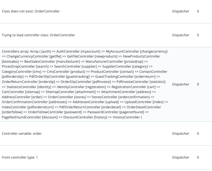

PushyMr Posted November 21, 2024 Author Share Posted November 21, 2024 okay small update, i did some logging inside dispathcer and i noticed this I am baffled that when the classes in dispatcher are printed out on what controllers are found in controllers/front i can see the OrderController HOWEVER it doesn't get picked up when it tries to be called. These are my declarations for it class OrderControllerCore extends FrontController which should be fine, there are no overrides for it or anything, also when i checked in cache inside class_index.php i see that it was declared 'OrderControllerCore' => array ( 'path' => 'controllers/front/OrderController.php', 'type' => 'class', ) I'm completely lost on why it is not getting picked up, could it be that autoload was screwed up during the update? This is the only controller so far that doesn't work. Also since i updated from 1.7.8.2 to 8.1.2 i do get a lot of warning about deprecated code. Also my code is PHP 8.1 Link to comment Share on other sites More sharing options...
