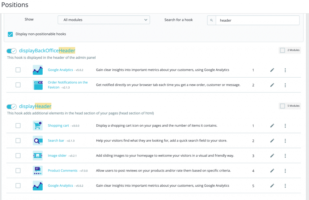

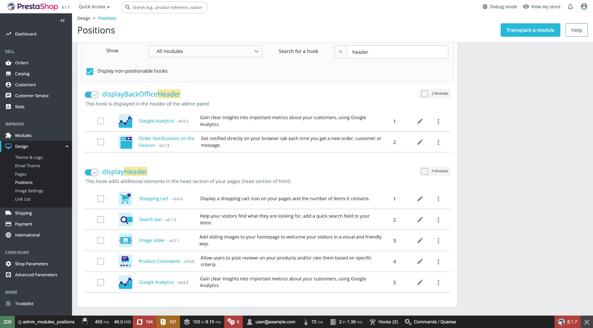

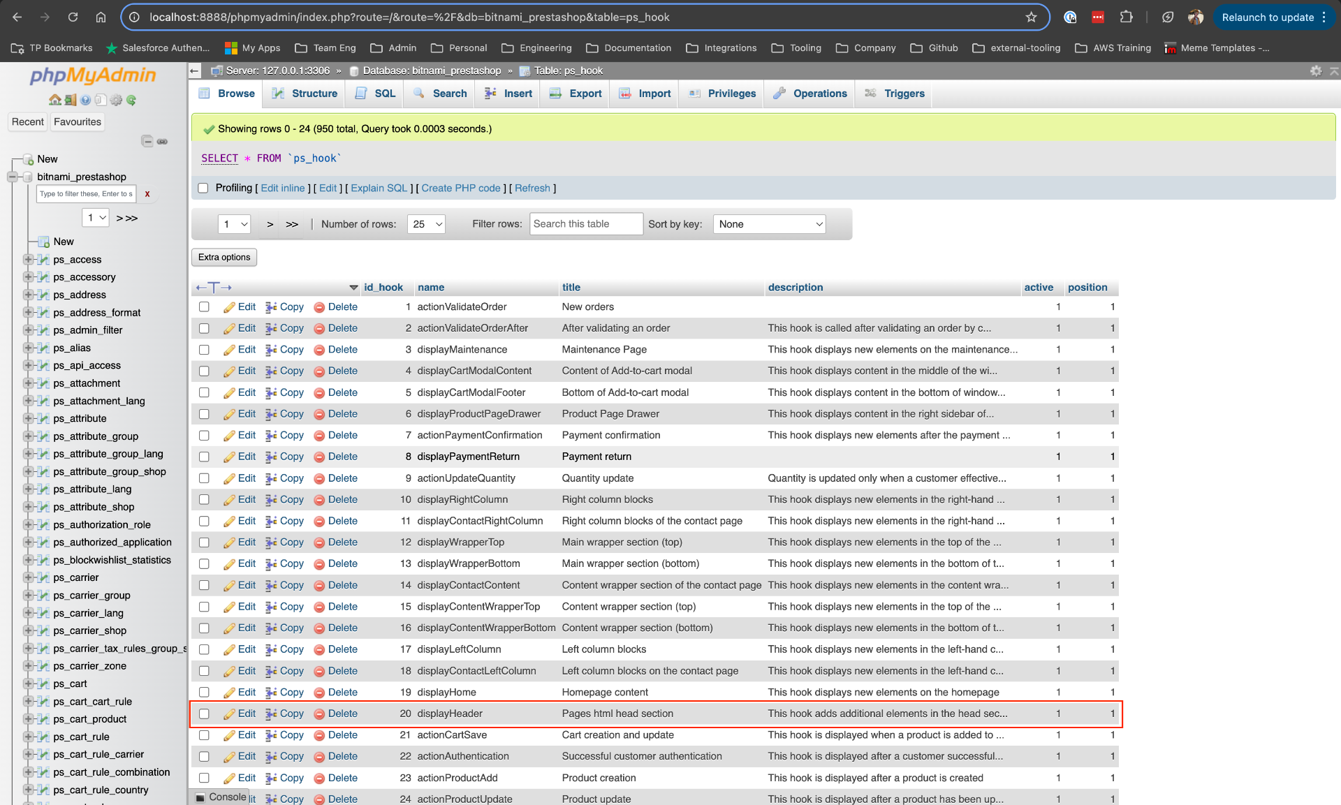

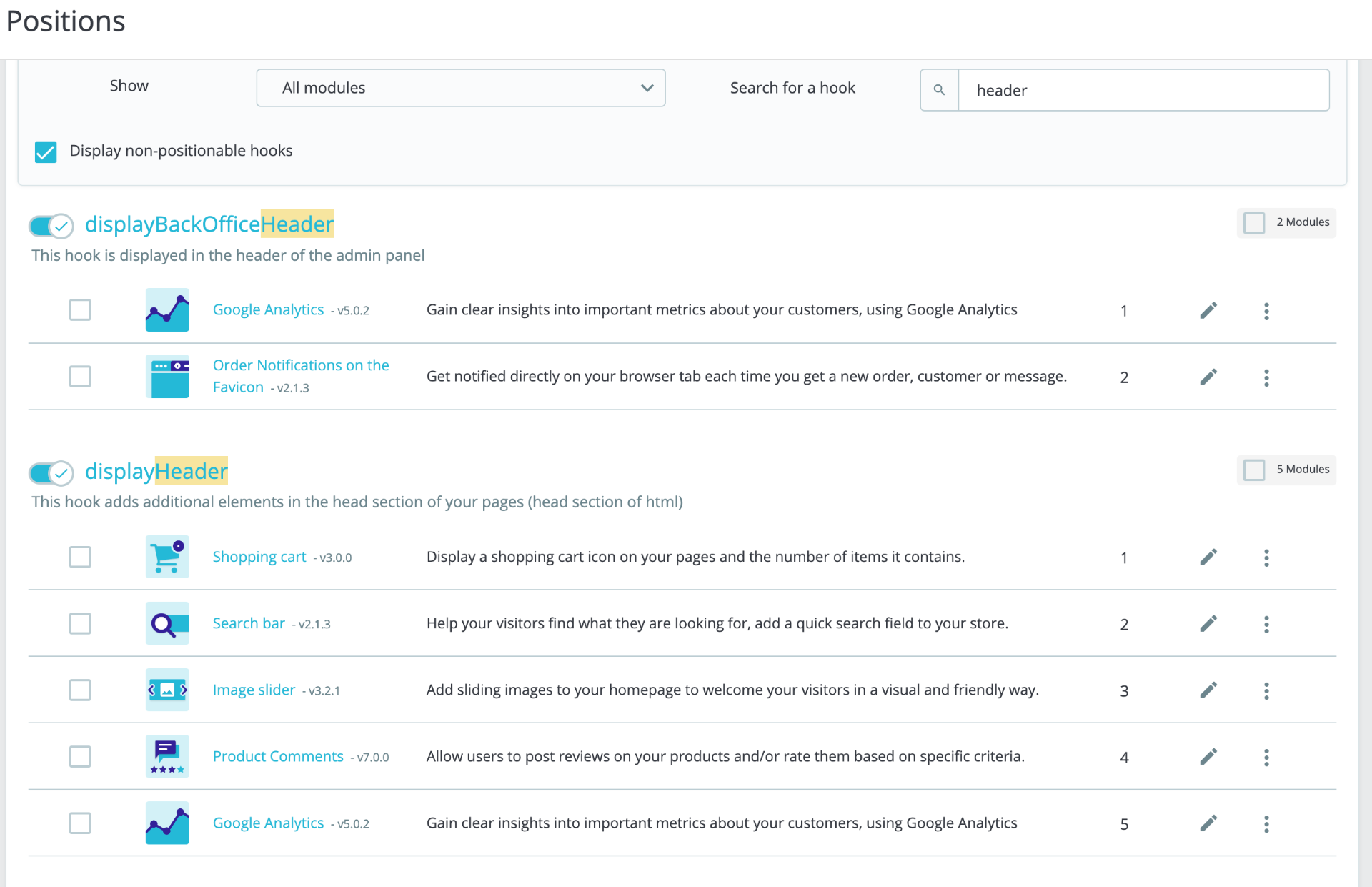

I do see the hook in the db when searching through the `ps_hook` table.
I also see the `displayHeader` in the positions tab on PrestaShop as well, which I assume is a good thing.
