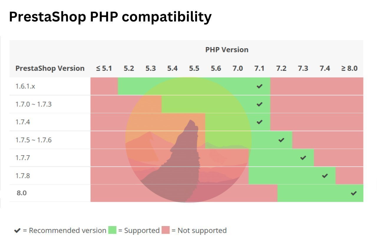

Divine Posted September 12, 2024 Share Posted September 12, 2024 (edited) Voici le tableau de compatibilité Prestashop / PHP : Edited September 12, 2024 by Divine Versions PS incomplètes (see edit history) Link to comment Share on other sites More sharing options...
Divine Posted September 12, 2024 Share Posted September 12, 2024 il y a 5 minutes, fabweb59 a dit : Dons avec presta 1.6 on peut tourner avec un PHP 7 ? merci Avec une version 1.6.1.x, oui tout à fait. Link to comment Share on other sites More sharing options...

Eolia Posted September 12, 2024 Share Posted September 12, 2024 il y a une heure, Divine a dit : Avec une version 1.6.1.x, oui tout à fait. Nope, uniquement à partir des 1.6.1.21 et encore il reste des morceaux non compatibles (mais qui font des erreurs silencieuses). Link to comment Share on other sites More sharing options...

Eolia Posted September 12, 2024 Share Posted September 12, 2024 https://github.com/PrestaShop/PrestaShop-1.6/pull/4 la version .25 proposait les correctifs pour être compatible réellement PHP7 Citation 1.6.1.25 (2019-08-26) classes/AdminTab.php line 511 change "$function($value)" classes/AdminTab.php line 530 change "$function($value)" classes/AdminTab.php line 1675 change "create_function" classes/Cart.php line 2772 add control "is_array" classes/Cookie.php line 79 change "else" and add 2 constants OPENSSL_KEY and OPENSSL_IV Mcrypt disappears. I had Warning issues with existing keys that are not good for Openssl. So I added two new constants with the correctly generated keys. classes/ImageType.php line 173 change "if" classes/ObjectModel.php line 64 change "type of variable" classes/Rijndael.php line 97 delete constant "MCRYPT_RIJNDAEL_128" it's not exists classes/Tools.php line 2151 change "create_function" classes/Tools.php line 3736 change "create_function" classes/controller/AdminController.php line 549 change "paramaters" for function "initBreadcrumbs" classes/controller/AdminController.php line 2329 change "if" classes/controller/AdminController.php line 3467 change "$function($value)" classes/controller/AdminController.php line 3469 change "$function($value)" classes/helper/HelperList.php line 198 change "create_function" classes/module/Module.php line 1554 change "create_function" classes/stock/SupplyOrderDetail.php line 304 change "$function($value)" controllers/admin/AdminAttributeGeneratorController.php line 79 change "create_function" controllers/admin/AdminOrdersController.php line 589 change "$function" controllers/admin/AdminProductsController.php line 2221 change "$function" controllers/admin/AdminProductsController.php line 2224 change "$function" controllers/admin/AdminProductsController.php line 2240 change "$function" controllers/front/ProductController.php line 254 add controle "is_array" install-dev/fixtures/fashion/data/generate_attribute.php line 203 change "create_function" install-dev/upgrade/upgrade.php line 258 add constants OPENSSL_KEY and OPENSSL_IV install-dev/models/install.php line 93 add create constants OPENSSL_KEY and OPENSSL_IV tools/profiling/Controller.php line 358 change "create_function" tools/smarty/sysplugins/smarty_internet_compilebase.php rewrite function "getAttributes" for delete function "each" the smarty update was too much change, so I decided to redo one of the functions so that it would be compatible. I had no mistakes after this correction admin-dev/themes/default/template/controllers/modules/js.tpl line 37 change "count" to "is_array" Link to comment Share on other sites More sharing options...
