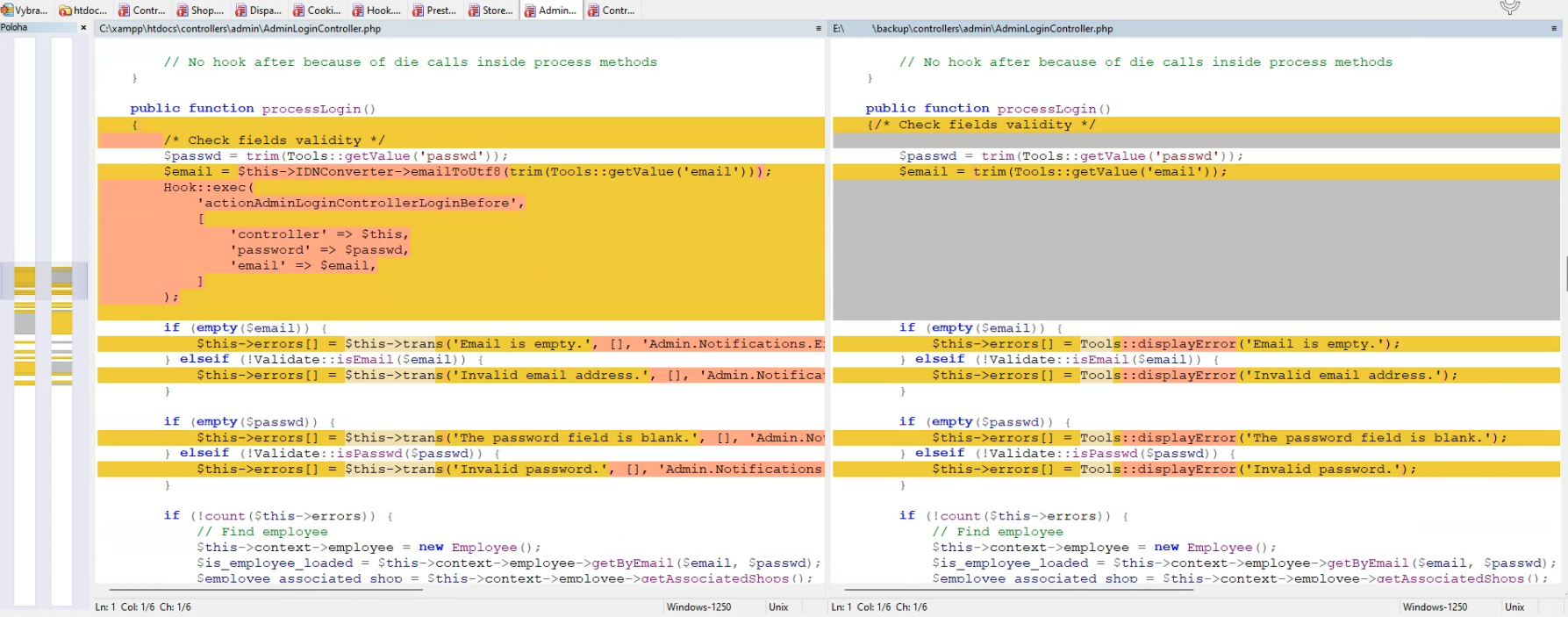

Haluska Posted August 29, 2024 Share Posted August 29, 2024 Hello, i have this weird problem. After updating from 1.7.5.1 to 1.7.8.11 everything worked fine. For a few days. Now all of a sudden, out of the blue, if I try to log into the backoffice, after entering the correct email and password, it redirects me back to the login. If I enter the login incorrectly, the form disappears and my console lists it: Desktop mode: "Failed to load resource: the server responded with a status of 500 ()" Mobile mode: POST admin/index.php?rand=xxxxxx 500 (Internal Server Error) I have the permissions of all files and folders at 755 and 644. I tried deleting cookies, anonymous mode. Everything is OK on the local server in XAMMP. The hosting provider said they didn't change anything. After bad login: Thank you in advance for any tips Link to comment Share on other sites More sharing options...

Haluska Posted August 29, 2024 Author Share Posted August 29, 2024 Solved, eshop was attacked by hackers. Now i have "fun" for longer. This rats are realy annoying. Link to comment Share on other sites More sharing options...
