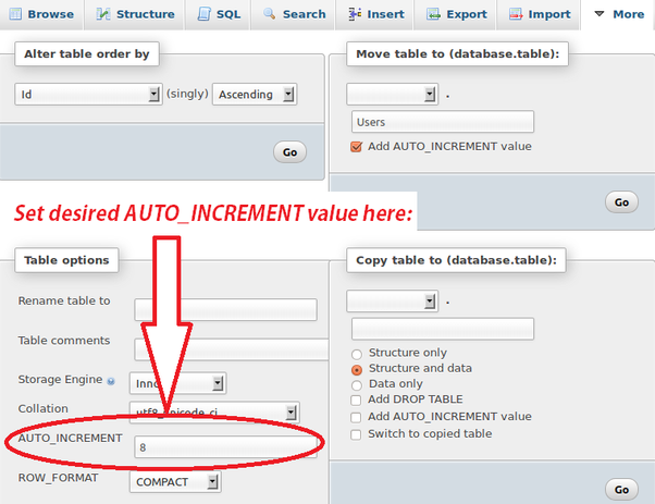

luisleitaoaudio Posted August 22 Share Posted August 22 Link to comment Share on other sites More sharing options...
luisleitaoaudio Posted August 22 Share Posted August 22 You NOT need remove! Link to comment Share on other sites More sharing options...
Maxflor Posted August 22 Author Share Posted August 22 please is this the setting in the ps_image table? Link to comment Share on other sites More sharing options...
luisleitaoaudio Posted August 22 Share Posted August 22 (edited) yes put value 100 000 or quantitie of rows + 1 for example if table have 10 000 you put 10 001 if work please let me know! Edited August 22 by luisleitaoaudio (see edit history) Link to comment Share on other sites More sharing options...
luisleitaoaudio Posted August 22 Share Posted August 22 This fix problem? Link to comment Share on other sites More sharing options...
