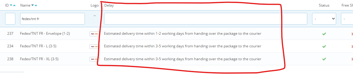

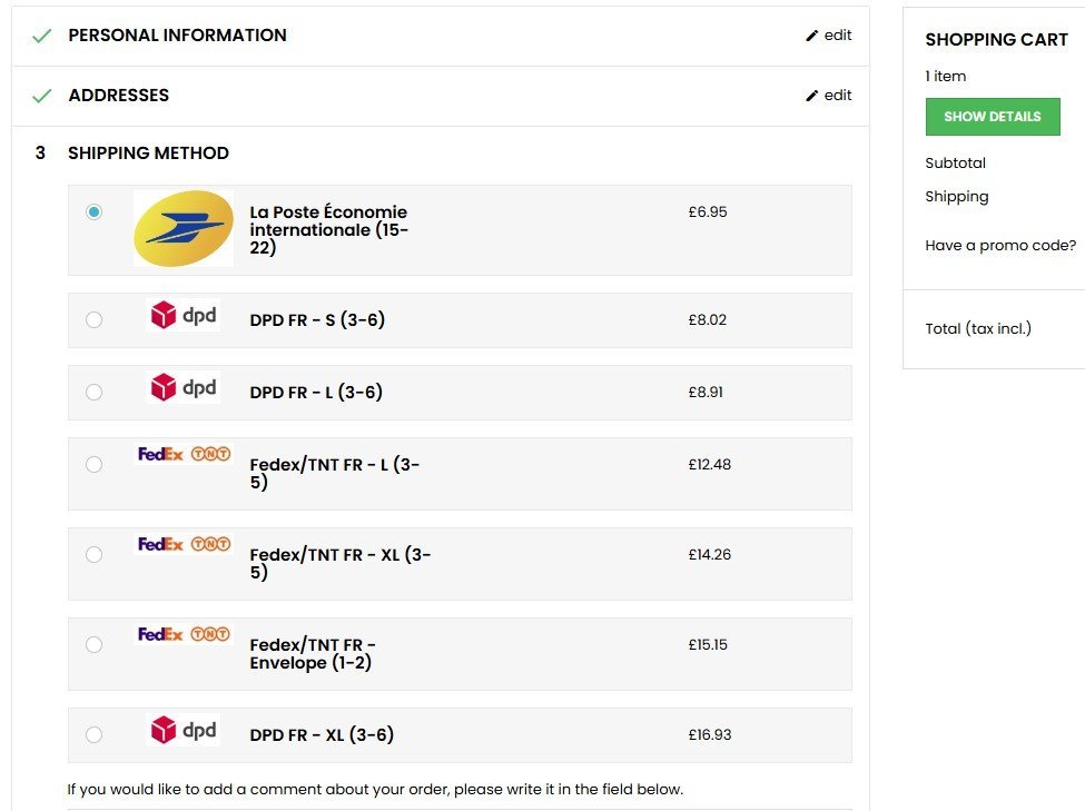

nestor44 Posted June 7, 2024 Share Posted June 7, 2024 (edited) Hi, Recently I have noticed that the shipping methods in the checkout are shown without transit time (delay) that I described for each shipping method in the Shipping -> Carriers. I do not know when these information disappeared and what cause that. Does anyone know how to bring them back? Edited June 13, 2024 by banan_44 (see edit history) Link to comment Share on other sites More sharing options...

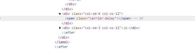

Prestashop Addict Posted June 10, 2024 Share Posted June 10, 2024 Verify in your html source (inspector browser) if htaml part is present but maybe not visible. In this case it's a css issue, otherwise theme template issue. Link to comment Share on other sites More sharing options...

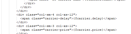

nestor44 Posted June 11, 2024 Author Share Posted June 11, 2024 (edited) On 6/10/2024 at 10:18 AM, Prestashop Addict said: Verify in your html source (inspector browser) if htaml part is present but maybe not visible. In this case it's a css issue, otherwise theme template issue. Thank you for your reply. I have just checked that. In the source there is no carrier delay: But when I checked checkout\_partials\steps\shipping.tpl this field should insert information from {$carrier.delay}. Now I am a little bit confused why my Presta doe snot insert anything into {$carrier.delay}. Any advice where I should check that? Is it something that I'll find in other tpl file or should I look elsewhere? BTW. I am also using Knowband Supercheckout and it also does not show me carrier delay while I know that there was such information. To write this topic I have deactivated Supercheckout to verify if this delay problem was a problem with the module or with Presta. Edited June 11, 2024 by banan_44 (see edit history) Link to comment Share on other sites More sharing options...
nestor44 Posted June 12, 2024 Author Share Posted June 12, 2024 On 6/10/2024 at 10:18 AM, Prestashop Addict said: Verify in your html source (inspector browser) if htaml part is present but maybe not visible. In this case it's a css issue, otherwise theme template issue. Thank you for your reply. I have just checked that. In the source there is no carrier delay: But when I checked checkout\_partials\steps\shipping.tpl this field should insert information from {$carrier.delay}. Now I am a little bit confused why my Presta doe snot insert anything into {$carrier.delay}. Any advice where I should check that? Is it something that I'll find in other tpl file or should I look elsewhere? EDIT I have just instaled afresh Presta and installed my theme. The carrier delay is shown on the test Presta while on my working shop ther eis not information. I think this is not a problem with the theme. Link to comment Share on other sites More sharing options...
