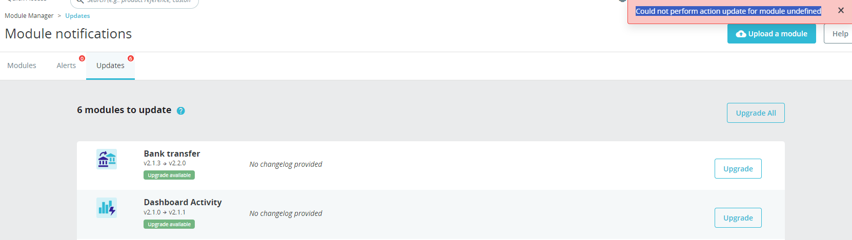

jinojames Posted June 7, 2024 Share Posted June 7, 2024 Hello All, I am getting the following error while opening translations tab in my back end Warning: file_get_contents(): http:// wrapper is disabled in the server configuration by allow_url_fopen=0 But in my php editor it's enabled. allow_url_fopen = On Why then it's showing this error ? And I also face trouble in updating my modules, It shows error Could not perform action update for module undefined attaching the screenshot for the same. Link to comment Share on other sites More sharing options...
