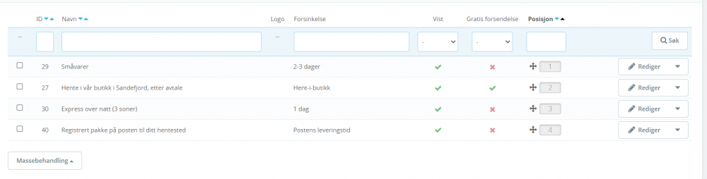

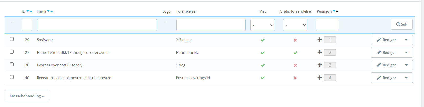

My Prestashop installation has worked fine for a long time until I now wanted to add a new transportation offer for my customers.

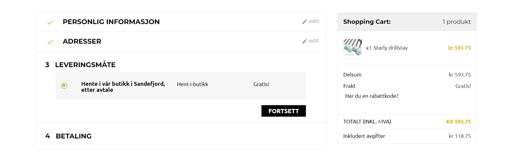

I can add the transportation, in excactly the same way as those which already is added but the new transportation is not available when customers go to check-out.  Only the old options are visible.

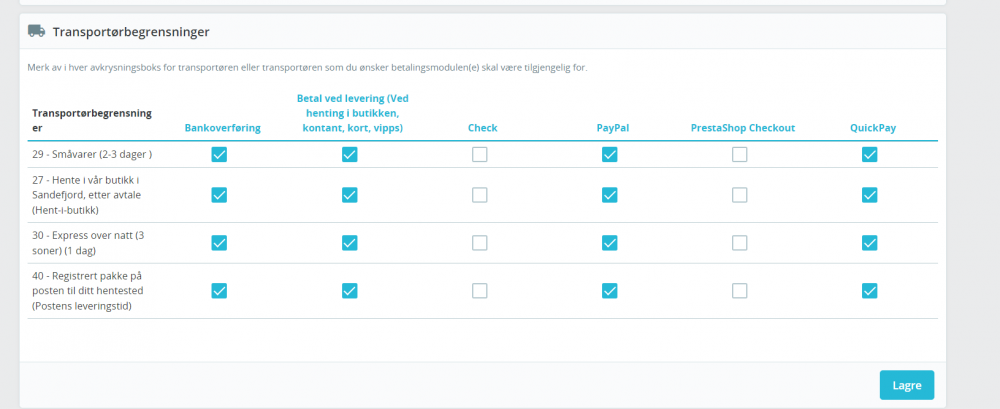

I have checked the country zone and compared the settings to the old transportation options and as far as I can see they are the same.
