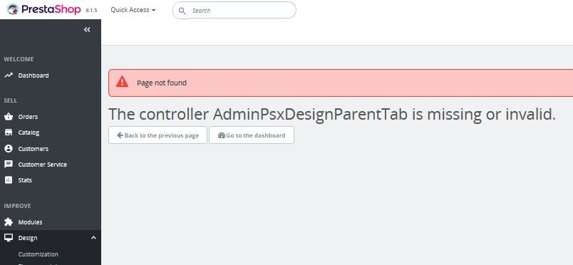

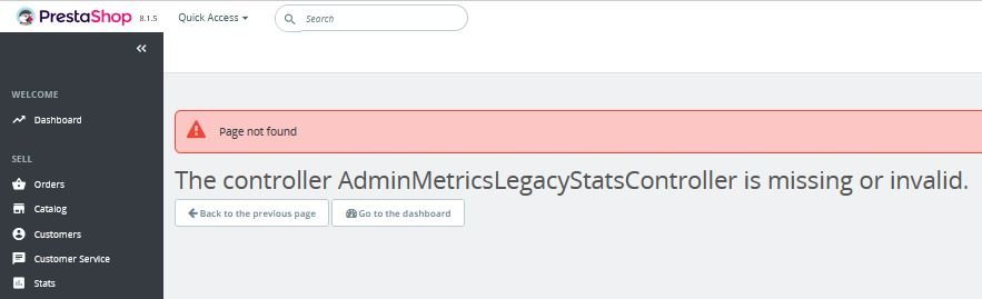

bksmartit Posted May 31 Share Posted May 31 (edited) Hello Everyone, I have installed from scratch PrestaShop v8.1.3 and then later I noticed there is PrestaShop v8.1.5 so I decided to upgrading using "1-Click Upgrade". Upgrade was successful with no error according during the process. However, when I checked the system I noticed missing Controllers? 1. So when I click Stats \ Stats or PrestaShop Metric I have message: "Page not found" and error: "The controller AdminMetricsLegacyStatsController is missing or invalid." 2. Also, when I click Design \ Customization I have message: "Page not found" and error: "The controller AdminPsxDesignParentTab is missing or invalid." No sure how to fix these issues? p.s. I see there is minor upgrade available v.8.1.6 but I don't want to upgrade until I fix missing Controllers. Please help. Thank you very much Edited June 2 by bksmartit (see edit history) Link to comment Share on other sites More sharing options...
endriu107 Posted May 31 Share Posted May 31 This errors are from module PS Metrix and could be also from facebook module too. Reinstal those modules should fix problem. Link to comment Share on other sites More sharing options...

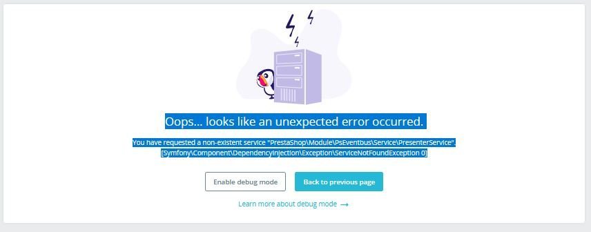

bksmartit Posted May 31 Author Share Posted May 31 endriu107, Thank you for your respond. Respond to Issue #1 I reinstalled those modules as you recommended. I am able to click Stats \ Stats (This link is working fine now) However, when I click click Stats \ PrestaShop Metrix I get different error this time now. Oops... looks like an unexpected error occurred. You have requested a non-existent service "PrestaShop\Module\PsEventbus\Service\PresenterService". [Symfony\Component\DependencyInjection\Exception\ServiceNotFoundException 0] Issue # 2 still there - unsolved. I click Design \ Customization I have message: "Page not found" and error: "The controller AdminPsxDesignParentTab is missing or invalid." Any adivce/help? Thank you Link to comment Share on other sites More sharing options...
bksmartit Posted May 31 Author Share Posted May 31 Update regarding on error #2 When click Design \ Customization I have message: "Page not found" and error: "The controller AdminPsxDesignParentTab is missing or invalid." Solution: Enable PrestaShop Design and PrestaShop Marketplace in your BackOffice in Modules Manager (by default were disabled) I am not sure why Themes Catalog has trouble connecting to Addons? Any one knows. Please share Thank you p.s Error #1 still unsolved Link to comment Share on other sites More sharing options...
bksmartit Posted May 31 Author Share Posted May 31 Update regarding on error #1 when click Stats \ Stats or PrestaShop Metrics I have message: "Page not found" and error: "The controller AdminMetricsLegacyStatsController is missing or invalid." Step tried: Uninstalled and reinstalled module: PrestaShop Metrics, the first error disapeared but this step generated new error: Oops... looks like an unexpected error occurred. You have requested a non-existent service "PrestaShop\Module\PsEventbus\Service\PresenterService". [Symfony\Component\DependencyInjection\Exception\ServiceNotFoundException 0] Solution to this error: PrestaShop Metrics also required the following Modules that need to be inabled: PrestaShop Accounts and PrestaShop Eventbus. Viola! it is working! Thank you 1 Link to comment Share on other sites More sharing options...

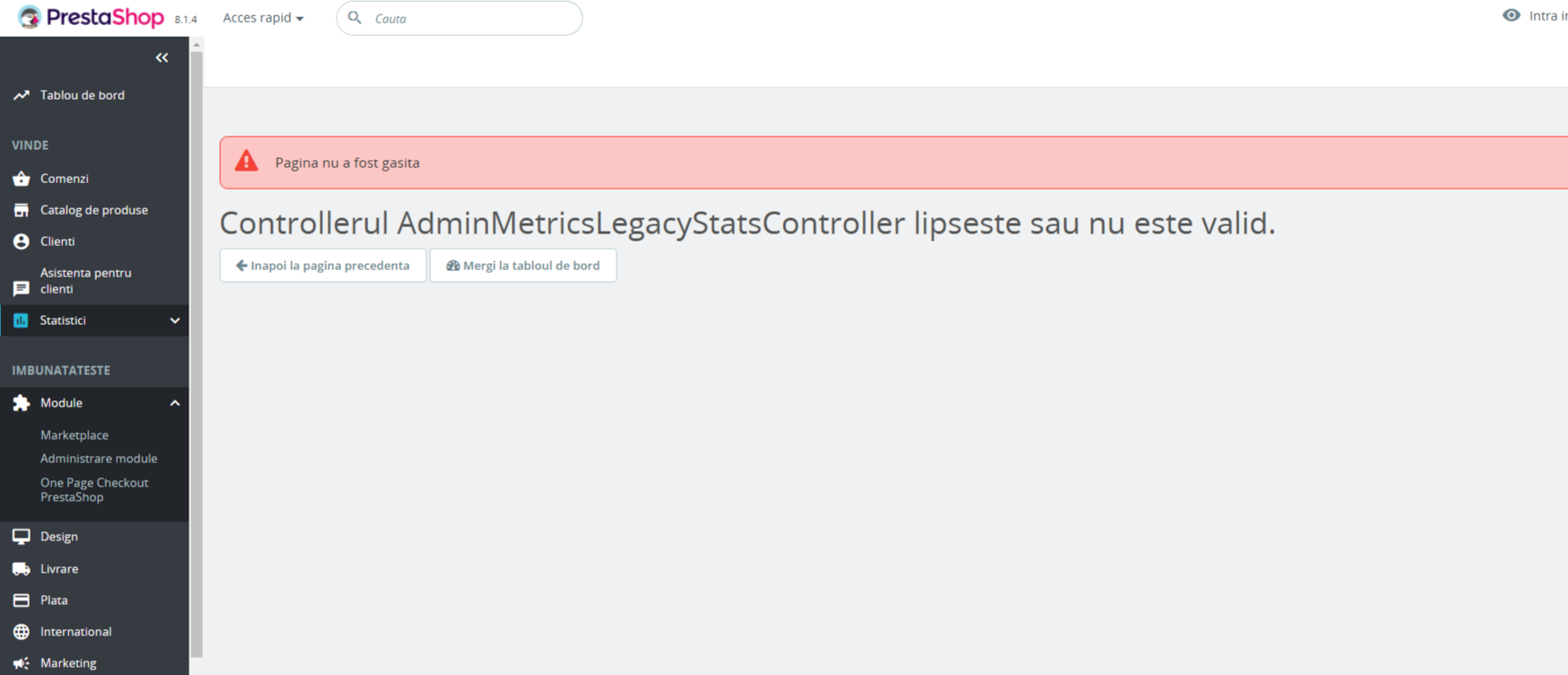

TamasFelix Posted September 6 Share Posted September 6 (edited) Hello, I have a similar problem on my fashionland.ro, the AdminMetricsLegacyStatsController is missing or invalid. 8.1.4 Edited September 6 by TamasFelix (see edit history) Link to comment Share on other sites More sharing options...
