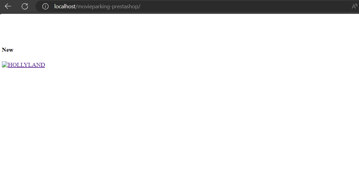

dwdsaq2 Posted April 27, 2024 Share Posted April 27, 2024 When I enter the site on my localhost, the style or design is not working and all images are not displayed. Link to comment Share on other sites More sharing options...

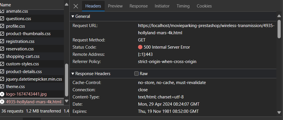

dwdsaq2 Posted April 30, 2024 Author Share Posted April 30, 2024 3 hours ago, JBW said: Did you re-generate .htaccess? Yes, and that fixed the styling error. However products are not showing even tho they are in the back office. I'm having error like this. Link to comment Share on other sites More sharing options...
JBW Posted April 30, 2024 Share Posted April 30, 2024 There is a 500 server error. Activate debug mode and check the details in the response tab/server log Link to comment Share on other sites More sharing options...
Knowband Plugins Posted April 30, 2024 Share Posted April 30, 2024 Hello, Please attempt clearing the cache as an initial step. Additionally, ensure that the paths to your CSS files and images are accurate within your PrestaShop theme. Paths may vary when running your site locally compared to hosting it online. PrestaShop relies on an .htaccess file to manage various server configurations, including URL rewriting. Confirm that the .htaccess file in your PrestaShop root directory is configured correctly. If the aforementioned steps do not resolve the issue, inspecting the browser console can provide insights into the root cause. This will enable a closer examination of the problem. Link to comment Share on other sites More sharing options...

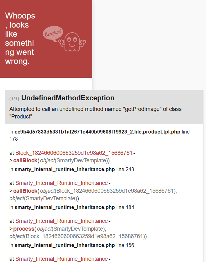

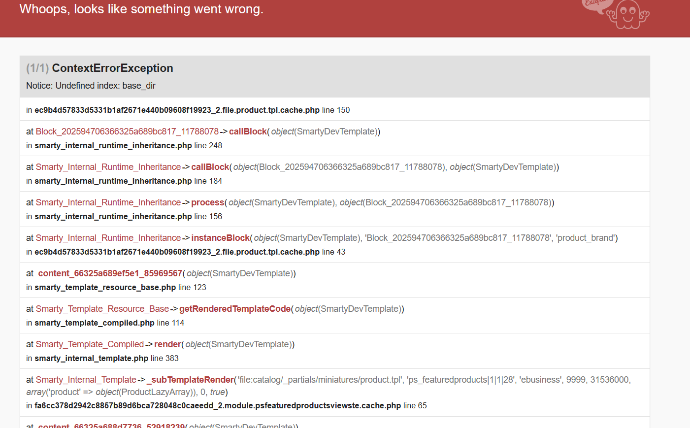

dwdsaq2 Posted May 1, 2024 Author Share Posted May 1, 2024 On 4/30/2024 at 9:08 PM, JBW said: There is a 500 server error. Activate debug mode and check the details in the response tab/server log I' Link to comment Share on other sites More sharing options...
dwdsaq2 Posted May 1, 2024 Author Share Posted May 1, 2024 On 4/30/2024 at 9:49 PM, Knowband Plugins said: Hello, Please attempt clearing the cache as an initial step. Additionally, ensure that the paths to your CSS files and images are accurate within your PrestaShop theme. Paths may vary when running your site locally compared to hosting it online. PrestaShop relies on an .htaccess file to manage various server configurations, including URL rewriting. Confirm that the .htaccess file in your PrestaShop root directory is configured correctly. If the aforementioned steps do not resolve the issue, inspecting the browser console can provide insights into the root cause. This will enable a closer examination of the problem. Hi, I have done all of that. I'm having this error Link to comment Share on other sites More sharing options...

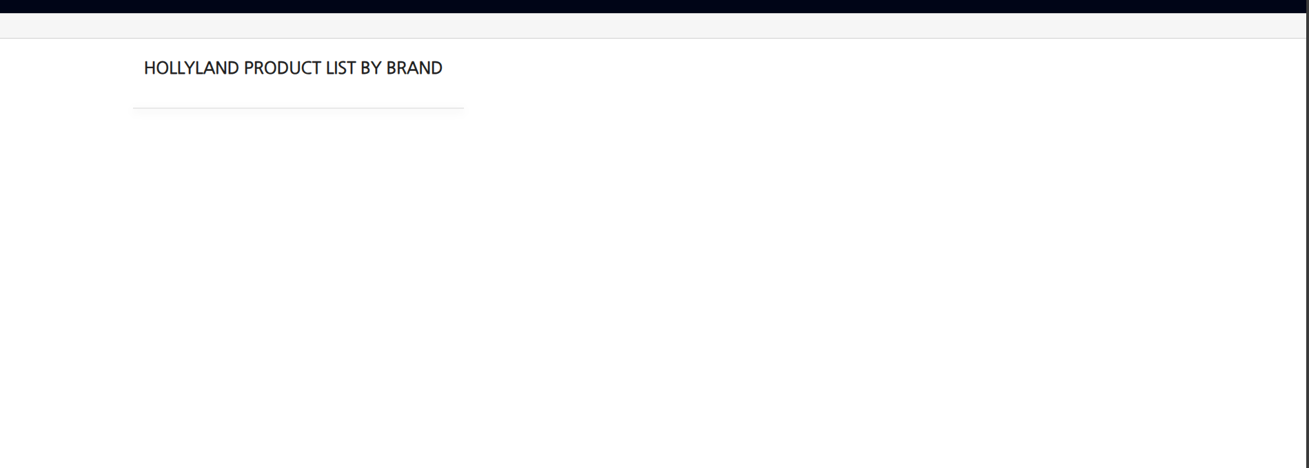

dwdsaq2 Posted May 1, 2024 Author Share Posted May 1, 2024 On 4/30/2024 at 9:08 PM, JBW said: There is a 500 server error. Activate debug mode and check the details in the response tab/server log On 4/27/2024 at 10:15 PM, dwdsaq2 said: When I enter the site on my localhost, the style or design is not working and all images are not displayed. Website appearing like this Link to comment Share on other sites More sharing options...
