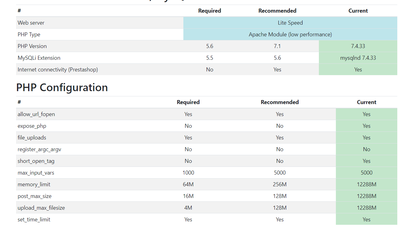

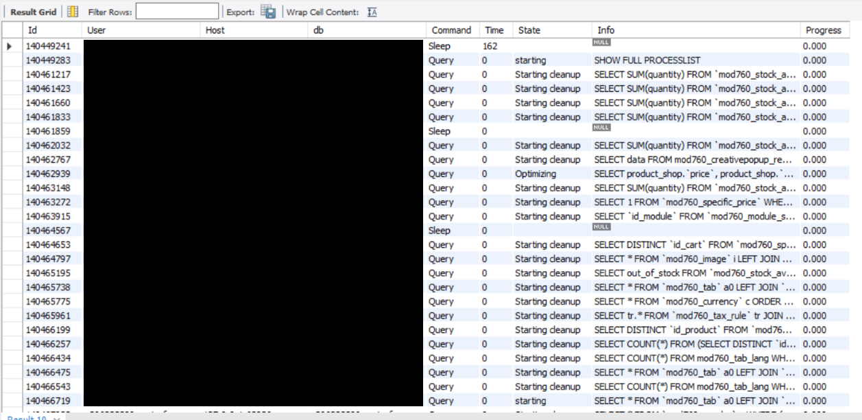

PatoPest0 Posted April 17, 2024 Share Posted April 17, 2024 Configuration and informations : Prestashop 1.7.8.11 Mariadb 10.11 We have some traffic on our website (~4000 visitors/day) + back office activity from our employees (10 employees) What we tried so far : - Upgrading from prestashop 1.7.8.7 -> 1.7.8.11 - Enable Cache - Empty Cache - Enable CDN - Enable LiteSpeed Cache (turns out not compatible with our theme) - Clean all running process from our hosting panel (Quite effective but not a viable option) - Checked performances (CPU Usage, RAM, HTTP Queries...) - Checked PHP extensions and options - Maintenance Mode - Removed some permissions from our employees in the Back Office. - Set up a local environment without facing the same problem Problem : We're facing an issue were our website is running smoothly and then is randomly slowed down by something and we were not able to identify what could be the root cause. It's to the point where our frontend is unreachable by our customers and our back office is really slow. This problem happens arround 5 times a day without recurrence nor in time or actions done from our end. After quite a lote of research we noticed that our SQL Queries stack up when we run SHOW PROCESSLIST command but we're not able to tell if there's some process stuck as our hosting provider does not allow to check the logs. Do you have any idea what could be the problem or any tips as to how to locate the problem. Let me know if you need more informations. Kind Regards. Link to comment Share on other sites More sharing options...

PatoPest0 Posted May 14, 2024 Author Share Posted May 14, 2024 Hi, Here is some update : After looking for another issue on our website I found the profiling feature of prestashop that allows you to get a lot of data about page loading time, hook loading time, module loading time, number AND logs of requests that are called sorted by loading time. It allowed us to identify that our theme (AngarTheme) generated a lot of heavy request that one of our module that came with the theme generated arround 1000 SQL queries when you get to the homepage and took arround 2000ms to load. Safe to say we removed this module immediatly as it was only for display purpose. We are still monitoring this issue, I don't think it resolved the problem but it definitely helped the performances. If you want to enable the profiling feature, you can go to config/defines.inc.php, scroll to line 46 and set profiling to true : if (!defined('_PS_DEBUG_PROFILING_')) { define('_PS_DEBUG_PROFILING_', true); } Refresh the homepage and scroll down to the bottom of your website, you should be able to see the profiler. I advise to do that on a development server first and in maintenance mode on your live server. You can follow this tutorial if you need more informations (Sorry the only good and recent one i've found is in french) : I don't know why this feature isn't mentionned more often on the forums or in the official documentation but it is really useful in my opinion. I'll keep this feed updated if I find anything else relevant. Kind Regards Link to comment Share on other sites More sharing options...
