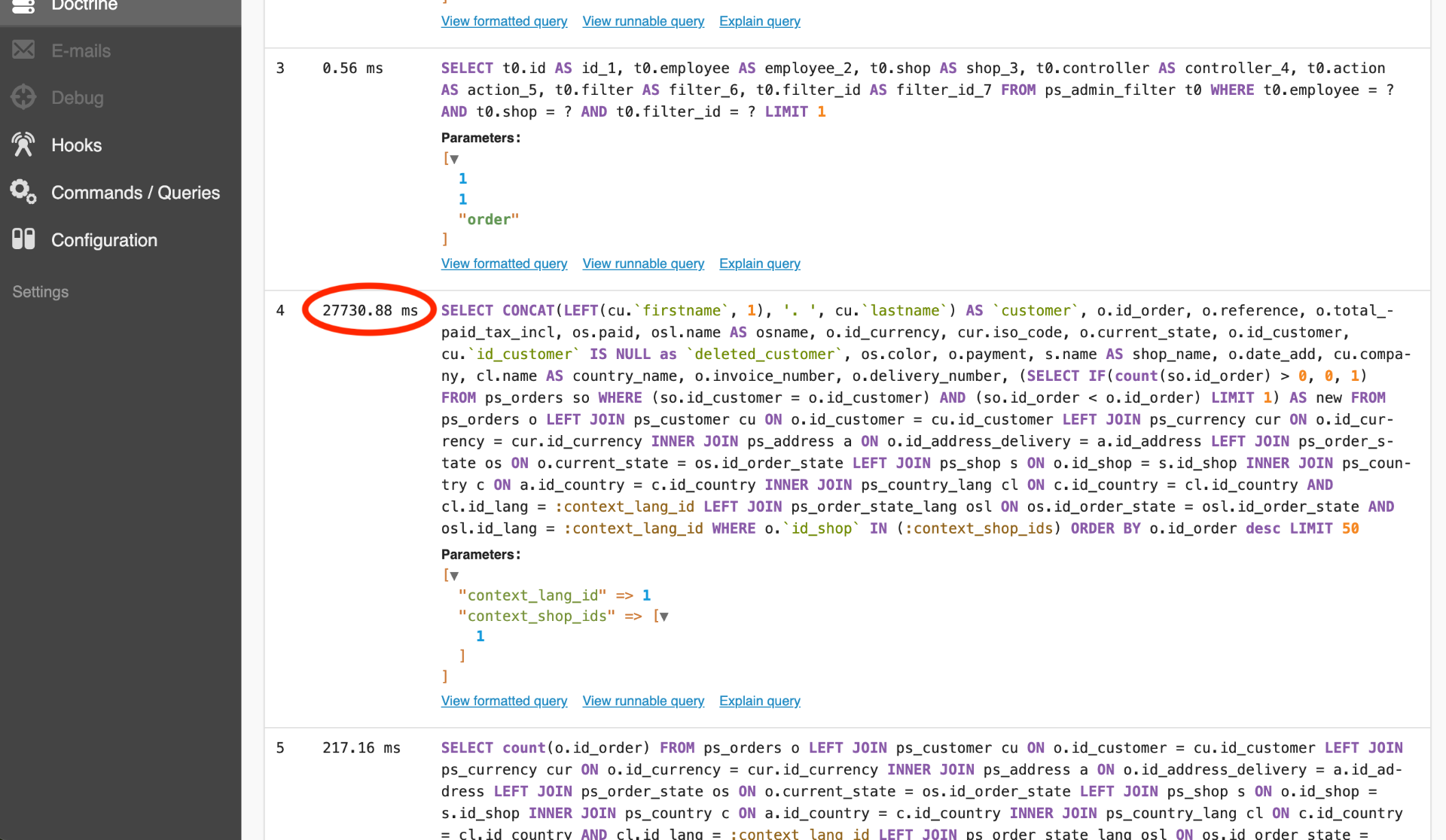

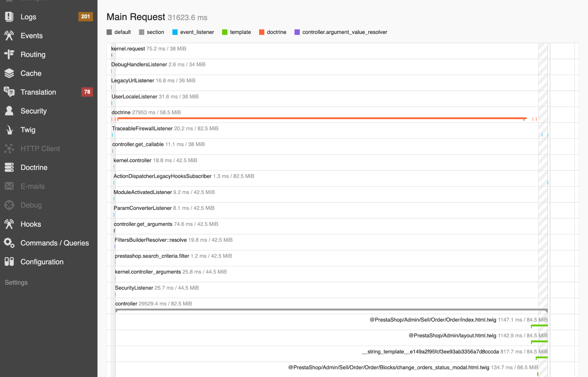

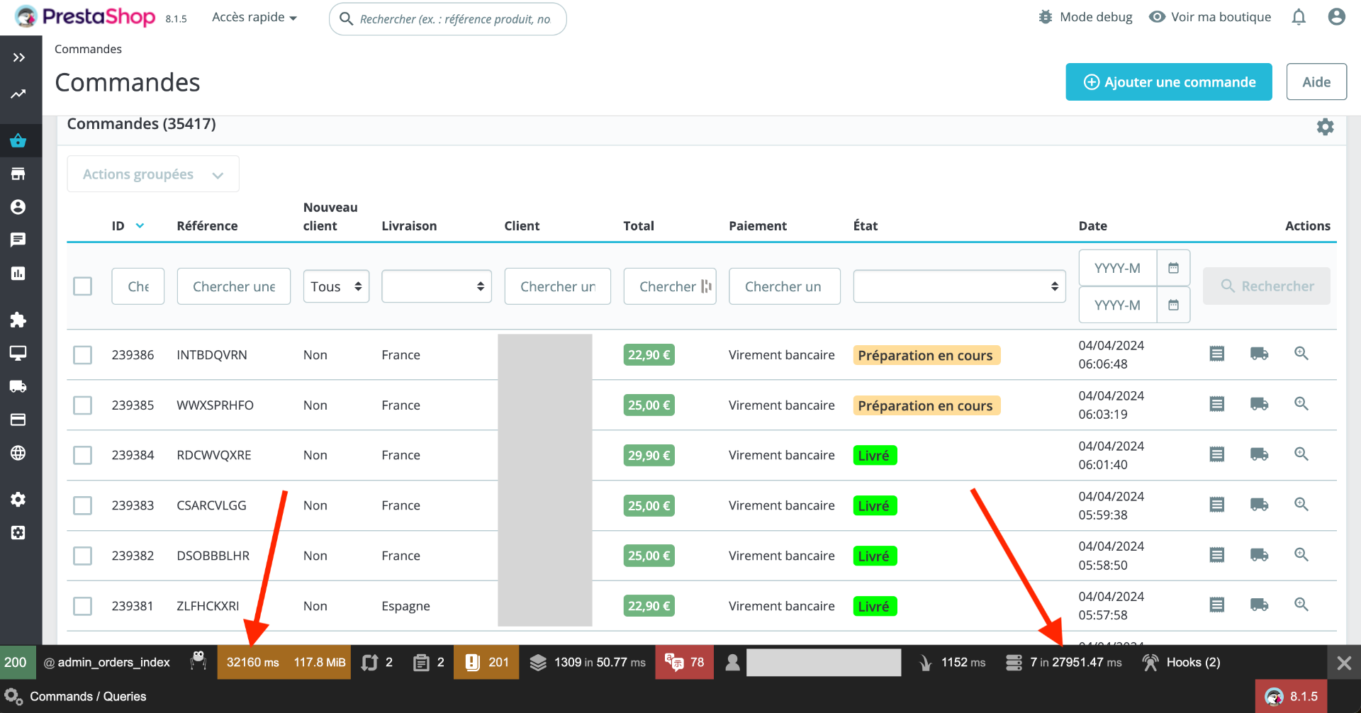

bliscar Posted April 11, 2024 Share Posted April 11, 2024 (edited) Hello. I successfully managed the manual migration from PS 1.6.1.24 to PS 8.1.5 I followed this topic which is very useful and precise : https://devdocs.prestashop-project.org/8/basics/keeping-up-to-date/migration/ I just got one issue : Displaying the orders list in the admin panel is very slow. It takes around 30 seconds to display (database contain 35,000 orders). With debug mode, it seems that one SQL query takes a long time to execute, as you can see in the screenshots. I am not an expert in SQL, so I do not know how to solve this problem 😕 Has anyone ever had this problem? Many thanks. Edited April 11, 2024 by bliscar (see edit history) Link to comment Share on other sites More sharing options...

bliscar Posted April 13, 2024 Author Share Posted April 13, 2024 Regarding my case, I found a fixing. I change the SQL request in the file : \src\Core\Grid\Query\OrderQueryBuilder.php I replace : $qb->addSelect('(' . $this->getNewCustomerSubSelect() . ') AS new'); With this : $qb->addSelect('IF((SELECT so.id_order FROM ps_orders so WHERE (so.id_customer = o.id_customer) AND (so.id_order < o.id_order) LIMIT 1) IS NOT NULL, 0, 1) AS new'); Everything is working fine now in my case. Link to comment Share on other sites More sharing options...
