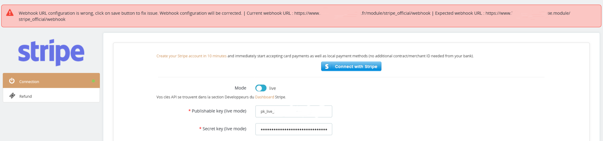

Alex- Posted April 6, 2024 Share Posted April 6, 2024 (edited) Hello, After installing and configuring everything in live mode, the module Stripe Official keeps expecting and force to push the wrong webhook url : Expected webhook URL : https://www.domain.module/stripe_official/webhook but it should be : https://www.domain.fr/module/stripe_official/webhook ; like fixed on the Stripe.com > webhooks The module wants to update to domain.module/stripe instead of domain.fr/module I tried to look everywhere, remade the webhook, update the new webhook id in the db but it keeps asking the same wrong url and unfortunately all the orders made are not created in the BO, even if the payments have been received. The domain of the shop on prestashop is correct btw Shop url :https://www.domain.fr Physical url : / Thank you for your help. Edit 1 : I found out the issue might be caused by this function in the file /stripe_official.php /** * get webhook url of stripe_official module * * @return string */ public static function getWebhookUrl() { $context = Context::getContext(); $locale = $context->language->iso_code; $url = $context->link->getModuleLink( 'stripe_official', 'webhook', [], true, null, Configuration::get('PS_SHOP_DEFAULT') ); return str_replace($locale . '/', '', $url); } By changing this function by : /** * get webhook url of stripe_official module * * @return string */ public static function getWebhookUrl() { return 'https://www.domain.fr/module/stripe_official/webhook'; } Or by : public static function getWebhookUrl() { $context = Context::getContext(); // Obtenir l'URL générée dynamiquement $url = $context->link->getModuleLink( 'stripe_official', 'webhook', [], true, null, Configuration::get('PS_SHOP_DEFAULT') ); return $url; } I don't have the message shown in the backoffice anymore. I'm not sure if the webhook will works properly though. Edited April 6, 2024 by Alex- (see edit history) 1 Link to comment Share on other sites More sharing options...

Alex- Posted April 6, 2024 Author Share Posted April 6, 2024 Thanks for your reply. I fixed the issue myself with modification I have posted in my previous message in the edit. The function use "$locale" to get the iso code "fr" to remove from the URL /fr/ for example but it simply removes the "'.fr/". It's actually not an issue with Stripe but with the function in the module. As the website is in french "fr" and the domain extension is ".fr", the function truncate this part from the webhook URL. By changing the original function with the code I've modified, fix the issue. Link to comment Share on other sites More sharing options...
