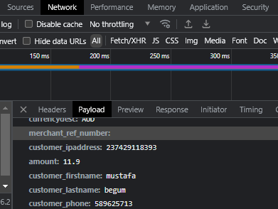

Hi, I'm working on external type payment module where i need to pass the order reference (that we get on successful order validation & order confirmation page) to payment gateway via POST method. I need order reference to be passed in ' $merchant_ref_number ' but the redirection to payment gateway doesn't work the moment when I use $merchant_ref_number $order_id-> reference;  instead of '$merchant_ref_number = trim( (string) $order_id ); '   becoz $merchant_ref_number is one of the parameters passed in request url to gateway and its expected to pass order_id (i.e need number not characters as we get for 9 digit reference) inorder to successfully redirect to gateway.  I checked in chrome inspect network tab, the 'merchant_ref_number' field remains empty while sending payment request url.image.png.5f8dac157e5544c74e97fc43c34d72d8.png

At this moment, the order is still not yet created, that’s why it’s empty.
You have only a cart instance at this time.
When the PaymentModule::validateOrder will be called, one or more order(s) will be created from the cart.
Then you can retrieve the order reference cause now it will exist.
So maybe you could send the cart id instead ?
$merchant_ref_number = $params["cart"]->id; // Get Cart from hooks $params argument
