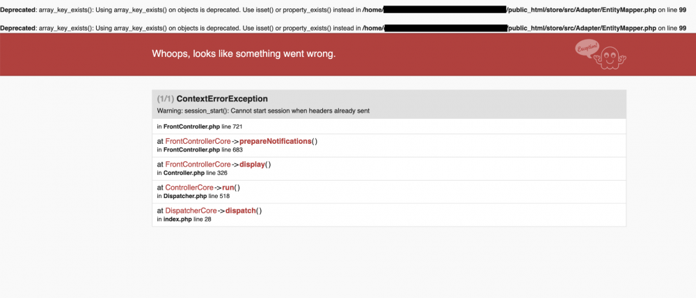

Jay C Posted June 3, 2023 Author Share Posted June 3, 2023 9 hours ago, ComGrafPL said: Post debug mode errors. Either install clean 1.7.8.9 / 8 and migrate the data, so you can work on PHP 7.4 / 8. When I change PHP to 7.4.33, these errors pop up on the front end Whoops, looks like something went wrong. (1/1) ContextErrorException Warning: Cannot modify header information - headers already sent by (output started at /public_html/store/src/Adapter/EntityMapper.php:99) in FrontController.php line 787 at FrontControllerCore->sslRedirection()in FrontController.php line 297 at FrontControllerCore->init()in Controller.php line 287 at ControllerCore->run()in Dispatcher.php line 518 at DispatcherCore->dispatch()in index.php line 28 Link to comment Share on other sites More sharing options...

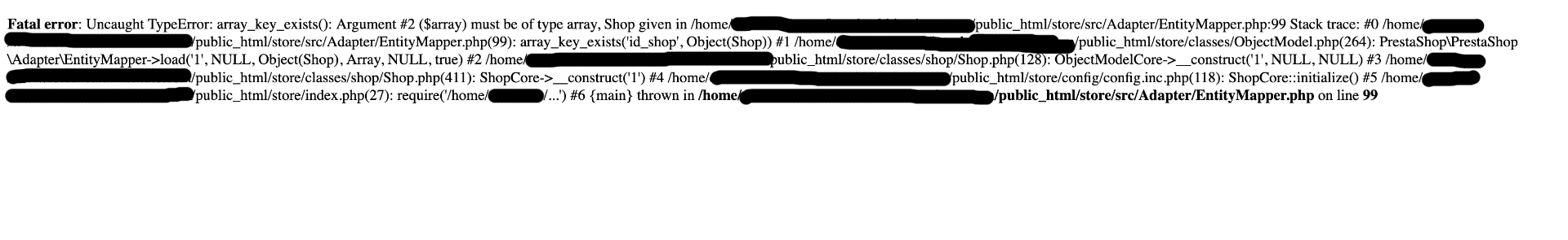

idnovate.com Posted June 5, 2023 Share Posted June 5, 2023 On 6/3/2023 at 5:57 PM, Jay C said: When I change PHP to 7.4.33, these errors pop up on the front end Whoops, looks like something went wrong. (1/1) ContextErrorException Warning: Cannot modify header information - headers already sent by (output started at /public_html/store/src/Adapter/EntityMapper.php:99) in FrontController.php line 787 at FrontControllerCore->sslRedirection()in FrontController.php line 297 at FrontControllerCore->init()in Controller.php line 287 at ControllerCore->run()in Dispatcher.php line 518 at DispatcherCore->dispatch()in index.php line 28 Could you please upload a screenshot of the error? Link to comment Share on other sites More sharing options...
Jay C Posted June 5, 2023 Author Share Posted June 5, 2023 (edited) 13 hours ago, idnovate.com said: Could you please upload a screenshot of the error? I uploaded two screenshots. One when I change the system to PHP 7.4.33 and another when I change it to PHP 8.0.28. PHP 8.0.28 PHP 7.4.33 Edited June 5, 2023 by Jay C labled the images (see edit history) Link to comment Share on other sites More sharing options...
idnovate.com Posted June 8, 2023 Share Posted June 8, 2023 Indeed, these errors appears because you are using a PHP version not compatible with your PS version: https://devdocs.prestashop-project.org/1.7/basics/installation/system-requirements/#php-compatibility-chart But it seems that you had some errors before this change: Quote The reset password feature never worked Quote the Stripe module isn't completing orders after either an upgrade to the module or the installation of another module Quote the shop front page stops displaying content and only shows the header and the footer until I go in and manually reset the cache So, what do you prefer to do? Updating PHP and PS or keep the versions and check the errors? Link to comment Share on other sites More sharing options...
