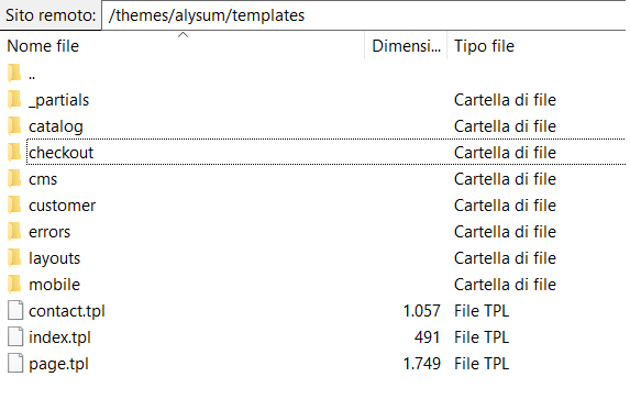

Leolautzu Posted February 22 Posted February 22 (edited) Okay, grazie nel mio caso sarà un file tpl? (metto le immagini del FTP perchè faccio molta fatica a individuare il file giusto) Edited February 22 by Leolautzu (see edit history) Share this post Link to post Share on other sites More sharing options...
@diegofrancesco Posted February 22 Posted February 22 Sì è un file .tpl e dovrebbe essere order-confirmation.tpl Share this post Link to post Share on other sites More sharing options...
