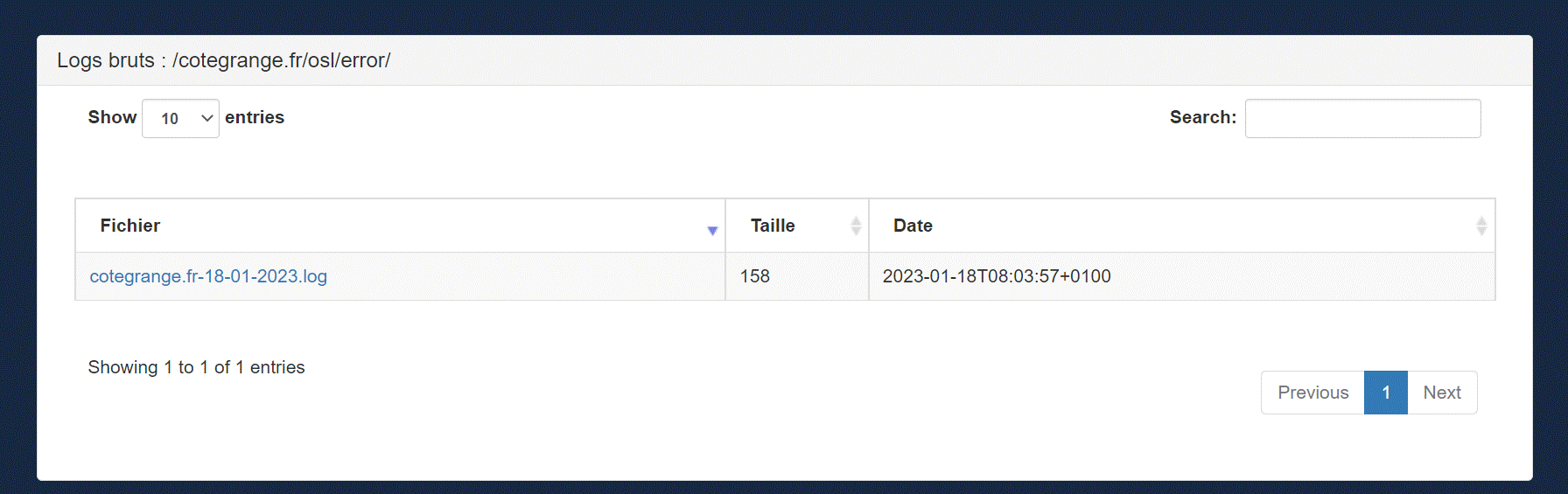

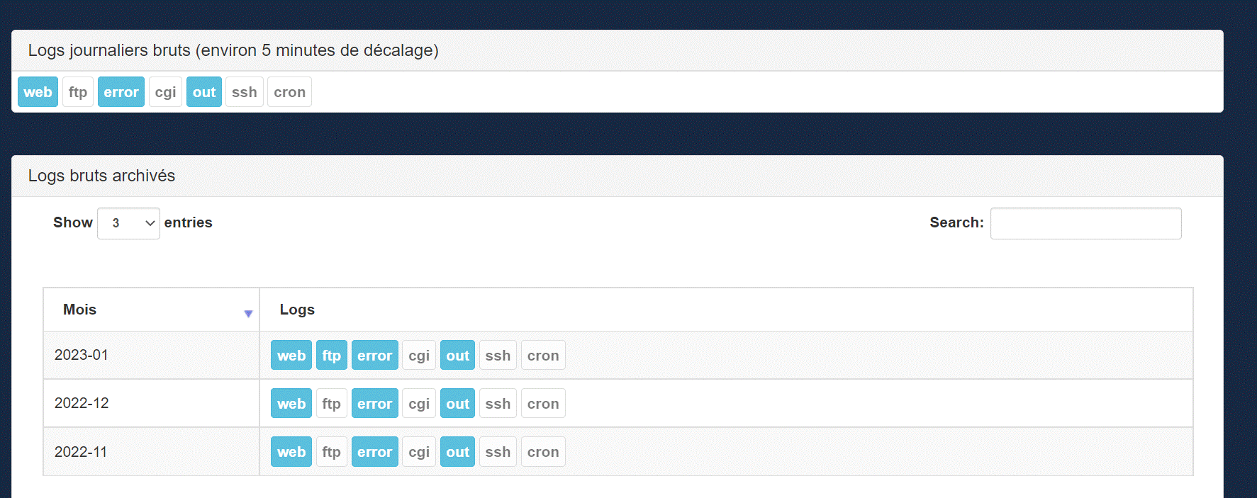

Côte Grange Posted January 18, 2023 Author Share Posted January 18, 2023 J'ai trouvé les logs mais comment comprendre et résoudre le problème ? Link to comment Share on other sites More sharing options...
Eolia Posted January 18, 2023 Share Posted January 18, 2023 cliquez la-dessus et donnez-nous le contenu ici Link to comment Share on other sites More sharing options...
Côte Grange Posted January 18, 2023 Author Share Posted January 18, 2023 Voila ce que ça donne, mais il n'y a que la date d'aujourd'hui, alors que le bug dure depuis samedi, est-ce normal ? Link to comment Share on other sites More sharing options...

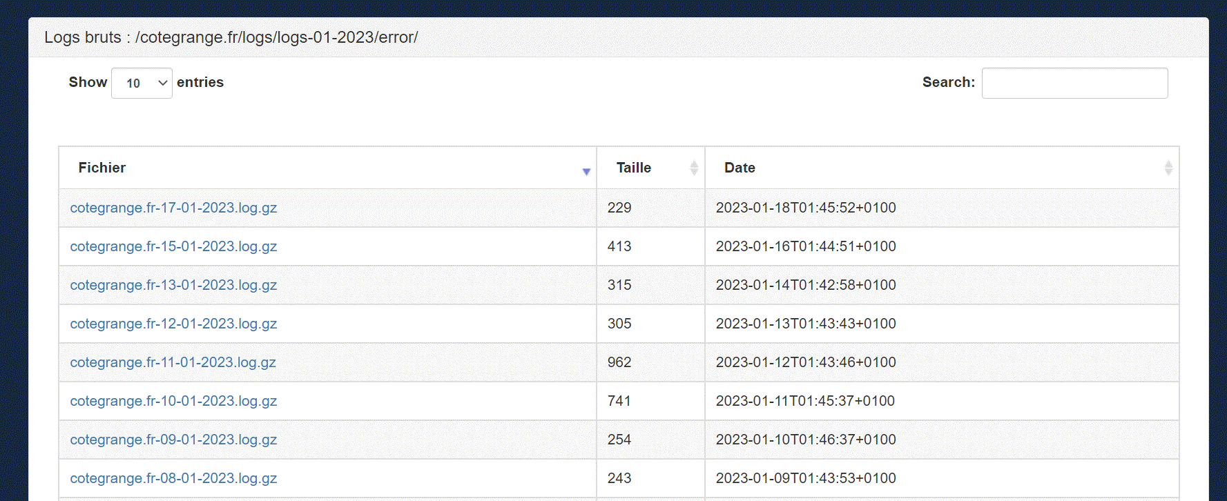

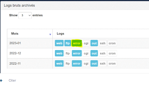

Eolia Posted January 18, 2023 Share Posted January 18, 2023 Oui vu que la première ligne de votre copie d'écran correspond au log du jour. Si vous n'avez pas essayé d'accéder au BO ce matin il n'y aura pas d'erreur enregistrée. Cliquez donc sur celui- là: (logs du mois de janvier) Link to comment Share on other sites More sharing options...
Côte Grange Posted January 18, 2023 Author Share Posted January 18, 2023 Link to comment Share on other sites More sharing options...
Eolia Posted January 18, 2023 Share Posted January 18, 2023 ouvrez-en un du jour où vous avez eu l'erreur Link to comment Share on other sites More sharing options...
Côte Grange Posted January 18, 2023 Author Share Posted January 18, 2023 L'erreur date du 14, mais pas de date... Je vous mets donc celle du 15/01 C'est un copier / coller, dites moi si c'est mieux une capture : [Sun Jan 15 03:12:10 2023] [error] [client 66.249.92.195] [host www.cotegrange.fr] AH00687: Negotiation: discovered file(s) matching request: /homez.759/cotegran/boutique/images (None could be negotiated). [Sun Jan 15 03:12:10 2023] [error] [client 66.249.92.151] [host cotegrange.fr] AH00687: Negotiation: discovered file(s) matching request: /homez.759/cotegran/boutique/images (None could be negotiated). [Sun Jan 15 03:12:12 2023] [error] [client 66.249.92.45] [host www.cotegrange.fr] AH00687: Negotiation: discovered file(s) matching request: /homez.759/cotegran/boutique/images (None could be negotiated). [Sun Jan 15 03:12:12 2023] [error] [client 66.249.92.151] [host cotegrange.fr] AH00687: Negotiation: discovered file(s) matching request: /homez.759/cotegran/boutique/images (None could be negotiated). [Sun Jan 15 03:12:13 2023] [error] [client 66.249.92.195] [host www.cotegrange.fr] AH00687: Negotiation: discovered file(s) matching request: /homez.759/cotegran/boutique/images (None could be negotiated). [Sun Jan 15 03:12:14 2023] [error] [client 66.249.92.151] [host www.cotegrange.fr] AH00687: Negotiation: discovered file(s) matching request: /homez.759/cotegran/boutique/images (None could be negotiated). [Sun Jan 15 03:12:14 2023] [error] [client 66.249.92.151] [host cotegrange.fr] AH00687: Negotiation: discovered file(s) matching request: /homez.759/cotegran/boutique/images (None could be negotiated). [Sun Jan 15 03:12:15 2023] [error] [client 66.249.92.195] [host cotegrange.fr] AH00687: Negotiation: discovered file(s) matching request: /homez.759/cotegran/boutique/images (None could be negotiated). [Sun Jan 15 03:12:15 2023] [error] [client 66.249.92.91] [host www.cotegrange.fr] AH00687: Negotiation: discovered file(s) matching request: /homez.759/cotegran/boutique/images (None could be negotiated). [Sun Jan 15 03:12:16 2023] [error] [client 66.249.92.151] [host www.cotegrange.fr] AH00687: Negotiation: discovered file(s) matching request: /homez.759/cotegran/boutique/images (None could be negotiated). [Sun Jan 15 03:12:16 2023] [error] [client 66.249.92.151] [host cotegrange.fr] AH00687: Negotiation: discovered file(s) matching request: /homez.759/cotegran/boutique/images (None could be negotiated). [Sun Jan 15 03:12:17 2023] [error] [client 66.249.92.151] [host cotegrange.fr] AH00687: Negotiation: discovered file(s) matching request: /homez.759/cotegran/boutique/images (None could be negotiated). [Sun Jan 15 09:55:37 2023] [error] [client 66.249.92.195] [host www.cotegrange.fr] AH00687: Negotiation: discovered file(s) matching request: /homez.759/cotegran/boutique/images (None could be negotiated). [Sun Jan 15 09:55:38 2023] [error] [client 66.249.92.195] [host www.cotegrange.fr] AH00687: Negotiation: discovered file(s) matching request: /homez.759/cotegran/boutique/images (None could be negotiated). [Sun Jan 15 09:55:38 2023] [error] [client 66.249.92.91] [host cotegrange.fr] AH00687: Negotiation: discovered file(s) matching request: /homez.759/cotegran/boutique/images (None could be negotiated). [Sun Jan 15 09:55:39 2023] [error] [client 66.249.92.195] [host www.cotegrange.fr] AH00687: Negotiation: discovered file(s) matching request: /homez.759/cotegran/boutique/images (None could be negotiated). [Sun Jan 15 09:55:40 2023] [error] [client 66.249.92.91] [host cotegrange.fr] AH00687: Negotiation: discovered file(s) matching request: /homez.759/cotegran/boutique/images (None could be negotiated). [Sun Jan 15 12:15:25 2023] [error] [client 164.92.90.25] [host cotegrange.fr] AH01630: client denied by server configuration: /homez.759/cotegran/boutique/vendor/.env, referer: https://www.google.com/ [Sun Jan 15 12:15:31 2023] [error] [client 164.92.90.25] [host cotegrange.fr] AH01630: client denied by server configuration: /homez.759/cotegran/boutique/config/.env, referer: https://www.google.com/ [Sun Jan 15 12:15:31 2023] [error] [client 164.92.90.25] [host cotegrange.fr] AH01630: client denied by server configuration: /homez.759/cotegran/boutique/app/.env, referer: https://www.google.com/ [Sun Jan 15 12:15:50 2023] [error] [client 164.92.90.25] [host cotegrange.fr] AH01630: client denied by server configuration: /homez.759/cotegran/boutique/vendor/phpunit, referer: https://www.google.com/ [Sun Jan 15 12:15:50 2023] [error] [client 164.92.90.25] [host cotegrange.fr] AH01630: client denied by server configuration: /homez.759/cotegran/boutique/vendor/phpunit, referer: https://www.google.com/ Link to comment Share on other sites More sharing options...

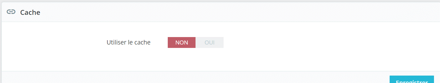

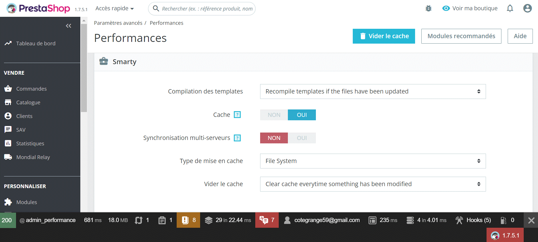

Côte Grange Posted January 18, 2023 Author Share Posted January 18, 2023 Sur quoi je dois appuyer précisemment ? Car "vider le cache" me propose un menu déroulant : "clear cache everytime something has been modified" ou "never clear cache files" J'ai aussi "utiliser le cache" à activer ou non Link to comment Share on other sites More sharing options...
Mediacom87 Posted January 18, 2023 Share Posted January 18, 2023 Videz le cache manuellement, cela sera plus sûr. https://www.mediacom87.fr/faq-comment-vider-le-cache-manuellement-sur-prestashop-17/ Link to comment Share on other sites More sharing options...
Eolia Posted January 18, 2023 Share Posted January 18, 2023 Ben il y a un gros bouton en haut^^ Link to comment Share on other sites More sharing options...
Côte Grange Posted January 18, 2023 Author Share Posted January 18, 2023 C'est fait, le front office a été remis en ordre. Le mode debug est toujours activé, et je ne peux toujours pas modifier le stock des produits. Faut-il remettre le "false" dans le fichier FTP ? Link to comment Share on other sites More sharing options...
Eolia Posted January 18, 2023 Share Posted January 18, 2023 une erreur lors du changement de stock ? Link to comment Share on other sites More sharing options...
Mediacom87 Posted January 18, 2023 Share Posted January 18, 2023 il y a 12 minutes, Côte Grange a dit : C'est fait, le front office a été remis en ordre. Le mode debug est toujours activé, et je ne peux toujours pas modifier le stock des produits. Faut-il remettre le "false" dans le fichier FTP ? Vous l'avez fait manuellement ou simplement avec le bouton ? Si ce n'est que le bouton, faites-le manuellement, c'est plus sûr. Link to comment Share on other sites More sharing options...

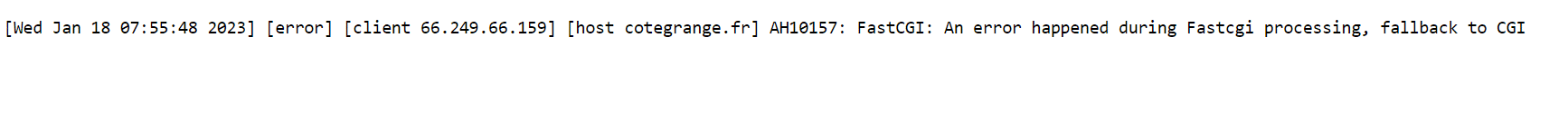

Eolia Posted January 18, 2023 Share Posted January 18, 2023 donc si erreur 500 vous devez avoir quelque chose dans le log du jour d'ovh Link to comment Share on other sites More sharing options...
Côte Grange Posted January 18, 2023 Author Share Posted January 18, 2023 Le log du jour : [Wed Jan 18 07:55:48 2023] [error] [client 66.249.66.159] [host cotegrange.fr] AH10157: FastCGI: An error happened during Fastcgi processing, fallback to CGI [Wed Jan 18 14:28:40 2023] [error] [client 114.119.146.55] [host cotegrange.fr] (104)Connection reset by peer: AH10143: FastCGI: comm with server "/homez.759/cotegran/boutique/index.php" aborted: read failed, referer: https://cotegrange.fr/index.php?id_category=2&controller=category&q=Catégories-Bijoux-Décoration-Vaisselle-Beauté%2FPrix-€-24-40&page=2 [Wed Jan 18 14:28:40 2023] [error] [client 114.119.146.55] [host cotegrange.fr] AH10149: FastCGI: incomplete headers (0 bytes) received from server "/homez.759/cotegran/boutique/index.php", referer: https://cotegrange.fr/index.php?id_category=2&controller=category&q=Catégories-Bijoux-Décoration-Vaisselle-Beauté%2FPrix-€-24-40&page=2 [Wed Jan 18 14:28:40 2023] [error] [client 114.119.146.55] [host cotegrange.fr] AH10157: FastCGI: An error happened during Fastcgi processing, fallback to CGI, referer: https://cotegrange.fr/index.php?id_category=2&controller=category&q=Catégories-Bijoux-Décoration-Vaisselle-Beauté%2FPrix-€-24-40&page=2 Link to comment Share on other sites More sharing options...

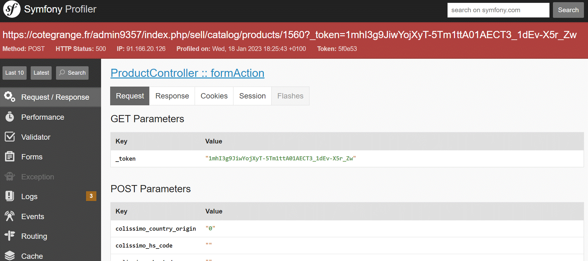

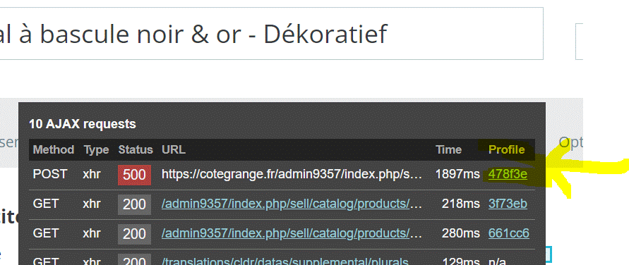

Eolia Posted January 18, 2023 Share Posted January 18, 2023 Ok, rien, donc c'est une fausse erreur 500 renvoyée par Prestashop. Vous pouvez cliquer sur l'url appelée ? Link to comment Share on other sites More sharing options...
Côte Grange Posted January 18, 2023 Author Share Posted January 18, 2023 Je ne peux pas cliquer sur le lien dans le log, mais je peux cliquer sur cette discussion : ça me redirige sur cette page : Link to comment Share on other sites More sharing options...
Eolia Posted January 18, 2023 Share Posted January 18, 2023 vous pouvez cliquer sur "Profile" à droite, non ?(478...) Link to comment Share on other sites More sharing options...
Côte Grange Posted January 18, 2023 Author Share Posted January 18, 2023 Je ne vois pas de "profile" ni de "478" ? Link to comment Share on other sites More sharing options...

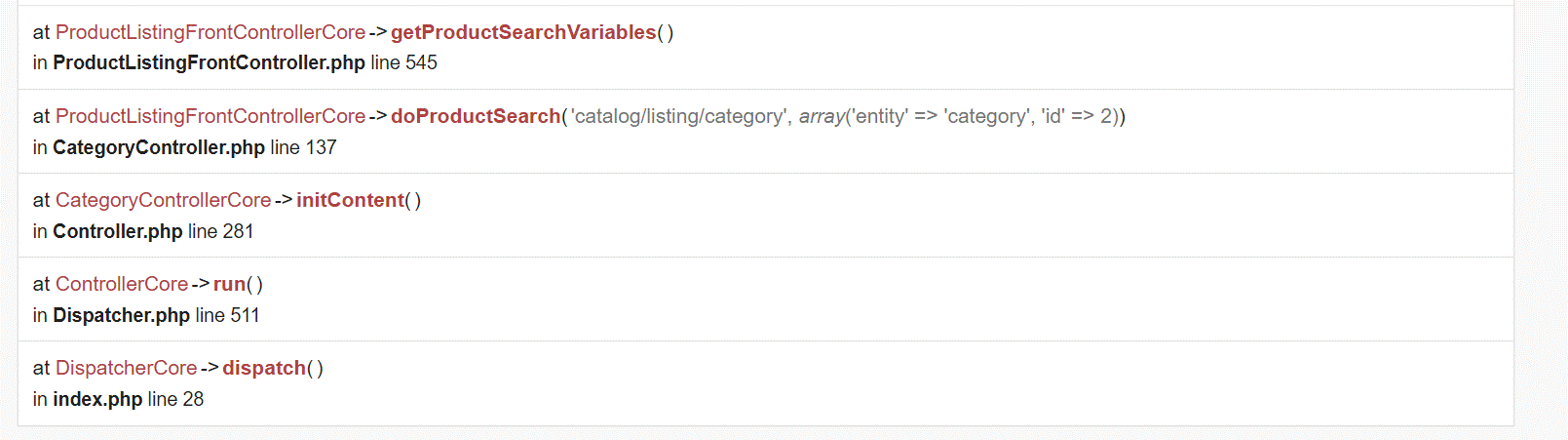

Eolia Posted January 18, 2023 Share Posted January 18, 2023 Link to comment Share on other sites More sharing options...

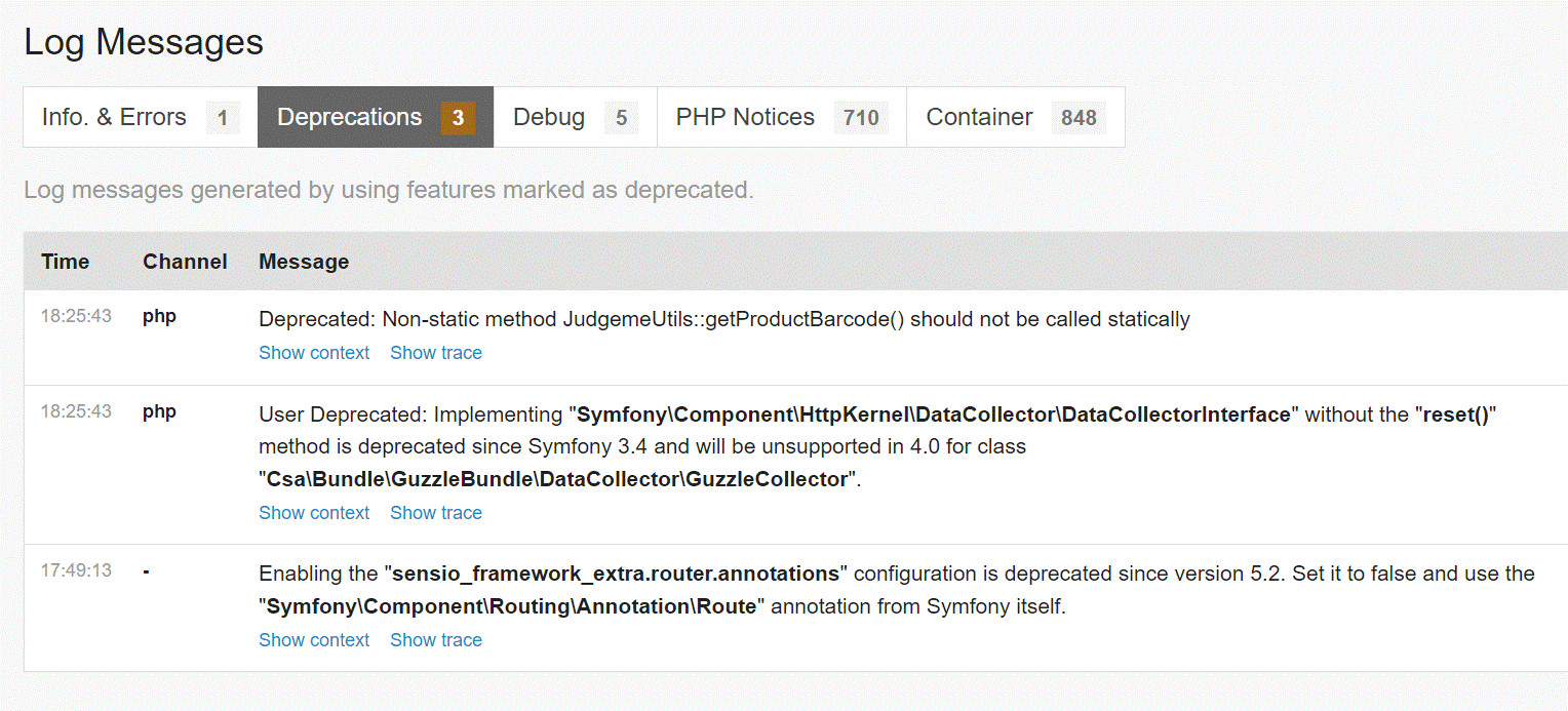

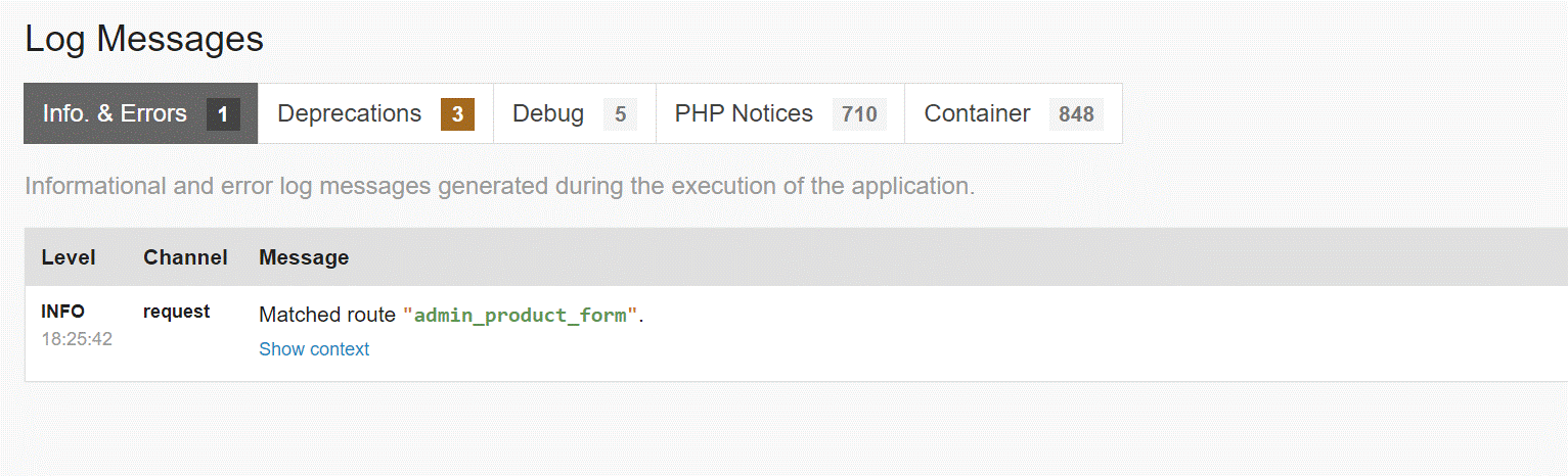

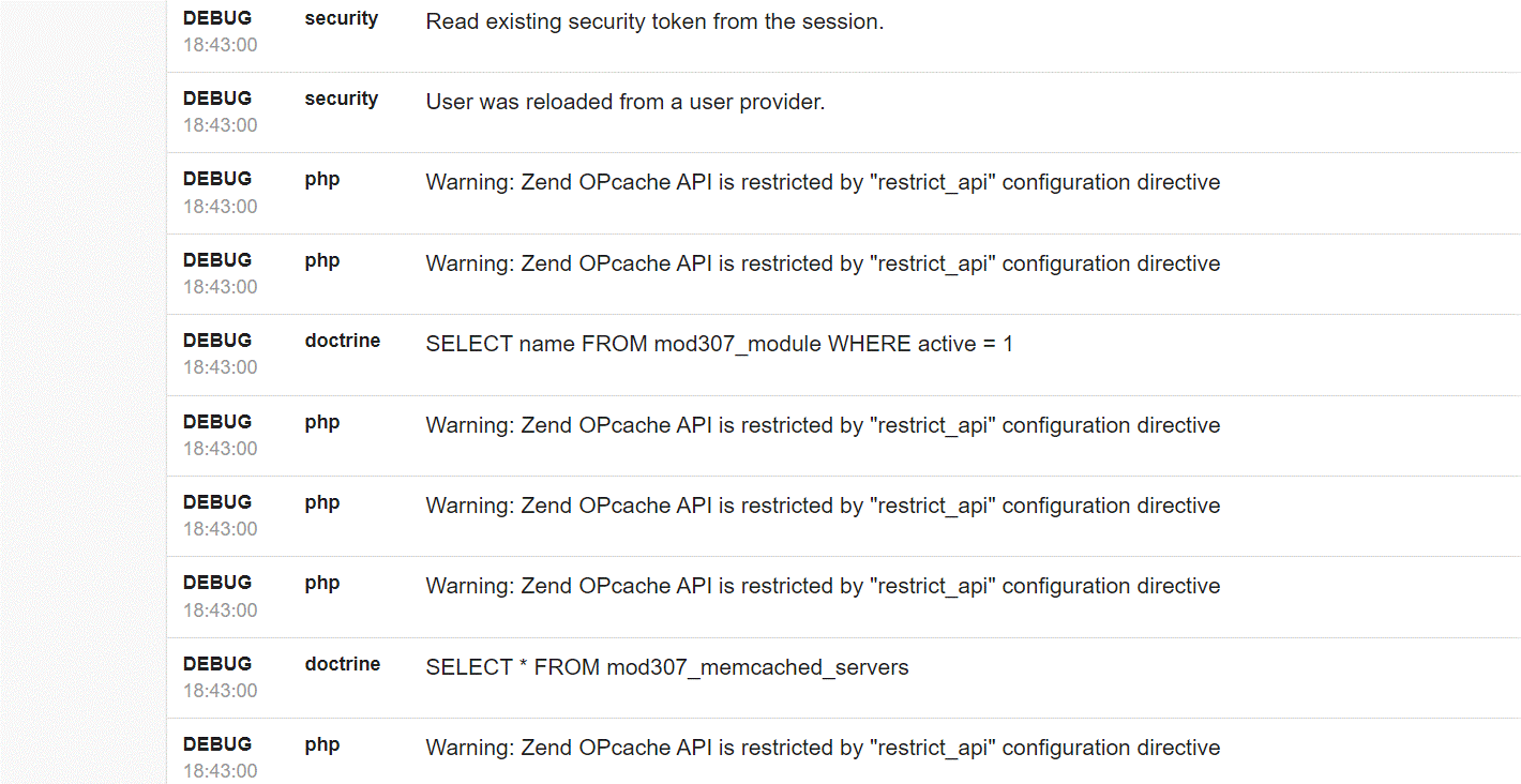

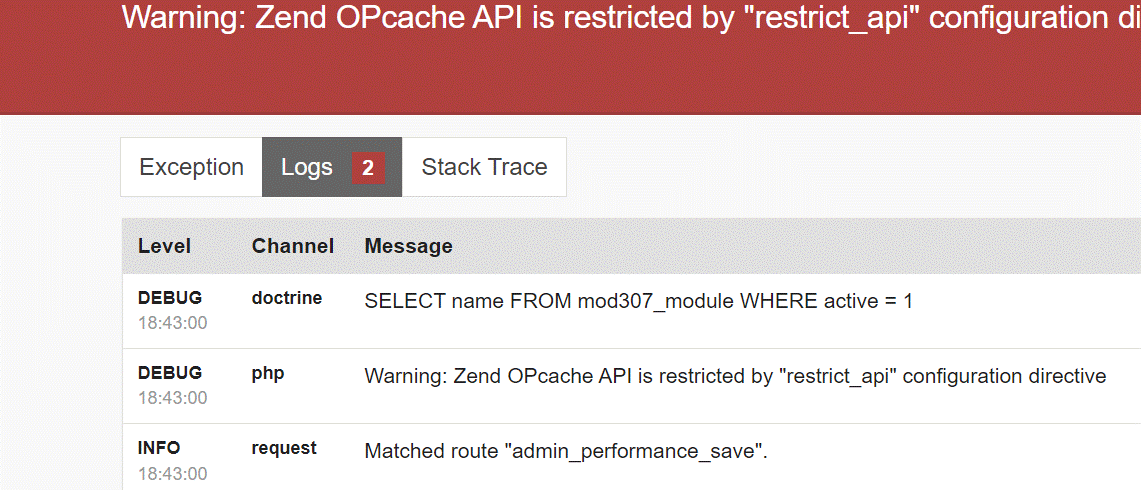

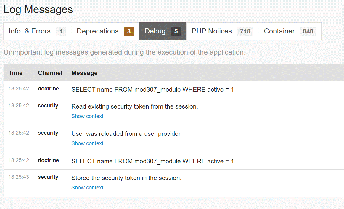

Eolia Posted January 18, 2023 Share Posted January 18, 2023 et l'onglet Debug dit quoi ? Link to comment Share on other sites More sharing options...
Eolia Posted January 18, 2023 Share Posted January 18, 2023 Ok, donc leur debug ne sert à rien... Désolé je ne peux pas vous aider plus. Link to comment Share on other sites More sharing options...

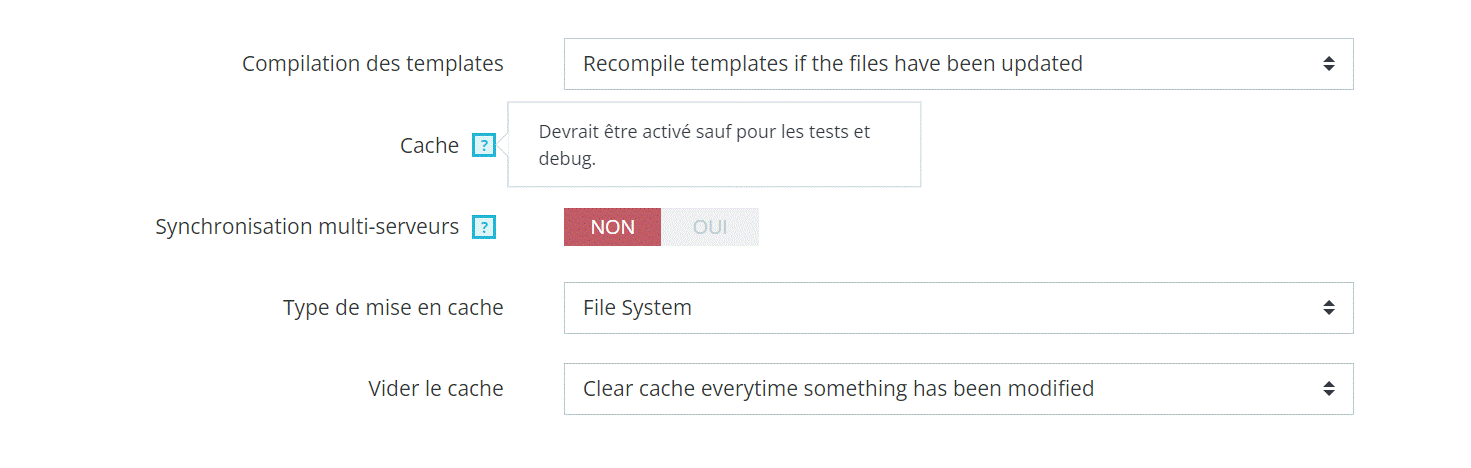

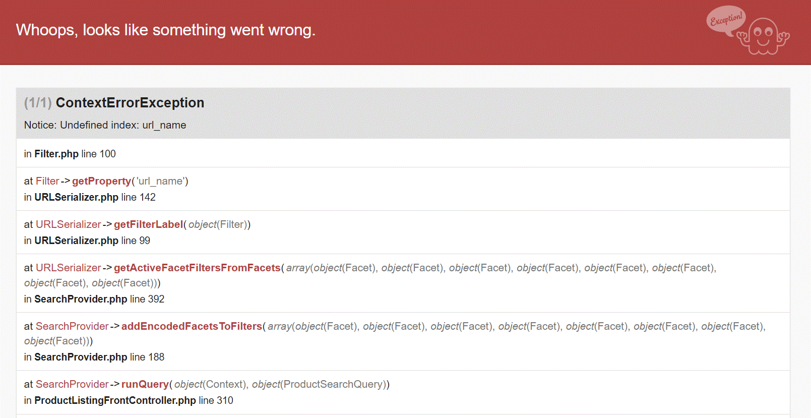

Côte Grange Posted January 18, 2023 Author Share Posted January 18, 2023 En désactivant le mode debug, j'ai ça : Mais l'assistance Prestashop ne m'apporte aucune solution, elle veut me faire payer un ticket diagnostic à 90€ pour mettre un développeur sur le problème.. Le problème de base étant une mise à jour de module qui a amené la page HTTP error 500, on ne peut rien faire d'autre ? Link to comment Share on other sites More sharing options...
Eolia Posted January 18, 2023 Share Posted January 18, 2023 à l’instant, Côte Grange a dit : Le problème de base étant une mise à jour de module qui a amené la page HTTP error 500 Ok, merci de l'info, on ne pouvait pas deviner. Si vous savez quel module, renommez-le sur votre ftp (en rajoutant _bad à son nom par exemple), au moins ca débloquera votre BO. Ensuite, voyez avec les auteurs du module. Link to comment Share on other sites More sharing options...
