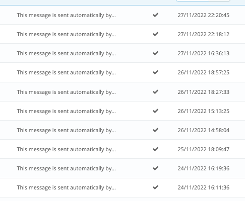

corrado Posted November 23, 2022 Posted November 23, 2022 Come posso risolvere il problema. E' stato causato dal modulo ? Grazie per l'aiuto This message is sent automatically by module PrestaShop Checkout A customer encountered a processing payment error : Customer identifier: 26 Cart identifier: 80 PayPal order identifier: 7YK07288GD709794G Exception identifier: 44 Exception detail: Error: ETIMEDOUT If you need assistance, please contact our Support Team on PrestaShop Checkout configuration page on Help subtab. Share this post Link to post Share on other sites More sharing options...
