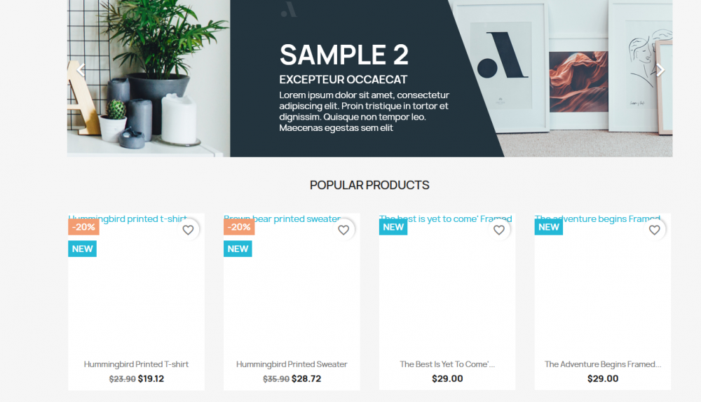

How do I fix this?  I have SSL working, but it blocks the database so none of the pictures show up and clicking on any existing link will lead to a "The requested URL was not found on this server".  For some reason when I try to go to localhost it redirects to https weather I enter the ip address or localhost and :80.  I've had this issue before.  If I could get this to view through http instead of https the database would show when this happened on another server.  Is there a config somewhere in mariaDB that needs to know where the ssl .crt and key files are?  This is what the site looks like when on https.  If you click any image under products it goes to a URL not found page.

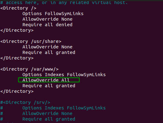

I found a solution for this issue.  I am not sure if this will make a website vulnerable or not though.
I changed /etc/apache2/apache2.conf.  I changed "AllowOverride" under /var/www to "All", restarted apache2 and now I can access the listings with friendly url enabled.
