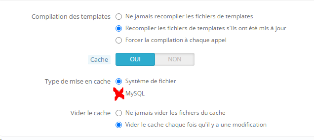

manolo Posted July 24, 2022 Share Posted July 24, 2022 (edited) On 7/22/2022 at 9:59 PM, mandrake said: Bonsoir, merci pour l'information ! Le fichier config/smarty.config.inc.php de la version 1.6.0.8 est différent. On n'y trouve pas la portion de code indiquée à supprimer. Quelqu'un a une idée sur la partie à supprimer dans cette version ? Merci. Bonjour, j'ai le meme probleme, ma version est 1.6.0.6 et le fichier config/smarty.config.inc.php est similaire a le tien (mon français ecrit n'est pas tres bone, je change a l'anglais) When I try to enter the admin panel, I put the email and the password, it takes me to index.php?controller=AdminLogin&token=a26cBLABLABLA...&redirect=AdminDashboard but no message or screen change. I'm not a prestashop developer so I don't know exactly what is the problem because it seems to log into prestashop but the screen maybe does not change because smarty is corrupt. I have analyzed previous days logs and I have seen some suspicious GET/POST from IP 92.205.110.171 using a python script, here is the sequence.. 92.205.110.171 - - [18/Jul/2022:03:53:11 +0000] "GET /en//modules/autoupgrade/vendor/phpunit/phpunit/src/Util/PHP/eval-stdin.php HTTP/1.1" 404 67207 "-" "python-requests/2.27.1" 92.205.110.171 - - [18/Jul/2022:03:53:13 +0000] "GET /en//modules/autoupgrade/vendor/phpunit/phpunit/src/Util/PHP/XsamXadoo_Bot_Rce.php HTTP/1.1" 404 67211 "-" "python-requests/2.27.1" 92.205.110.171 - - [18/Jul/2022:03:53:17 +0000] "GET /en//modules/ps_facetedsearch/vendor/phpunit/phpunit/src/Util/PHP/eval-stdin.php HTTP/1.1" 404 67205 "-" "python-requests/2.27.1" 92.205.110.171 - - [18/Jul/2022:03:53:19 +0000] "GET /en//modules/ps_facetedsearch/vendor/phpunit/phpunit/src/Util/PHP/XsamXadoo_Bot_Rce.php HTTP/1.1" 404 67209 "-" "python-requests/2.27.1" 92.205.110.171 - - [18/Jul/2022:03:53:23 +0000] "GET /en//modules/gamification/vendor/phpunit/phpunit/src/Util/PHP/eval-stdin.php HTTP/1.1" 404 67205 "-" "python-requests/2.27.1" 92.205.110.171 - - [18/Jul/2022:03:53:26 +0000] "GET /en//modules/gamification/vendor/phpunit/phpunit/src/Util/PHP/XsamXadoo_Bot_Rce.php HTTP/1.1" 404 67211 "-" "python-requests/2.27.1" 92.205.110.171 - - [18/Jul/2022:03:53:29 +0000] "POST /en//modules/smartprestashopthemeadmin/ajax_smartprestashopthemeadmin.php HTTP/1.1" 404 67205 "-" "python-requests/2.27.1" 92.205.110.171 - - [18/Jul/2022:03:53:32 +0000] "POST /en//modules/jmsslider/ajax_jmsslider.php?action=addLayer&id_slide=XSam-XAdoo&data_type=image HTTP/1.1" 404 67325 "-" "python-requests/2.27.1" 92.205.110.171 - - [18/Jul/2022:03:53:36 +0000] "GET /en//modules/jmsslider/views/img/layers/xsam_xadoo_bot.php HTTP/1.1" 404 67207 "-" "python-requests/2.27.1" 92.205.110.171 - - [18/Jul/2022:03:53:39 +0000] "POST /en//modules/groupcategory/GroupCategoryUploadImage.php HTTP/1.1" 404 67205 "-" "python-requests/2.27.1" 92.205.110.171 - - [18/Jul/2022:03:53:43 +0000] "POST /en//modules/verticalmegamenus/VerticalMegaMenusUploadImage.php HTTP/1.1" 404 67209 "-" "python-requests/2.27.1" 92.205.110.171 - - [18/Jul/2022:03:53:47 +0000] "GET /en//modules/verticalmegamenus/images/temps/xsam_xadoo_bot.php HTTP/1.1" 404 67211 "-" "python-requests/2.27.1" 92.205.110.171 - - [18/Jul/2022:03:53:48 +0000] "POST /en//modules/fieldvmegamenu/ajax/upload.php HTTP/1.1" 404 67211 "-" "python-requests/2.27.1" 92.205.110.171 - - [18/Jul/2022:03:53:51 +0000] "GET /en//modules/fieldvmegamenu/uploads/xsam_xadoo_bot.php HTTP/1.1" 404 67203 "-" "python-requests/2.27.1" 92.205.110.171 - - [18/Jul/2022:03:53:55 +0000] "POST /en//modules/vtemskitter/uploadimage.php HTTP/1.1" 404 67207 "-" "python-requests/2.27.1" 92.205.110.171 - - [18/Jul/2022:03:53:57 +0000] "GET /en//modules/vtemskitter/img/xsam_xadoo_bot.php HTTP/1.1" 404 67209 "-" "python-requests/2.27.1" 92.205.110.171 - - [18/Jul/2022:03:53:59 +0000] "POST /en//modules/blocktestimonial/addtestimonial.php HTTP/1.1" 404 67205 "-" "python-requests/2.27.1" 92.205.110.171 - - [18/Jul/2022:03:54:03 +0000] "GET /en//upload/xsam_xadoo_bot.php HTTP/1.1" 404 67205 "-" "python-requests/2.27.1" 92.205.110.171 - - [18/Jul/2022:03:54:06 +0000] "POST /en//modules/blocktestimonial/addtestimonial.php HTTP/1.1" 404 67207 "-" "python-requests/2.27.1" The files changed (excluding smarty ones) are the following cache/push/activity cache/push/trends config/xml/default_country_modules_list.xml config/xml/tab_modules_list.xml config/xml/must_have_modules_list.xml modules/paypal modules/paypal/views/img/logos/ES_PayPal_logo_80x35.gif modules/paypal/views/img/logos/FR_pp_cc_mark_37x23.jpg modules/paypal/views/img/logos/ES_PayPal_logo_100x45.gif modules/paypal/views/img/logos/default_PayPal_logo_80x35.gif modules/paypal/views/img/logos/ES_PayPal_mark_60x38.gif modules/paypal/views/img/logos/default_PayPal_logo_150x65.gif modules/paypal/views/img/logos/ES_PayPal_mark_50x34.gif modules/paypal/views/img/logos/default_PayPal_logo_100x45.gif modules/paypal/views/img/logos/default_PayPal_mark_37x23.gif modules/paypal/views/img/logos/FR_pp_cc_mark_111x69.jpg modules/paypal/views/img/logos/default_PayPal_mark_50x34.gif modules/paypal/views/img/logos/ES_vertical_solution_PP.gif modules/paypal/views/img/logos/default_PayPal_mark_60x38.gif modules/paypal/views/img/logos/ES_PayPal_mark_37x23.gif modules/paypal/views/img/logos/ES_horizontal_solution_PP.gif modules/paypal/views/img/logos/ES_PayPal_logo_150x65.gif modules/paypal/views/img/logos/FR_pp_cc_mark_74x46.jpg modules/paypal/views/img/logos/FR_logo_paypal_moyens_paiement_fr.jpg modules/gamification/data/data_ES_EUR_ES.json So it seems they are hacking paypal module to pick the data typed by the payer. And also gamification module was changed but I'm not sure if this is because of the hackers. Today monday 25 july after analyzing I think that the shop was not attacked. I have reviewed the backup files and only some gif and jpg at modules/paypal/views/img/logos were changed and their content are images (so probably paypal module updated the logos). Also gamification module changed a json but I think is the same, just some update done by the module. Therefore my conclusion is that in this particular shop case there was no attack, maybe the version is too old to be attacked.. Edited July 25, 2022 by manolo (see edit history) Link to comment Share on other sites More sharing options...

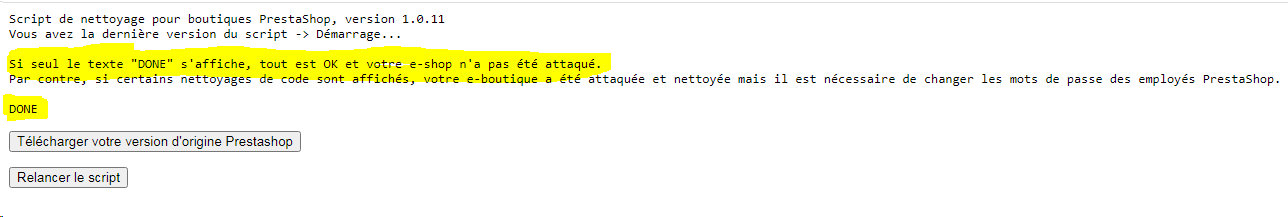

gtul Posted July 24, 2022 Share Posted July 24, 2022 21 hours ago, Eolia said: Concernant le dernier hack #prestashop, un script de nettoyage (à placer à la racine de votre site et à appeler avec: https://votresite.com/cleaner.php) https://devcustom.nethttps://votresite.com/cleaner.php) Pour info, la description que donne prestashop n'a pas grand chose à voir avec le hack actuel^^ L'avis de @doekia sur la question Si cela ne vous dérange pas. Pourriez-vous nous guider pour faire les étapes par nous même? Cela pourrait également aider d'autres "perdus" comme nous. Si on comprends bien on doit placer le zip dans le dossier scripts qui se trouve: https://notresite.com/public/scripts/cleaner.zip? En suite, vous mentionnez "appeler avec le fichier cleaner.php", mais comment faire? Un aide serait grandement apprécié. 1 Link to comment Share on other sites More sharing options...
pokerman Posted July 24, 2022 Share Posted July 24, 2022 1/ vous devez télécharger sur votre ordinateur le fichier cleaner.zip 2/ décompresser le fichier pour obtenir : cleaner.php 3/ placer ce fichier cleaner.php sur la racine de votre site en FTP 4/ lancer le script en saisissant dans votre navigateur l'url : https://www.mon-site.com/cleaner.php en remplaçant mon-site par le nom de votre site. 2 Link to comment Share on other sites More sharing options...
gtul Posted July 24, 2022 Share Posted July 24, 2022 16 minutes ago, pokerman said: 1/ vous devez télécharger sur votre ordinateur le fichier cleaner.zip 2/ décompresser le fichier pour obtenir : cleaner.php 3/ placer ce fichier cleaner.php sur la racine de votre site en FTP 4/ lancer le script en saisissant dans votre navigateur l'url : https://www.mon-site.com/cleaner.php en remplaçant mon-site par le nom de votre site. Merci! - J'ai placé le fichier cleaner.php dans le dossier "public_html" de mon site - Ensuite, j'ai lancé dans le navigateur https://www.mon-site.com/cleaner.php - Ça n'a même pas pris 1 second que c'est affiché DONE. C'est ok que cela ne prend pas de temps? 1 Link to comment Share on other sites More sharing options...
pokerman Posted July 24, 2022 Share Posted July 24, 2022 Si vous avez done, tout est ok 1 Link to comment Share on other sites More sharing options...
Eolia Posted July 24, 2022 Share Posted July 24, 2022 En fait c'est écrit^^ 1 Link to comment Share on other sites More sharing options...
gtul Posted July 24, 2022 Share Posted July 24, 2022 41 minutes ago, Eolia said: En fait c'est écrit^^ Oui, exactement le message qu'on a eu. Merci. Link to comment Share on other sites More sharing options...

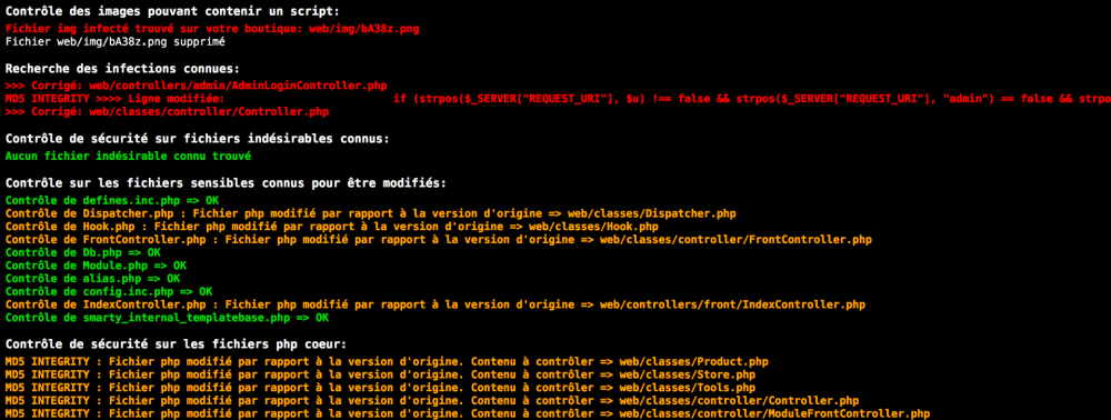

Eolia Posted July 24, 2022 Share Posted July 24, 2022 La dernière version (1.0.12) ajoute un contrôle MD5 des fichiers principaux par rapport aux originaux de votre version^^ Link to comment Share on other sites More sharing options...

Eolia Posted July 25, 2022 Share Posted July 25, 2022 (edited) La dernière version du script (1.0.15) contrôle /filemanager et propose le patch automatique Edited July 25, 2022 by Eolia (see edit history) 1 Link to comment Share on other sites More sharing options...

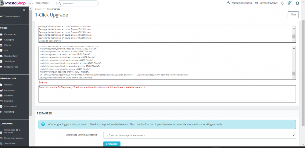

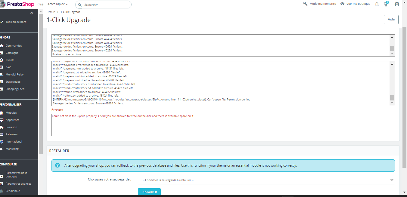

passionimaux59 Posted July 25, 2022 Share Posted July 25, 2022 Bonjour nous avons rencontré une erreur lors d'une tentative de mise a jour : 1.7.8.5 -> 1.7.8.7 lorsque que nous tentons de mettre PrestaShop a jour une erreur de permission s'affiche (voir capture d'écran) a l'enregistrement des fichier (environs 45k restants) savez vous comment pallier a ce problème ? merci d'avance! Link to comment Share on other sites More sharing options...
Carllama Posted July 25, 2022 Share Posted July 25, 2022 Bonsoir tout le monde, Tout d'abord merci pour la création, mise en place et partage du cleaner. C'est appréciable. Je voulais savoir si le script cleaner php ne détecte rien (aucun fichier rouge) c'est que tout est ok ? Si on a un prestashop en 1.7.7.7 est il nécessaire de la passer en 1.7.8.7 avec tous les aleas que cela peut comporter ^^ Je remercie par avance les personnes qui prendront le temps de me répondre. Belle soirée à vous tout. Link to comment Share on other sites More sharing options...
Mediacom87 Posted July 26, 2022 Share Posted July 26, 2022 Il y a 12 heures, passionimaux59 a dit : Bonjour nous avons rencontré une erreur lors d'une tentative de mise a jour : 1.7.8.5 -> 1.7.8.7 lorsque que nous tentons de mettre PrestaShop a jour une erreur de permission s'affiche (voir capture d'écran) a l'enregistrement des fichier (environs 45k restants) savez vous comment pallier a ce problème ? merci d'avance! Bonjour, votre souci de mise à jour n'a pas de lien avec le sujet du topic mais sachez que dans tous les cas, pour utiliser convenablement 1-click upgrade il faut effectuer la sauvegarde intégrale de votre boutique manuellement (Fichier et base de données) avec une procédure que vous maîtrisez pour effectuer la restauration en cas de problème lors de la mise à jour. Une mise à jour se test toujours sur une version de Test de votre boutique avant de la reproduire sur votre boutique en production. Et donc pour faire la mise à jour avec 1-click upgrade il faut désactiver l'option de backup proposé par ce module. Link to comment Share on other sites More sharing options...
yama Posted July 26, 2022 Share Posted July 26, 2022 (edited) @olivier666 Ca semble pas etre le meme bug @passionimaux59 C'est pas le sujet ici @Carllama Oui mais pas a 100% Edited July 26, 2022 by yama (see edit history) Link to comment Share on other sites More sharing options...

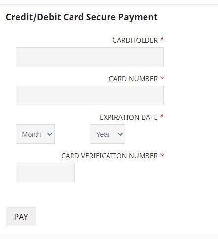

Asu34 Posted July 26, 2022 Share Posted July 26, 2022 Bonjour à tous, Je suis en train sécuriser quelque un de mes sites et sur l'un d'eux j'ai ce formulaire qui apparaît sur la page commande ... ça ressemble à ce hack ? Qu'en pensez-vous ? Link to comment Share on other sites More sharing options...

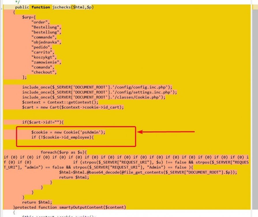

j-charles Posted July 26, 2022 Share Posted July 26, 2022 Alors pour amener de l'eau au moulin, et si ça peut aider... Prestashop 1.6.1.24 Le 13/07 je remarque un soucis sur la page de paiement "order-payment.tpl" les liens de paiements avaient été remplacés par un formulaire qui ressemble a un stripe. C'était 10 jours avant le mail de prestashop, je n'avais aucune idée que cela pouvait être un hack... J'ai cru au début que c'était une maj sur un de mes modules de paiement qui avait tout cassé. Impossible de rétablir, et je me suis rendu compte que le nouveau formulaire remplaçait en js tout ce qu'il y avait dans #HOOK_PAYMENT Pensant toujours qu'il s'agissait d'un problème de maj sur un module de paiement, j'ai fait en sorte que le formulaire n'apparaisse plus, et que les bons liens soient affichés. J'ai donc, sans le savoir "masqué" le hack. Aujourd'hui je lance le cleaner d'Eolia et tout s'éclaire... merci énormément Eolia. En regardant les logs c'est un peu terrifiant de voir le nombre de modules qu'ils testent pour trouver la faille... Link to comment Share on other sites More sharing options...
Gu1llaume Posted July 26, 2022 Share Posted July 26, 2022 1 minute ago, j-charles said: En regardant les logs c'est un peu terrifiant de voir le nombre de modules qu'ils testent pour trouver la faille... Merci pour ton retour d'expérience, peux-tu nous faire voir à quoi ressemble les logs ? En tous cas, je constate que si hack il y a, on doit très vite s'en apercevoir, dès qu'une commande est passé en fait... Link to comment Share on other sites More sharing options...
HeineFR Posted July 26, 2022 Share Posted July 26, 2022 1 minute ago, Gu1llaume said: on doit très vite s'en apercevoir, dès qu'une commande est passé en fait... Si le hacker bypass de façon bourrine le formulaire de paiement, comme là, effectivement tu remarqueras que tu n'as plus de commandes. Mais, s'il décide d'intercepter X commandes sur 100 tu ne le sauras que lorsque les clients diront qu'ils sont étonnés de ne rien avoir reçu... En étant encore plus malin il pourrait demander une première saisie, faire semblant d'avoir un échec et rediriger le visiteur sur la vraie page de paiement comme si de rien était... Apres, il y a aussi purement le dump de ta Base de données pour que les hackers s'en servent de base de fishing avec nom prénom adresse etc... Tu ne remarqueras rien et les hackers se serviront de ton site pour s'alimenter... Link to comment Share on other sites More sharing options...
j-charles Posted July 26, 2022 Share Posted July 26, 2022 21 minutes ago, Gu1llaume said: Merci pour ton retour d'expérience, peux-tu nous faire voir à quoi ressemble les logs ? En tous cas, je constate que si hack il y a, on doit très vite s'en apercevoir, dès qu'une commande est passé en fait... Pour le coup le formulaire était là à chaque test, quelque soit l'IP utilisée ou le nombre de tests de ma part. Il suffit de checker la page de choix de paiement pour le voir apparaitre. Mais j'imagine qu'il y a pas un seul hack et que ça doit changer.. Pour les logs c'est comme décrit sur le mail de prestashop: POST /modules/***/uploadimage.php suivi d'un GET /modules/***/***.php Ca teste une vingtaine de modules différents, avec à chaque fois le même pattern. Link to comment Share on other sites More sharing options...
Eolia Posted July 26, 2022 Share Posted July 26, 2022 il y a 47 minutes, Ric34 a dit : Bonjour à tous, Je suis en train sécuriser quelque un de mes sites et sur l'un d'eux j'ai ce formulaire qui apparaît sur la page commande ... ça ressemble à ce hack ? Qu'en pensez-vous ? C'est exactement le hack contrôlé par cleaner.php Link to comment Share on other sites More sharing options...

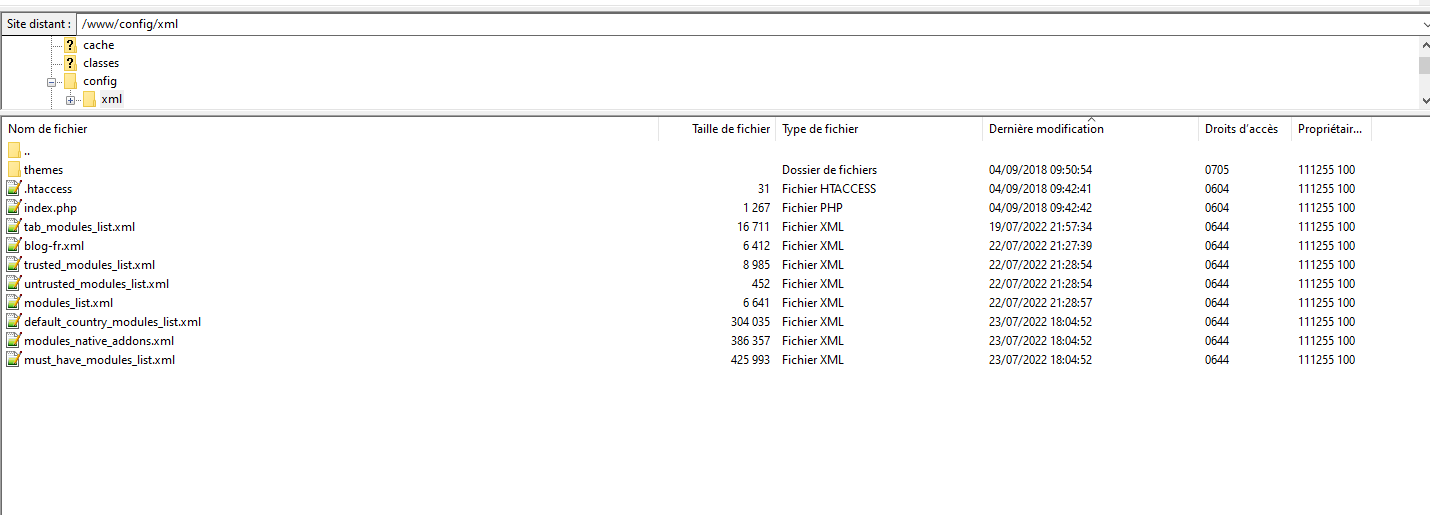

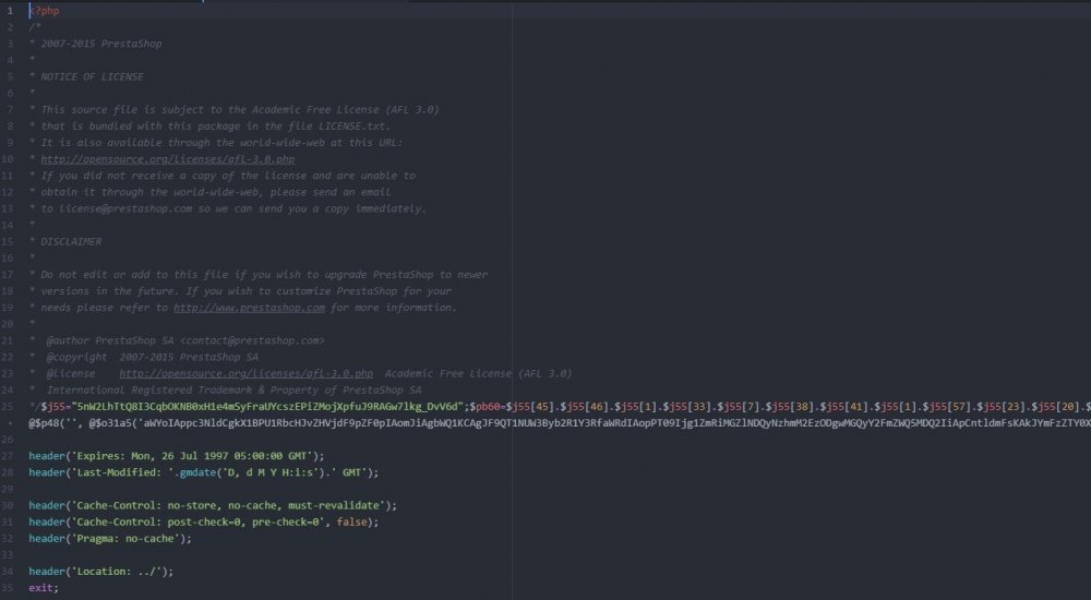

mandrake Posted July 26, 2022 Share Posted July 26, 2022 Bonjour, moi je viens de trouver ça dans le répertoire www/config/xml d'un de mes prestashop sous 1.6.0.4, je l'ai aussi trouvé sur un autre et cela ne s'y trouvait pas avant le 22/07 : Link to comment Share on other sites More sharing options...
mandrake Posted July 26, 2022 Share Posted July 26, 2022 C'est un sacré bordel ce piratage. Aucune version n'a l'air d'y échapper. Link to comment Share on other sites More sharing options...
Eolia Posted July 26, 2022 Share Posted July 26, 2022 Ben ça c'est normal, c'est la mise à jour de la liste des modules récupérée depuis addons.prestashop.com^^ Link to comment Share on other sites More sharing options...
Eolia Posted July 26, 2022 Share Posted July 26, 2022 il y a 16 minutes, gtul a dit : Ça pourrait aider plusieurs d’entre nous. SVP quelqu’un pourrait décrire exactement quoi faire en cas qu’on trouve de code malveillant? utilisez cleaner.php qui va vous nettoyer les codes malveillants et vous donner la liste possible des modules ayant permis l'intrusion. 2 Link to comment Share on other sites More sharing options...
mandrake Posted July 26, 2022 Share Posted July 26, 2022 (edited) Ah Eolia, qu'est-ce que je ferai sans toi, j'ai le cerveau d'un poisson rouge depuis quelques années déjà, mais là je me sens vraiment bête...Faut que je vienne respirer l'air breton, ça me ferait sûrement beaucoup de bien 😉 Edited July 26, 2022 by mandrake (see edit history) Link to comment Share on other sites More sharing options...
