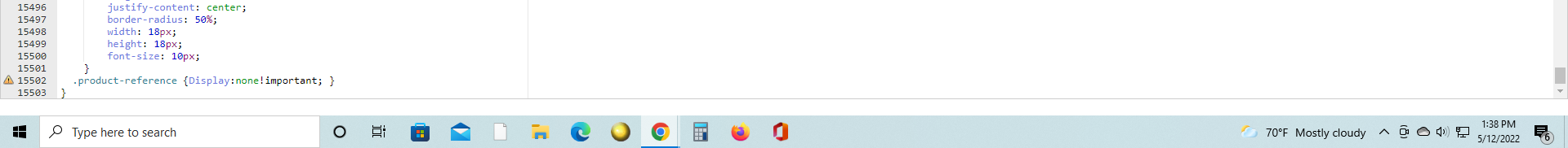

11 hours ago, delconick said:
Here is the bottom of theme.css
Please place it at the very end, also can you Disable backoffice>advance parameters>performence > "Smart cache" for style sheets (CSS)" and then clear cache. so that way i will be able to see exact location of where to place the code.
