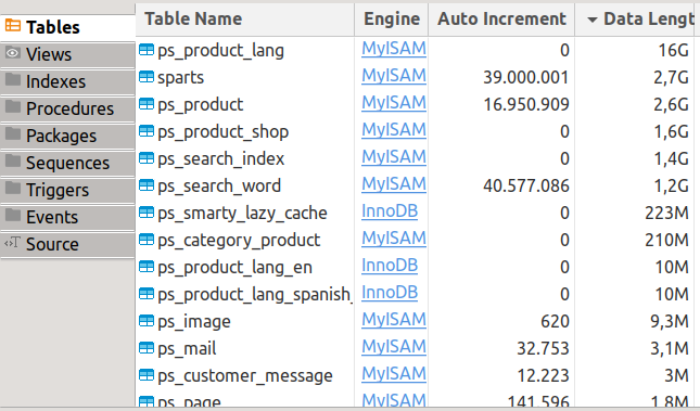

Forgot to mention I already look at that, our bigger tables are not from statistics, are from products: product_lang, sparts, product, product_shop, search_index and search_shop are with difference the biggest tables.

Table sparts is not native so you can check is this from some module or script, maybe it is not relevant for shop.
The shop has more tan 17.000.000 products.
About sparts table, it's from a custom module.

The last instruction logged was an ALTER TABLE on a 2,6G table:
[2022-03-22 13:14:50] <div class="upgradeDbOk">[OK] SQL 1.7.0.0 ALTER TABLE `ps_product` CHANGE `available_date` `available_date` DATE NULL DEFAULT NULL</div>
[2022-03-22 13:17:22] <div class="upgradeDbOk">[OK] SQL 1.7.0.0 ALTER TABLE `ps_product` ADD `show_condition` TINYINT(1) NOT NULL DEFAULT '0' AFTER `available_date`</div>
So, probably it's gonna be easier to start with a clean site and export the data from the 1.6 shop and import it on the new site.
