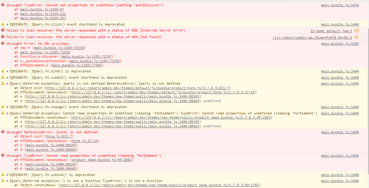

  • if i keep the "_PS_MODE_DEV_" param to true, i have this error trying to access my Front Office : "Notice: Undefined offset: 0 in ImageRetriever.php line 305" Any idea ?
  • if i turn it to "false", i can access my Front Office, but i have no product images. I don't know why. (it works fine if i don't install the dev version)

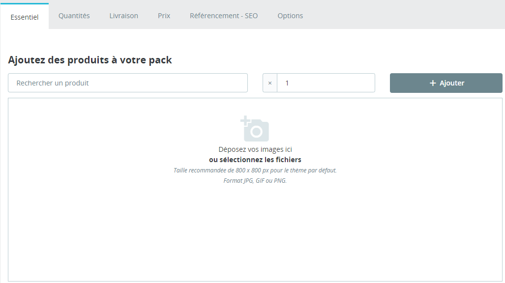

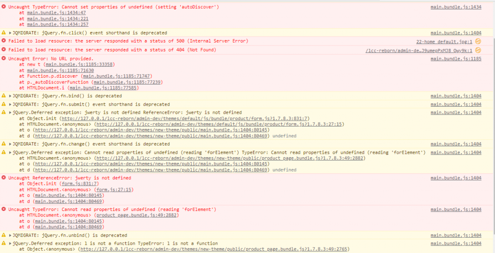

  • in my Backoffice, i can't add "Images" to my products, check the first screenshot above. I have a lot of javascript errors in my console (please check the second screenshot) , and i think there is a link between these problems, but i can't solve it.
At this point, i'm stucked with these images problems and i can't go ahead because maybe there is a lot more problems i did not notice yet. I have to be confident about the initialisation of the project because it will be a long long long development task, so if any of you can help me, i would be very very grateful.

okay so i followed the advices of a mate on slack, and set up a working Debian virtual machine to check if the problem was Windows, and it was ...
The build now works.
