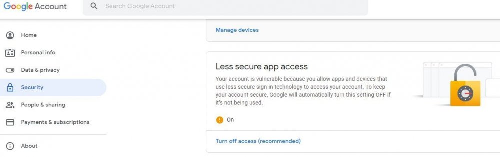

Gmail security is set to less secure app enabled.

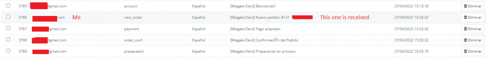

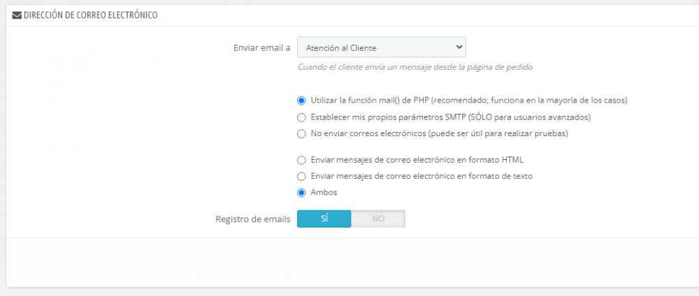

Hi guys. I managed to change the settings from SMTP to PHP (check image). It's working fine apparently, but the issue that I'm getting right now is that some emails that are supposed to be sent and seen in the "Sent" folder of Gmail, aren't there.
I See the New Order Email and the emails from the contact form: Customer Support and Webmaster contact.
I don't see anymore, Order Confirmation, Cancel Order email, Order Preparation, etc...
If I check the platform, they were supposed to be sent:
Any ideas?
Thanks in advance.
Regards.-
