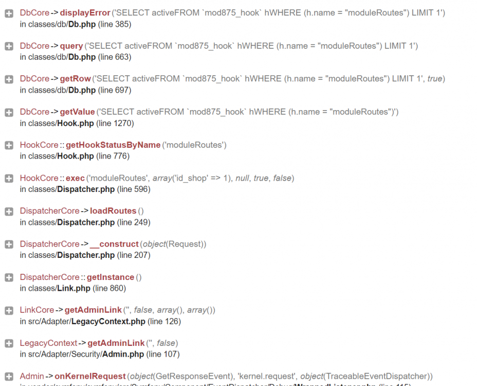

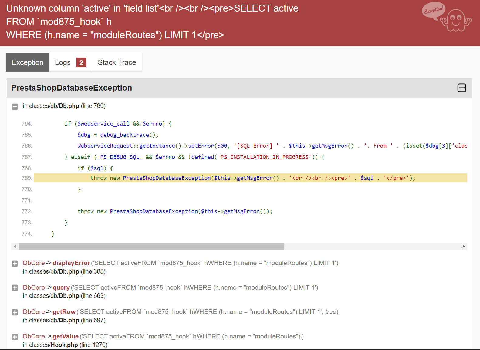

dap1234 Posted January 8, 2022 Share Posted January 8, 2022 (edited) Hello, I am not a skilled PS user at all. I have tried to autoupgrade my shop (from 1.7.5.2 version /php7.2) and now I can`t login (login screen in loop). During upgrade I have noticed couple error warnings. Finally, it looks like all is finished..? and I refreshed tab (to early?). In debug mode I can see some error lines saying installation in progres or so. Please help me with this. I tried google my problem but nothing seems to work for me. I post some screenshots. Let me know if you need anything else from me to investigate this. Thank you ps. I did full PS backup from server using ftp Edited January 19, 2022 by dap1234 extra info (see edit history) Link to comment Share on other sites More sharing options...
Rhobur Posted January 9, 2022 Share Posted January 9, 2022 There is no column 'active' in the hook table nor there was in the 1752. You need to investigate where this is called from, probably a module and uninstall it. Link to comment Share on other sites More sharing options...

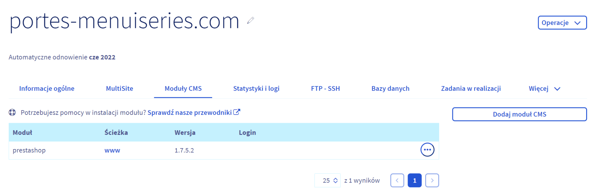

dap1234 Posted January 9, 2022 Author Share Posted January 9, 2022 (edited) 18 hours ago, Rhobur said: compare your modules folder with the one from the prestashop archive (download it if you don't have it already) then rename one by one the extra modules in your folder (not in the archive) and test if the problem is gone after each rename; when you find the culprit rename back the others. did that, still same problem In my hosting panel, under CMS tab, it says installed PS ver. 1.7.5.2. Shouldnt be 1.7.8.2 after upgrade? Edited January 10, 2022 by dap1234 (see edit history) Link to comment Share on other sites More sharing options...

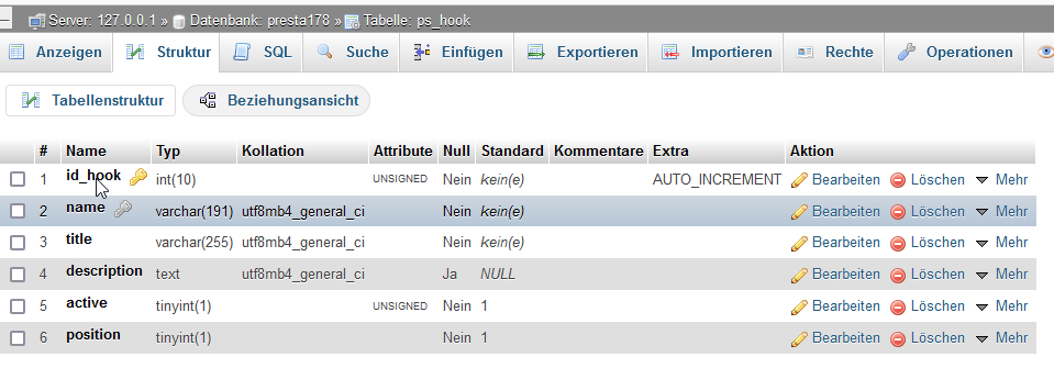

JBW Posted January 11, 2022 Share Posted January 11, 2022 On 1/9/2022 at 9:02 AM, Rhobur said: There is no column 'active' in the hook table nor there was in the 1752. I see active column in my 178 install. Guess this is missing here and should be added ALTER TABLE `mod875_hook` ADD `active` TINYINT UNSIGNED NOT NULL DEFAULT '1' AFTER `description`; Link to comment Share on other sites More sharing options...

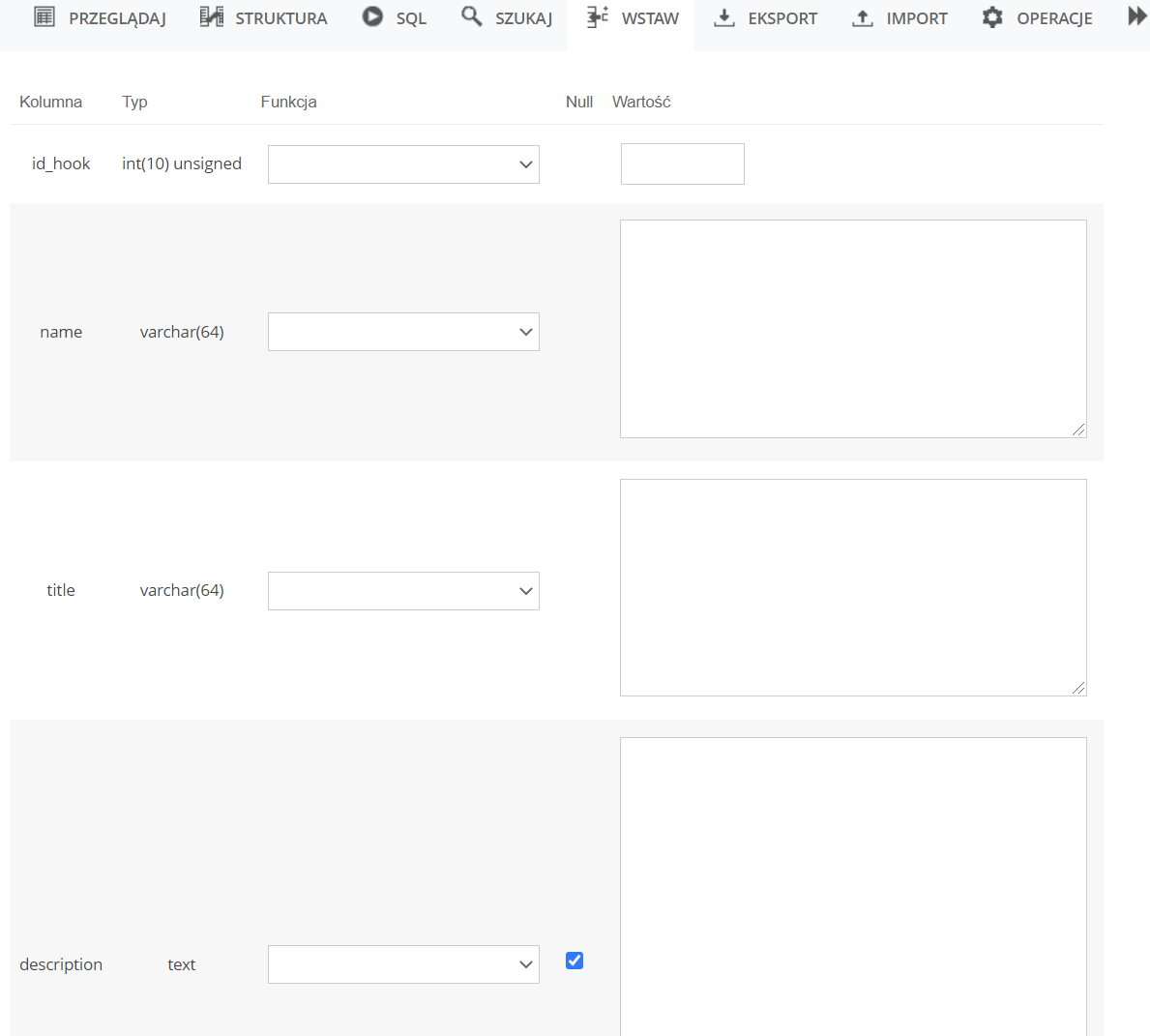

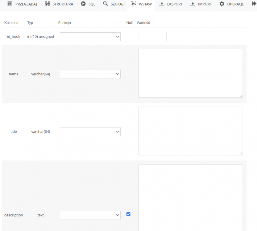

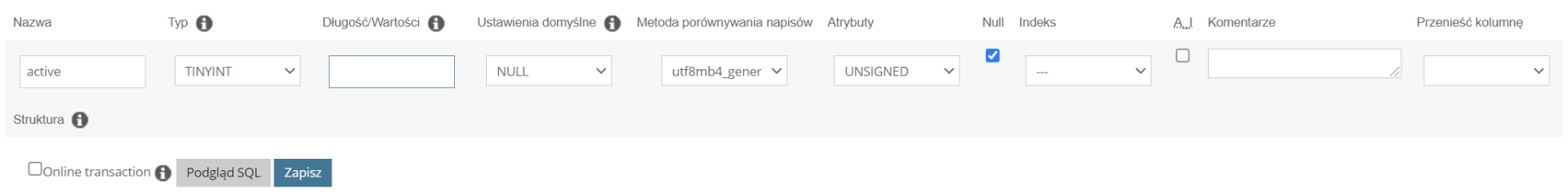

dap1234 Posted January 11, 2022 Author Share Posted January 11, 2022 46 minutes ago, JBW said: I see active column in my 178 install. Guess this is missing here and should be added ALTER TABLE `mod875_hook` ADD `active` TINYINT UNSIGNED NOT NULL DEFAULT '1' AFTER `description`; Yes, one line is missing (active). Now, when i click ADD it sending me to this screen (bare in mind, I`m completely rookie with this and I dont want to do even bigger mess). Which fields I should fill? Thanks Link to comment Share on other sites More sharing options...
JBW Posted January 11, 2022 Share Posted January 11, 2022 You can use the SQL I posted. Don't use the "add row" function, you need to go to "structure" and add a new column there. Link to comment Share on other sites More sharing options...

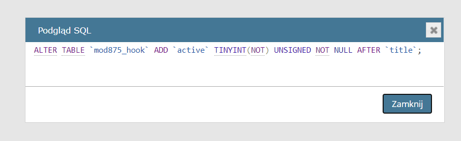

dap1234 Posted January 11, 2022 Author Share Posted January 11, 2022 (edited) is that correct or something is still missing? trying diffferent combinations to get same column as yours Edited January 11, 2022 by dap1234 (see edit history) Link to comment Share on other sites More sharing options...
JBW Posted January 11, 2022 Share Posted January 11, 2022 (edited) I have it after description, not after title and default value 1 Edited January 11, 2022 by JBW (see edit history) Link to comment Share on other sites More sharing options...
dap1234 Posted January 11, 2022 Author Share Posted January 11, 2022 Thanks. It seems that error gone. I had another one with database connection. I sorted this out. Now I see login screen but it stuck in loop. In Dev mode when I try to log in I get white screen in the middle after login. Should I delete cache from the VAR directory? Really appreciate your help @JBW Link to comment Share on other sites More sharing options...

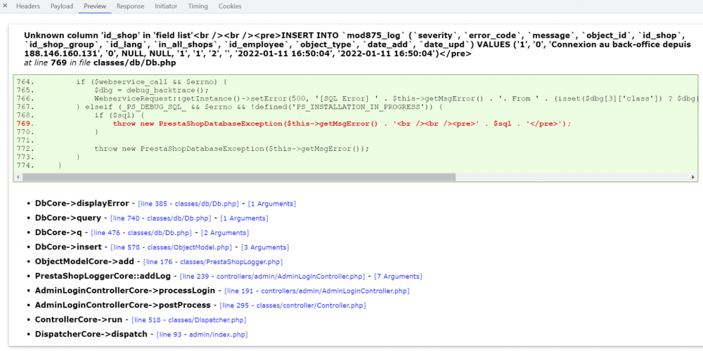

dap1234 Posted January 11, 2022 Author Share Posted January 11, 2022 (edited) 38 minutes ago, JBW said: Check for XHR errors in browser console I do have one error. Not sure if this is safe to copy here so short version below jquery-3.4.1.min.js:2 POST https://portes-menuiseries.com/admin******* 500 Edited January 11, 2022 by dap1234 (see edit history) Link to comment Share on other sites More sharing options...
JBW Posted January 11, 2022 Share Posted January 11, 2022 With activated debug mode you will see the error details in the XHR answer tab Link to comment Share on other sites More sharing options...
dap1234 Posted January 11, 2022 Author Share Posted January 11, 2022 Link to comment Share on other sites More sharing options...

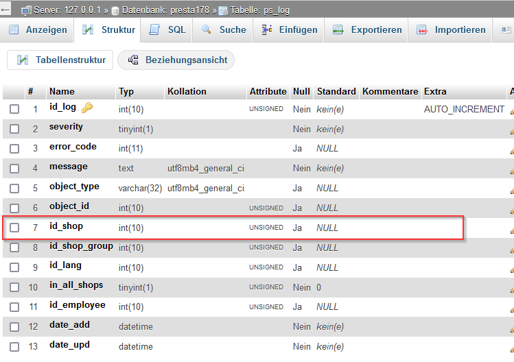

JBW Posted January 11, 2022 Share Posted January 11, 2022 You are missing more DB fields (id_shop in table mod875_log in this case), there seems to be something really wrong. You can continue to add them one by one but there will be still risk of future errors or inconsistencis Link to comment Share on other sites More sharing options...

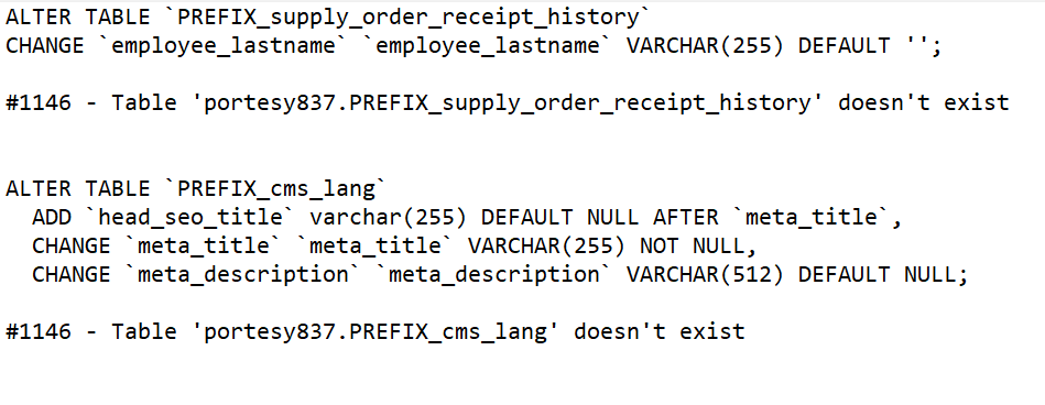

JBW Posted January 11, 2022 Share Posted January 11, 2022 By the way, in folder /modules/autoupgrade/upgrade/sql you can find all the SQL statements that were supposted to be executed during upgrade. If you can't go for a restore I would check these and apply to your DB manually if required, these are not so many coming from 1.7.5 1 Link to comment Share on other sites More sharing options...
dap1234 Posted January 11, 2022 Author Share Posted January 11, 2022 (edited) got some errors on this forum aswell "error 1020" not even funny ok, back to the topic after I add two 1.7.5. files from upgrade/sql directory this error got on my screen now I will install PS 1.7.8.2 on localhost tomorrow morning and see whats missing in tables. Does it sound like a good idea? What if all fail? Will I have problems to restore my shop to the state before an upgrade? Edited January 11, 2022 by dap1234 (see edit history) Link to comment Share on other sites More sharing options...
