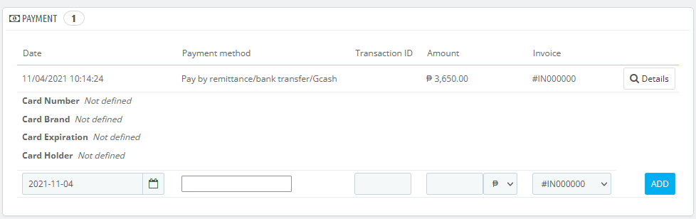

bnadauld Posted November 4, 2021 Share Posted November 4, 2021 is it the same issue im having - where i need to correct a payment (see pic) by deleting it and adding a new one? Link to comment Share on other sites More sharing options...
