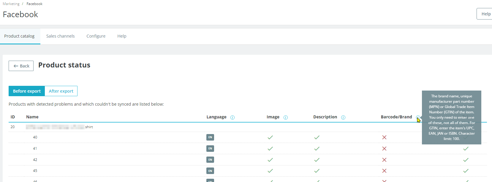

Good morning
I have in my prestashop store 1.7.8.5 --> 28059 products.
but I have problems with the feeds
facebook
When I try to export them to fb of the 28059 selects 13000 and after errors finally imports 9800.
When viewing the feed it gives this error message:
XML reading error: text or XML declaration in a place other than the beginning of the entity.
Location: https://recitoners.net/facebookproductad66b4bcb97b0d361556a093c7e1b1742f.es.shop1.xml
Line number 18864, column 1:
<?xml version="1.0" encoding="UTF-8"?>
in google the situation is as follows
I don't know how it creates 81247 of which it approves 21256
in some rejected products it says that it does not have for example title in this product image.png.7cb4be71054b849e197ae7cc7295d99d.png70.127
but actually it does and it is this
https://recitoners.net/inicio/4031270-8435532912705-filamento3d-pla-hd-1270-azul-interferencia-bobina-de-300-8435532912705
