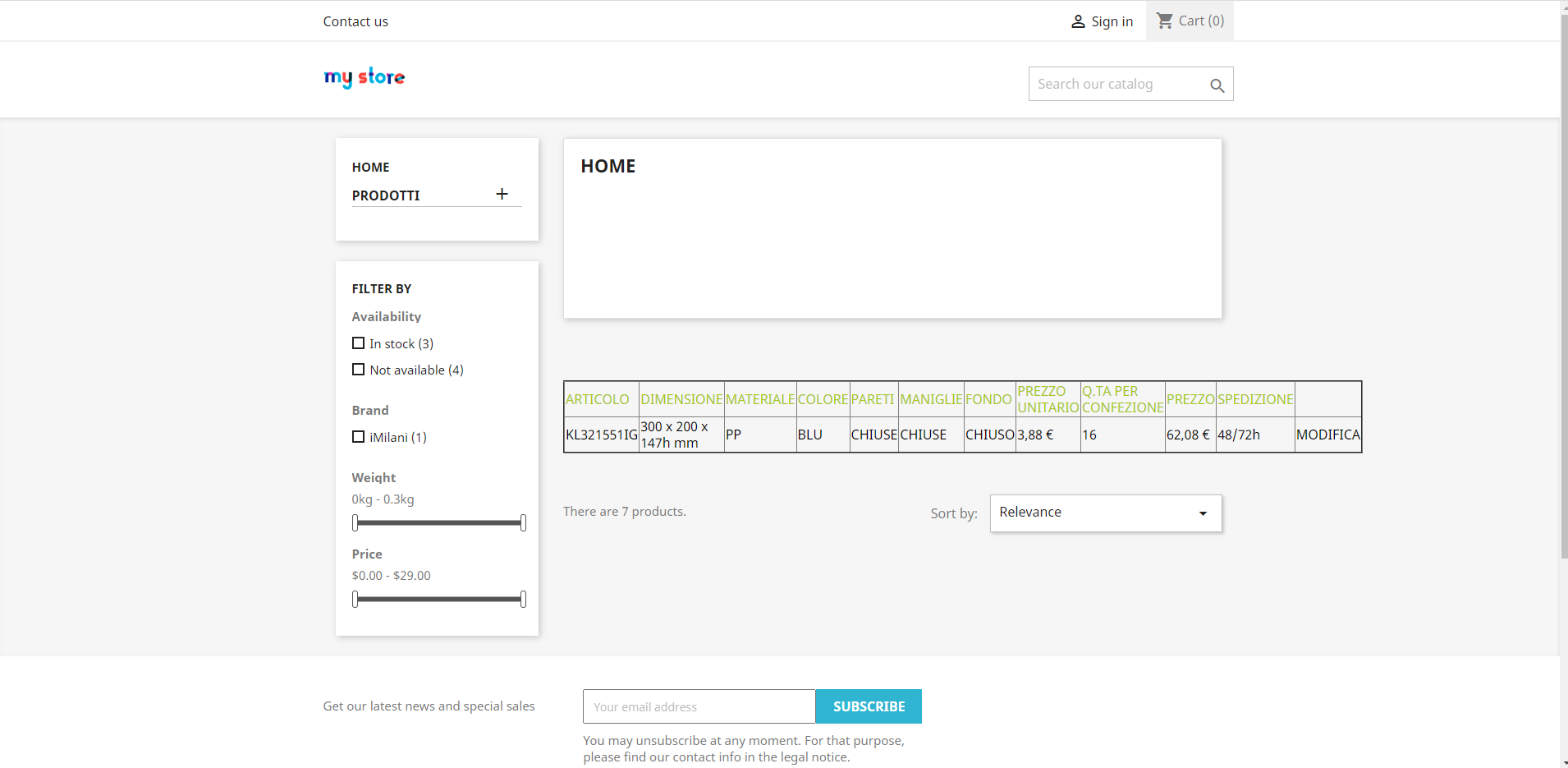

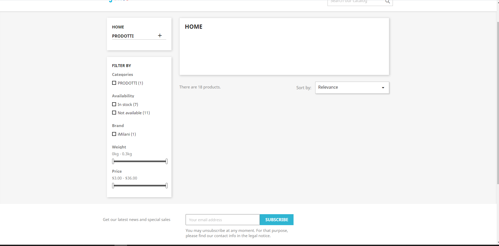

Hello everyone!!
Browsing my test shop in Prestashop, until yesterday, clicking on "All products" in the product showcase made me a list of all the products.
This morning, always clicking on "All products" makes me enter the "HOME" category but without any product list.
Would anyone know how to help me ?? Below I leave an image so as to better understand the situation.
Thanks in advance for who will answer.

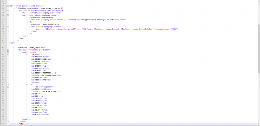

@SmartDataSoft
The only change I made was in the "Category-header.tpl" file, but that's not what gives me the problem.

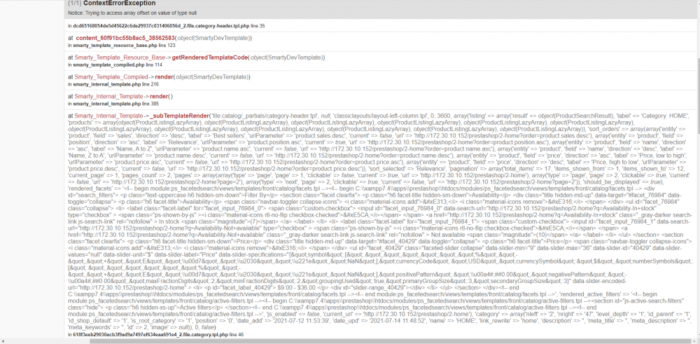

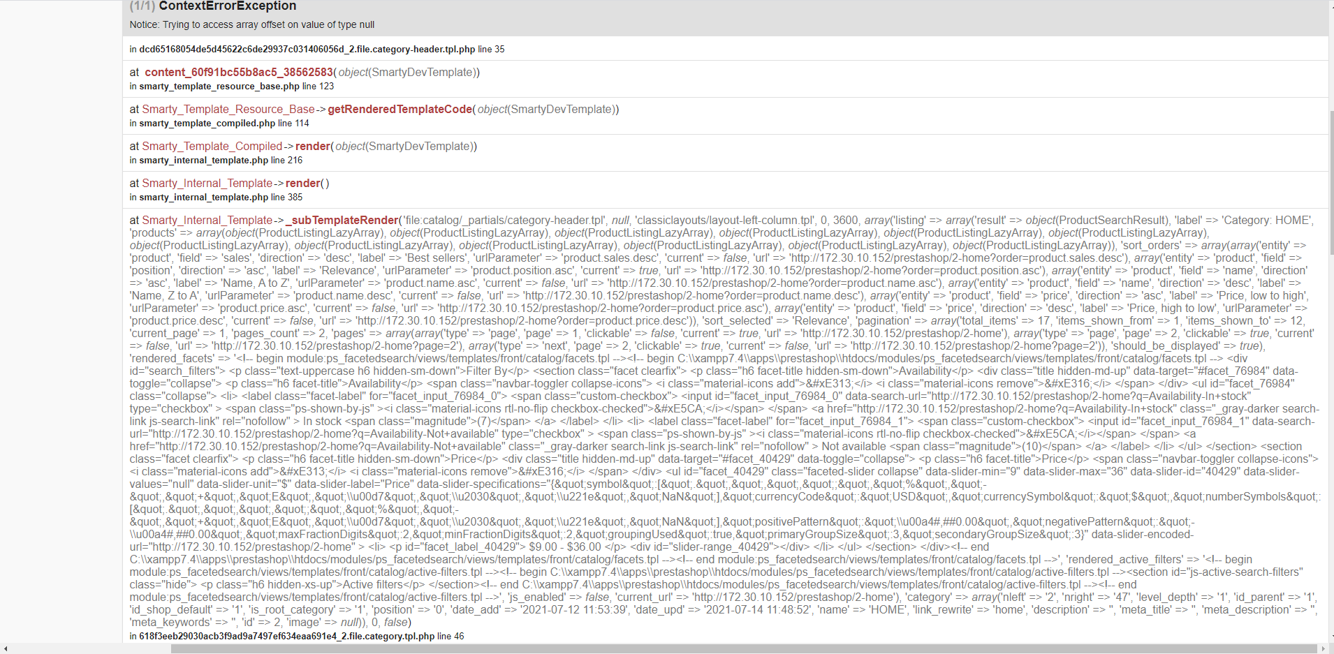

I activated the debugger as recommended and doing the action that gives me problems gives me the error you see in the image below.
(Unfortunately I still don't have this knowledge from understanding something, by any chance would you be able to help me? I would be grateful)
Share this post
Link to post
Hello, the error indicate that you try to access a value is is null . You need to check null value  line 35 of your  Category-header.tp
Null value handel will prevent this. So when value got they will work other wise not.
{if !($array|is_empty)}
  Array is not empty
{else}
  Array is empty
{/if}
Thank you

I put isset() to line variable 35, but it didn't solve, did I write wrong ??
{if isset($category.image.large.yrl)}

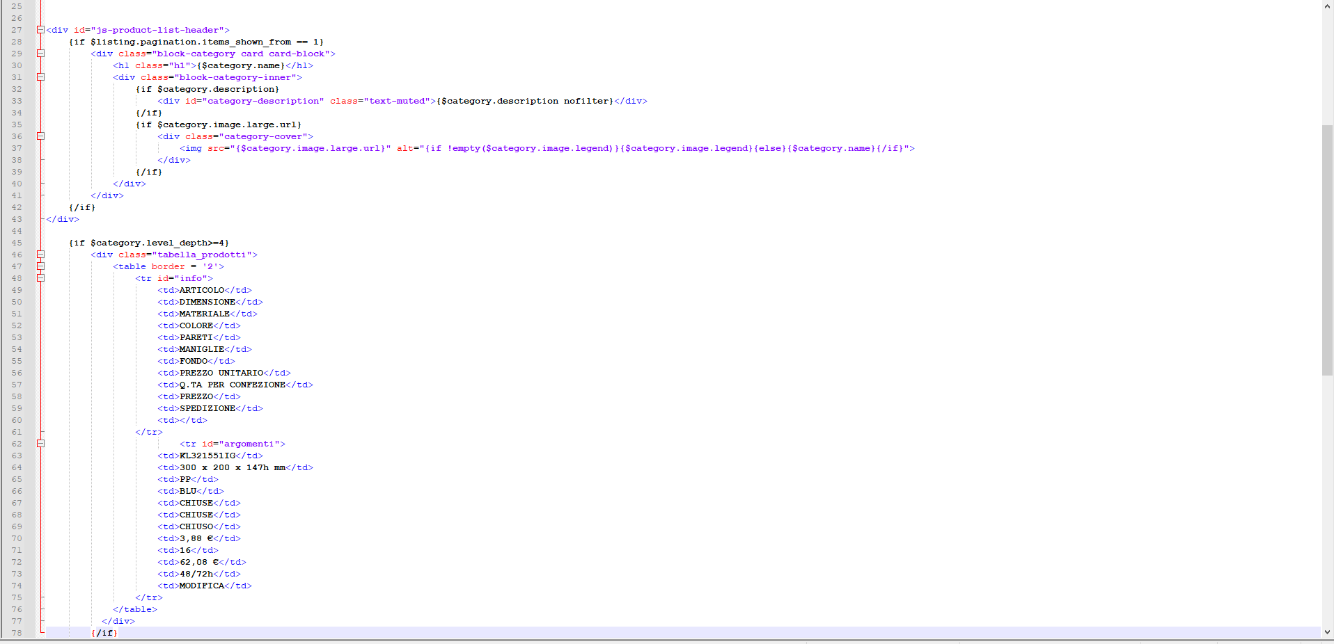

It is not solved, but if it hits the if loop I should replace it with a foreach loop, as the subcategories are not always 4, so I would like it to count the subcategories and when I reach the last one, print the table.
I would have asked in yesterday's discussion, but since it came out in this one, I take advantage of it.
But I've already tried doing a foreach loop, but it doesn't work for me
