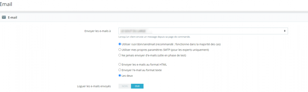

chti56 Posted July 10, 2021 Share Posted July 10, 2021 On a site which was in PS 1.6.6 and which has now switched to PS 1.7.7.1, the owner of the site notes that when placing an order, she does not receive any alert message. Site hosted by OVH. I have checked the settings and it seems correct to me. However in the previous version of PS one PHP mode to send messages whereas now it is completely different. See attached file. Could the problem be with the new protocol used for sending messages? Otherwise, how to use (configure) the sending of messages using SMTP? Thanks for your help. Link to comment Share on other sites More sharing options...
Crezzur.com Posted July 10, 2021 Share Posted July 10, 2021 Did you try a few sections below your printscreen the test email part? Does this work? In mail alert, are your sure the email is filled in their? (just to be sure) Link to comment Share on other sites More sharing options...
