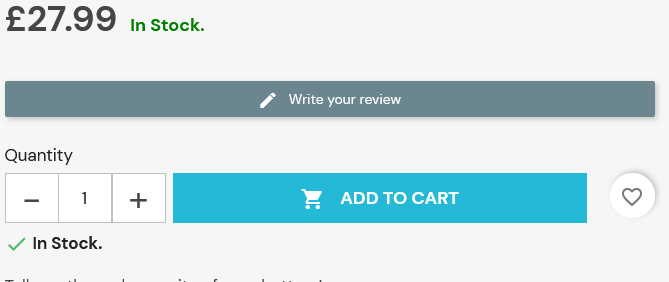

MerseyRay Posted May 17, 2021 Share Posted May 17, 2021 (edited) Hi, The buttons in the vertical group up/down for the qty required are not very mobile friendly. Ive looked in the "add-to-cart.tpl" and they are not in there, it seems they appear via javascript code. Where is this code, and is it safe to remove and just place bigger buttons before (-) and after (+) the qty field in the "add-to-cart.tpl" instead. Im after making the buttons like this image so they are better for mobile use. Thanks Edited December 6, 2023 by MerseyRay Marked as solved (see edit history) Link to comment Share on other sites More sharing options...

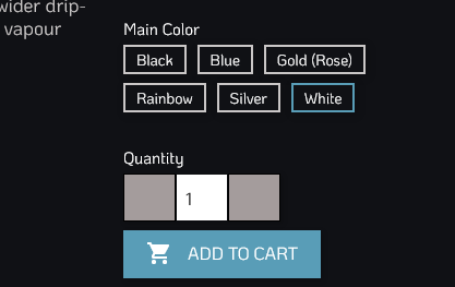

MerseyRay Posted June 16, 2021 Author Share Posted June 16, 2021 (edited) OK, so I have got this far by changing css. I notice that the code is in the theme.js file and is here can this code be removed and just place these buttons in the add-to-cart.tpl ? Or is there a reason for having to add some simple buttons via use of js ? Thanks in advance Edited June 16, 2021 by MerseyRay (see edit history) Link to comment Share on other sites More sharing options...

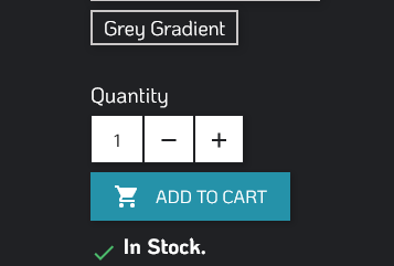

MerseyRay Posted December 6, 2023 Author Share Posted December 6, 2023 (edited) Ok, so Ive just had another go at this. I examined the theme.js from another theme which has the buttons I wanted. There are 4 instances of "verticalbuttons: !1", you need to change that to "verticalbuttons: !0" I have then just done some basic css to get this look for the product page The css I used is .product-quantity .qty .input-group { display: flex; } .product-quantity .input-group .input-group-btn > .btn-touchspin { border: thin solid #bfbfbf; color: var(--nwe_darkgrey); width: 3rem; height: 2.75rem; font-size: 2rem; font-weight: 100; padding: 0; justify-content: center } .product-quantity #quantity_wanted { text-align: center } You will then need to do some css for the +/- in the cart as the js changes that too, but the above css is just for the product page. You can see mine in action on my wip site at https://wip.northwestecigs.uk/batteries/481-xtar-x4-battery-charger.html This seems to work fine for me. Im not sure if its the correct method.. maybe it can be done somehow with an override because after updating your store you will need to make the alterations to the theme.js again. Hope this helps Edited December 6, 2023 by MerseyRay (see edit history) Link to comment Share on other sites More sharing options...
