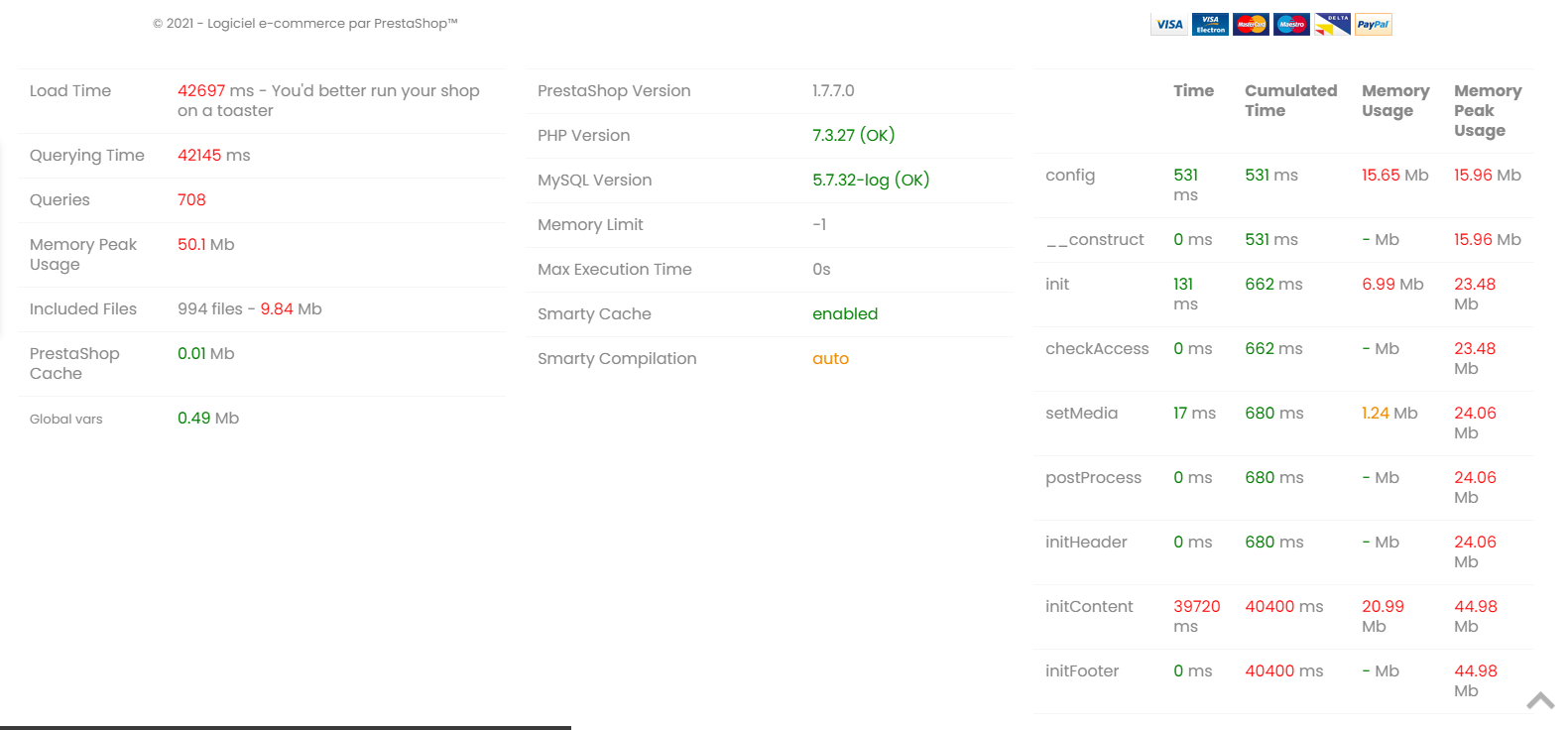

kate66 Posted April 21, 2021 Author Share Posted April 21, 2021 Le mode debug est active voici juste une erreur en accueil pour le moment : Notice à la ligne 101 du fichier /xxxxxxx/vendor/symfony/symfony/src/Symfony/Component/HttpFoundation/Session/Storage/Handler/StrictSessionHandler.php [8] SessionHandler::gc(): ps_files_cleanup_dir: opendir(/tmp/.priv) failed: Permission denied (13) Link to comment Share on other sites More sharing options...
kate66 Posted April 21, 2021 Author Share Posted April 21, 2021 les infos de la barre debug : Peak memory usage60.5 MB PHP memory limitUnlimited Errors0 Warnings33 Deprecations3 Cache Calls29 Total time1.54 ms Cache hits22 / 27 (81.48%) Cache writes2 Database Queries3 Query time1.25 ms Invalid entities0 Second Level Cachedisabled Total time470 ms Initialization time111 ms Link to comment Share on other sites More sharing options...
Baba deCode Posted April 21, 2021 Share Posted April 21, 2021 C'est ca le mode debug profiling ca permet d'analyser la vitesse et les requetes en base de donnée Link to comment Share on other sites More sharing options...
kate66 Posted April 21, 2021 Author Share Posted April 21, 2021 ca a une incidence sur cote vitrine si j'active cela ? MERCI Link to comment Share on other sites More sharing options...
Baba deCode Posted April 21, 2021 Share Posted April 21, 2021 oui tout a fait mais ca permet de voir le pb Link to comment Share on other sites More sharing options...
kate66 Posted April 21, 2021 Author Share Posted April 21, 2021 a ok quand je le mettrai en false tout redeviendra normal desolé mais j'ai encore des clients consule le site actuellement ? MERCI Link to comment Share on other sites More sharing options...

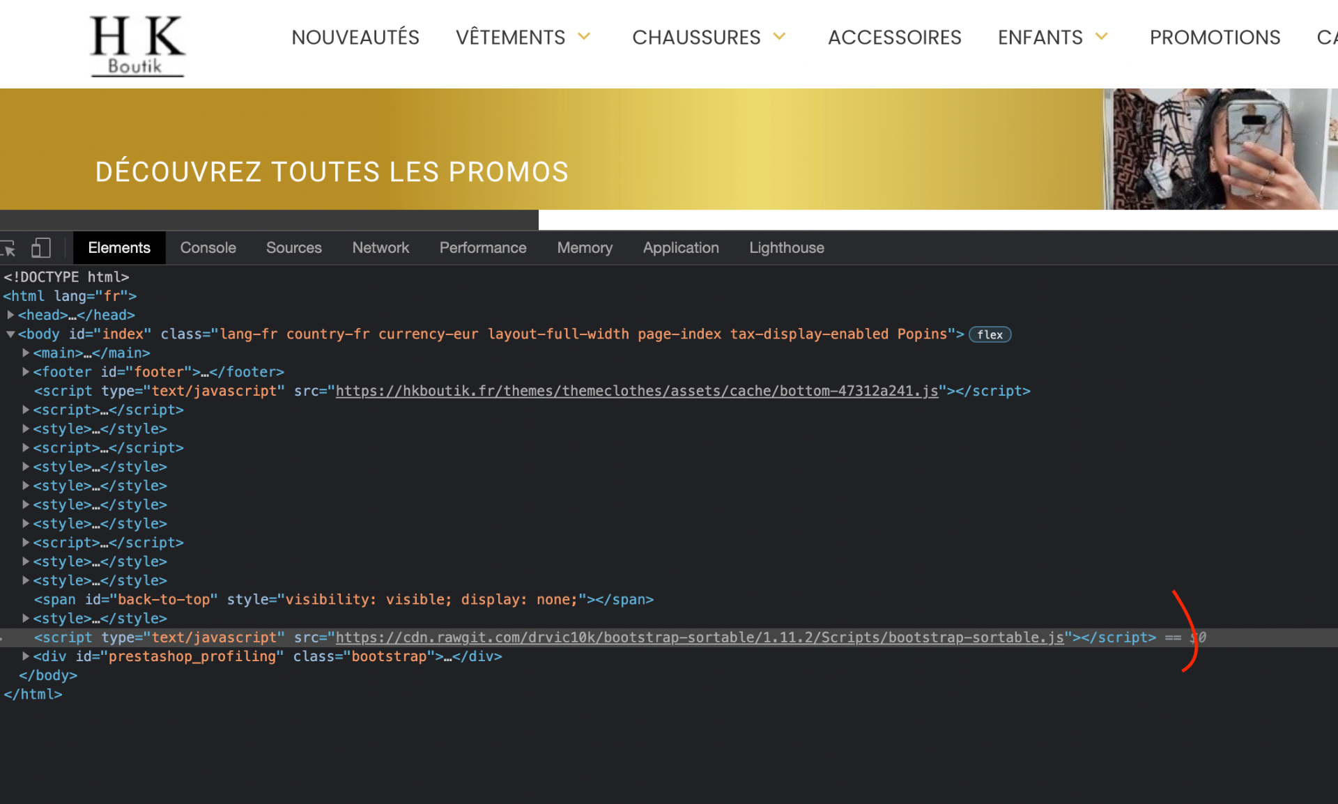

kate66 Posted April 21, 2021 Author Share Posted April 21, 2021 A OK je fais ce qui indiquer dans le lien JE REVIENS de suite MERCI encore Link to comment Share on other sites More sharing options...
Baba deCode Posted April 21, 2021 Share Posted April 21, 2021 Just now, kate66 said: A OK je fais ce qui indiquer dans le lien JE REVIENS de suite MERCI encore par contre y a des petit changement a faire vu que l'article est pour le mode debug et non pas pour le mode debug profiling, par contre c'est le même principe, merci @Mediacom87 Link to comment Share on other sites More sharing options...

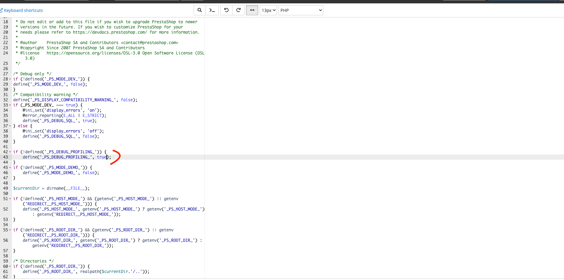

Mediacom87 Posted April 21, 2021 Share Posted April 21, 2021 à l’instant, Alexandre Carette a dit : par contre y a des petit changement a faire vu que l'article est pour le mode debug et non pas pour le mode debug profiling, par contre c'est le même principe, merci @Mediacom87 Comme je disais, c'ets pour aider dans l'idée mais à adapter pour l'appliquer au profiling. Link to comment Share on other sites More sharing options...
kate66 Posted April 21, 2021 Author Share Posted April 21, 2021 que changement pour le mode profiling ? MERCI Link to comment Share on other sites More sharing options...
Baba deCode Posted April 21, 2021 Share Posted April 21, 2021 en toute logique /* Debug profiling replace only */ if (!defined('_PS_DEBUG_PROFILING_')) { if ($_SERVER['REMOTE_ADDR'] == 'votre_IP') { define('_PS_DEBUG_PROFILING_', true); } else { define('_PS_DEBUG_PROFILING_', false); } } Link to comment Share on other sites More sharing options...
kate66 Posted April 21, 2021 Author Share Posted April 21, 2021 c'est fait aucun changement de mon cote avec le code je dois aller quelques part ? MERCI Link to comment Share on other sites More sharing options...
Baba deCode Posted April 21, 2021 Share Posted April 21, 2021 tout en bas de la page, cdt Link to comment Share on other sites More sharing options...

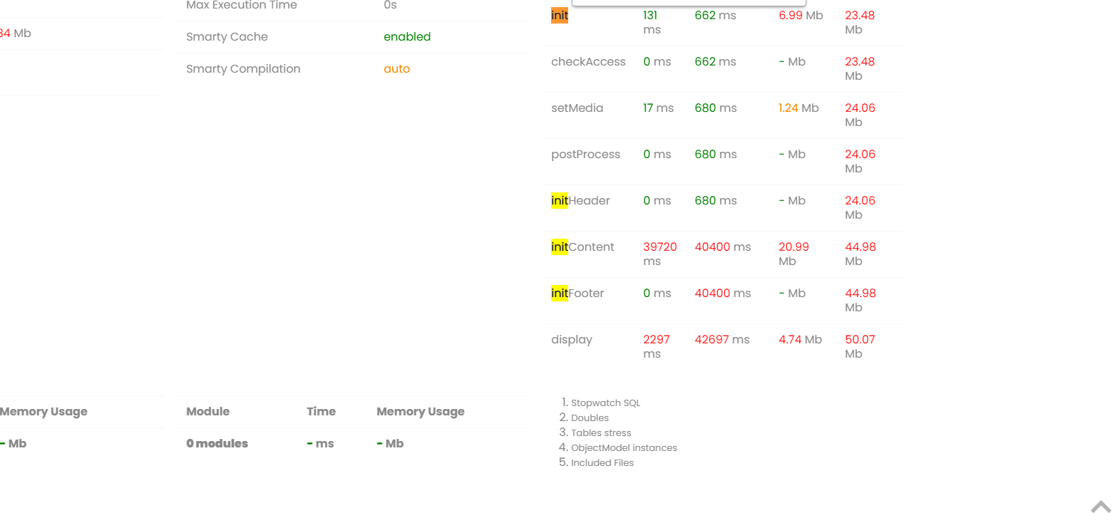

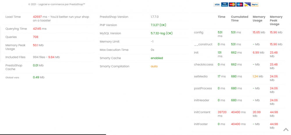

kate66 Posted April 21, 2021 Author Share Posted April 21, 2021 c'est bon ca marche je t'envoi imprim ecran MERCI Ca va de votre cote le mode est pas activé vous voyez pas tout ca rassurer moi ? Comme j'ai encore les clients dessus merci Link to comment Share on other sites More sharing options...

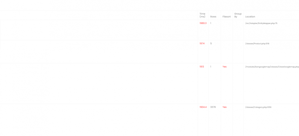

kate66 Posted April 21, 2021 Author Share Posted April 21, 2021 et j'ai plein de requete sql en dessous de tous ca 😅 Link to comment Share on other sites More sharing options...
Baba deCode Posted April 21, 2021 Share Posted April 21, 2021 vous pouvez donc utiliser votre serveur pour faire griller vos tartines.... selon prestashop, pouvez vous screen la requete 'init content', vous descendez et aller tout a droite Link to comment Share on other sites More sharing options...
kate66 Posted April 21, 2021 Author Share Posted April 21, 2021 voici merci encore pour l'aide Link to comment Share on other sites More sharing options...

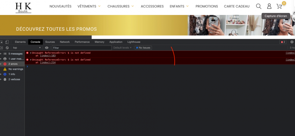

Baba deCode Posted April 21, 2021 Share Posted April 21, 2021 pouvez vous nous montrer avec plusieurs screen ce qu il est marqué dans le details des requetes ? (il faudrait egalement screen tout a droite) Link to comment Share on other sites More sharing options...
Baba deCode Posted April 21, 2021 Share Posted April 21, 2021 ps: on a bien compris qu il y avait un soucis au niveau du initContent, c'est ca qu il faut regarder Link to comment Share on other sites More sharing options...
kate66 Posted April 21, 2021 Author Share Posted April 21, 2021 voici à droite : Link to comment Share on other sites More sharing options...
kate66 Posted April 21, 2021 Author Share Posted April 21, 2021 qu'est ce que c'est iniContent je peux faire quelque chose pour ca ? MERCI Link to comment Share on other sites More sharing options...
kate66 Posted April 21, 2021 Author Share Posted April 21, 2021 SELECT SQL_NO_CACHE * FROM `ps_product` a LEFT JOIN `ps_product_lang` `b` ON a.`id_product` = b.`id_product` AND b.`id_lang` = 1 LEFT JOIN `ps_product_shop` `c` ON a.`id_product` = c.`id_product` AND c.`id_shop` = 1 WHERE (a.`id_product` = 2474) AND (b.`id_shop` = 1) LIMIT 1 1980.31/src/Adapter/EntityMapper.php:75 SELECT SQL_NO_CACHE image_shop.`id_image` FROM `ps_image` i INNER JOIN ps_image_shop image_shop ON (image_shop.id_image = i.id_image AND image_shop.id_shop = 1) WHERE i.`id_product` = 2112 AND image_shop.`cover` = 1 LIMIT 1 19745/classes/Product.php:3118 SELECT SQL_NO_CACHE bgm.*, s.`name` , bgml.`content` FROM ps_bongooglemap bgm LEFT JOIN ps_store_lang s ON(bgm.`id_store` = s.`id_store`) LEFT JOIN ps_bongooglemap_lang bgml ON(bgm.`id_tab` = bgml.`id_tab`) WHERE bgm.`id_shop` = 1 AND bgm.`id_shop` = 1 AND bgml.`id_lang` = 1 AND s.`id_lang` = 1 AND bgm.`status` = 1 ORDER BY bgm.`id_tab` 19131Yes/modules/bongooglemap/classes/ClassGooglemap.php:106 SELECT SQL_NO_CACHE p.*, product_shop.*, stock.out_of_stock, IFNULL(stock.quantity, 0) AS quantity, IFNULL(product_attribute_shop.id_product_attribute, 0) AS id_product_attribute, product_attribute_shop.minimal_quantity AS product_attribute_minimal_quantity, pl.`description`, pl.`description_short`, pl.`available_now`, pl.`available_later`, pl.`link_rewrite`, pl.`meta_description`, pl.`meta_keywords`, pl.`meta_title`, pl.`name`, image_shop.`id_image` id_image, il.`legend` as legend, m.`name` AS manufacturer_name, cl.`name` AS category_default, DATEDIFF(product_shop.`date_add`, DATE_SUB("2021-04-21 00:00:00", INTERVAL 65 DAY)) > 0 AS new, product_shop.price AS orderprice FROM `ps_category_product` cp LEFT JOIN `ps_product` p ON p.`id_product` = cp.`id_product` INNER JOIN ps_product_shop product_shop ON (product_shop.id_product = p.id_product AND product_shop.id_shop = 1) LEFT JOIN `ps_product_attribute_shop` product_attribute_shop ON (p.`id_product` = product_attribute_shop.`id_product` AND product_attribute_shop.`default_on` = 1 AND product_attribute_shop.id_shop=1) LEFT JOIN ps_stock_available stock ON (stock.id_product = `p`.id_product AND stock.id_product_attribute = 0 AND stock.id_shop = 1 AND stock.id_shop_group = 0 ) LEFT JOIN `ps_category_lang` cl ON (product_shop.`id_category_default` = cl.`id_category` AND cl.`id_lang` = 1 AND cl.id_shop = 1 ) LEFT JOIN `ps_product_lang` pl ON (p.`id_product` = pl.`id_product` AND pl.`id_lang` = 1 AND pl.id_shop = 1 ) LEFT JOIN `ps_image_shop` image_shop ON (image_shop.`id_product` = p.`id_product` AND image_shop.cover=1 AND image_shop.id_shop=1) LEFT JOIN `ps_image_lang` il ON (image_shop.`id_image` = il.`id_image` AND il.`id_lang` = 1) LEFT JOIN `ps_manufacturer` m ON m.`id_manufacturer` = p.`id_manufacturer` WHERE product_shop.`id_shop` = 1 AND cp.`id_category` = 2 AND product_shop.`active` = 1 AND product_shop.`visibility` IN ("both", "catalog") ORDER BY RAND() LIMIT 12 1904.43376Yes/classes/Category.php:1056 SELECT SQL_NO_CACHE cp.`id_product_attribute`, cp.`id_product`, cp.`quantity` AS cart_quantity, cp.id_shop, cp.`id_customization`, pl.`name`, p.`is_virtual`, pl.`description_short`, pl.`available_now`, pl.`available_later`, product_shop.`id_category_default`, p.`id_supplier`, p.`id_manufacturer`, m.`name` AS manufacturer_name, product_shop.`on_sale`, product_shop.`ecotax`, product_shop.`additional_shipping_cost`, product_shop.`available_for_order`, product_shop.`show_price`, product_shop.`price`, product_shop.`active`, product_shop.`unity`, product_shop.`unit_price_ratio`, stock.`quantity` AS quantity_available, p.`width`, p.`height`, p.`depth`, stock.`out_of_stock`, p.`weight`, p.`available_date`, p.`date_add`, p.`date_upd`, IFNULL(stock.quantity, 0) as quantity, pl.`link_rewrite`, cl.`link_rewrite` AS category, CONCAT(LPAD(cp.`id_product`, 10, 0), LPAD(IFNULL(cp.`id_product_attribute`, 0), 10, 0), IFNULL(cp.`id_address_delivery`, 0), IFNULL(cp.`id_customization`, 0)) AS unique_id, cp.id_address_delivery, product_shop.advanced_stock_management, ps.product_supplier_reference supplier_reference, cu.`id_customization`, cu.`quantity` AS customization_quantity, product_attribute_shop.`price` AS price_attribute, product_attribute_shop.`ecotax` AS ecotax_attr, IF (IFNULL(pa.`reference`, '') = '', p.`reference`, pa.`reference`) AS reference, (p.`weight`+ pa.`weight`) weight_attribute, IF (IFNULL(pa.`ean13`, '') = '', p.`ean13`, pa.`ean13`) AS ean13, IF (IFNULL(pa.`isbn`, '') = '', p.`isbn`, pa.`isbn`) AS isbn, IF (IFNULL(pa.`upc`, '') = '', p.`upc`, pa.`upc`) AS upc, IF (IFNULL(pa.`mpn`, '') = '', p.`mpn`, pa.`mpn`) AS mpn, IFNULL(product_attribute_shop.`minimal_quantity`, product_shop.`minimal_quantity`) as minimal_quantity, IF(product_attribute_shop.wholesale_price > 0, product_attribute_shop.wholesale_price, product_shop.`wholesale_price`) wholesale_price , image_shop.`id_image` id_image, il.`legend` FROM `ps_cart_product` cp LEFT JOIN `ps_product` `p` ON p.`id_product` = cp.`id_product` INNER JOIN `ps_product_shop` `product_shop` ON (product_shop.`id_shop` = cp.`id_shop` AND product_shop.`id_product` = p.`id_product`) LEFT JOIN `ps_product_lang` `pl` ON p.`id_product` = pl.`id_product` AND pl.`id_lang` = 1 AND pl.id_shop = cp.id_shop LEFT JOIN `ps_category_lang` `cl` ON product_shop.`id_category_default` = cl.`id_category` AND cl.`id_lang` = 1 AND cl.id_shop = cp.id_shop LEFT JOIN `ps_product_supplier` `ps` ON ps.`id_product` = cp.`id_product` AND ps.`id_product_attribute` = cp.`id_product_attribute` AND ps.`id_supplier` = p.`id_supplier` LEFT JOIN `ps_manufacturer` `m` ON m.`id_manufacturer` = p.`id_manufacturer` LEFT JOIN ps_stock_available stock ON (stock.id_product = `cp`.id_product AND stock.id_product_attribute = IFNULL(`cp`.id_product_attribute, 0) AND stock.id_shop = 1 AND stock.id_shop_group = 0 ) LEFT JOIN `ps_customization` `cu` ON p.`id_product` = cu.`id_product` AND cp.`id_product_attribute` = cu.`id_product_attribute` AND cp.`id_customization` = cu.`id_customization` AND cu.`id_cart` = 25099 LEFT JOIN `ps_product_attribute` `pa` ON pa.`id_product_attribute` = cp.`id_product_attribute` LEFT JOIN `ps_product_attribute_shop` `product_attribute_shop` ON (product_attribute_shop.`id_shop` = cp.`id_shop` AND product_attribute_shop.`id_product_attribute` = pa.`id_product_attribute`) LEFT JOIN `ps_image_shop` `image_shop` ON image_shop.`id_product` = p.`id_product` AND image_shop.cover=1 AND image_shop.id_shop=1 LEFT JOIN `ps_image_lang` `il` ON il.`id_image` = image_shop.`id_image` AND il.`id_lang` = 1 WHERE (cp.`id_cart` = 25099) AND (p.`id_product` IS NOT NULL) GROUP BY cp.`id_product_attribute`, cp.`id_product`, cp.`id_shop`, cp.`id_customization` ORDER BY cp.`date_add`, cp.`id_product`, cp.`id_product_attribute` ASC 1719.924YesYes/classes/Cart.php:760 SELECT SQL_NO_CACHE cr.* FROM ps_cart_rule cr LEFT JOIN ps_cart_rule_shop crs ON cr.id_cart_rule = crs.id_cart_rule LEFT JOIN ps_cart_rule_carrier crca ON cr.id_cart_rule = crca.id_cart_rule LEFT JOIN ps_carrier c ON (c.id_reference = crca.id_carrier AND c.deleted = 0) LEFT JOIN ps_cart_rule_country crco ON cr.id_cart_rule = crco.id_cart_rule WHERE cr.active = 1 AND cr.code = "" AND cr.quantity > 0 AND NOW() BETWEEN cr.date_from AND cr.date_to AND ( cr.id_customer = 0 OR cr.id_customer = 2 ) AND ( cr.`carrier_restriction` = 0 OR c.id_carrier = 15 ) AND ( cr.`shop_restriction` = 0 ) AND ( cr.`group_restriction` = 0 OR EXISTS ( SELECT 1 FROM `ps_customer_group` cg INNER JOIN `ps_cart_rule_group` crg ON cg.id_group = crg.id_group WHERE cr.`id_cart_rule` = crg.`id_cart_rule` AND cg.`id_customer` = 2 LIMIT 1 ) ) AND ( cr.`reduction_product` <= 0 OR EXISTS ( SELECT 1 FROM `ps_cart_product` WHERE `ps_cart_product`.`id_product` = cr.`reduction_product` AND `id_cart` = 25099 ) ) AND NOT EXISTS (SELECT 1 FROM ps_cart_cart_rule WHERE cr.id_cart_rule = ps_cart_cart_rule.id_cart_rule AND id_cart = 25099) ORDER BY priority 1703.4148Yes/classes/CartRule.php:1629 SELECT SQL_NO_CACHE COUNT(DISTINCT `id_product`) FROM `ps_specific_price` WHERE `id_product` != 0 LIMIT 1 1693.8598/classes/SpecificPrice.php:286 SELECT SQL_NO_CACHE pa.`available_date` FROM `ps_product` p LEFT JOIN `ps_product_attribute` pa ON (pa.`id_product` = p.`id_product`) INNER JOIN ps_product_shop product_shop ON (product_shop.id_product = p.id_product AND product_shop.id_shop = 1) INNER JOIN ps_product_attribute_shop product_attribute_shop ON (product_attribute_shop.id_product_attribute = pa.id_product_attribute AND product_attribute_shop.id_shop = 1) WHERE p.`id_product` = 1644 AND pa.`id_product` = 1644 AND pa.`id_product_attribute` = 5672 LIMIT 1 1629.81/classes/Product.php:949 SELECT SQL_NO_CACHE product_shop.`price`, product_shop.`ecotax`, IFNULL(product_attribute_shop.id_product_attribute,0) id_product_attribute, product_attribute_shop.`price` AS attribute_price, product_attribute_shop.default_on FROM `ps_product` p INNER JOIN `ps_product_shop` `product_shop` ON (product_shop.id_product=p.id_product AND product_shop.id_shop = 1) LEFT JOIN `ps_product_attribute_shop` `product_attribute_shop` ON (product_attribute_shop.id_product = p.id_product AND product_attribute_shop.id_shop = 1) WHERE (p.`id_product` = 2410) 16129/classes/Product.php:3401 SELECT SQL_NO_CACHE m.`id_module`, m.`name`, ms.`id_module`as `mshop` FROM `ps_module` m LEFT JOIN `ps_module_shop` ms ON m.`id_module` = ms.`id_module` AND ms.`id_shop` = 1 1611.2118/classes/module/Module.php:322 SELECT SQL_NO_CACHE image_shop.`cover`, i.`id_image`, il.`legend`, i.`position` FROM `ps_image` i INNER JOIN ps_image_shop image_shop ON (image_shop.id_image = i.id_image AND image_shop.id_shop = 1) LEFT JOIN `ps_image_lang` il ON (i.`id_image` = il.`id_image` AND il.`id_lang` = 1) WHERE i.`id_product` = 2457 ORDER BY `position` Link to comment Share on other sites More sharing options...
kate66 Posted April 21, 2021 Author Share Posted April 21, 2021 tu a besoin d'autre screen ? MERCI Link to comment Share on other sites More sharing options...
Baba deCode Posted April 21, 2021 Share Posted April 21, 2021 bon deja en desactivant le module bongooglemap est ce que ca va mieux ? Link to comment Share on other sites More sharing options...
Baba deCode Posted April 21, 2021 Share Posted April 21, 2021 peut etre desactiver un a un les module du theme pour voir ceux qui prennent le plus de temps a interroger la bdd Link to comment Share on other sites More sharing options...

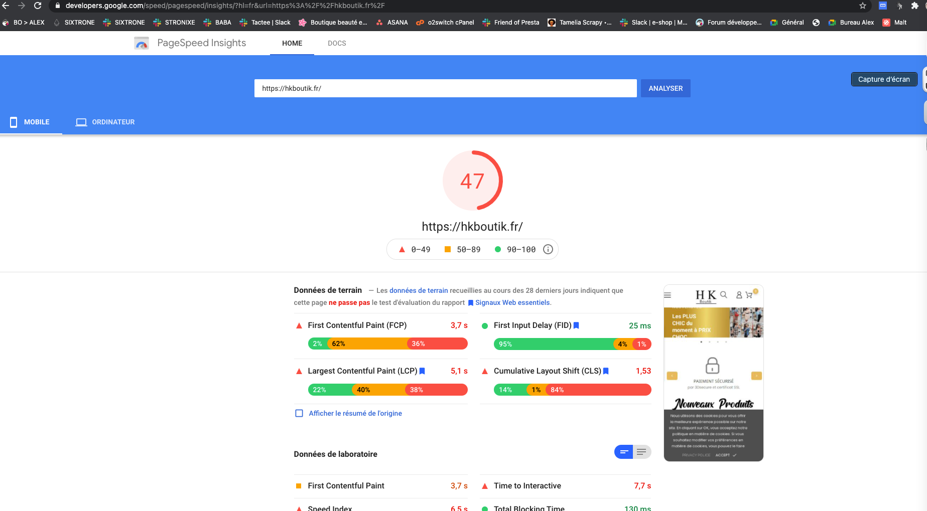

kate66 Posted April 22, 2021 Author Share Posted April 22, 2021 Bonjour, désolé j 'ai du mal a comprendre le test, je vois qu'on est en F sur deux point sécurité et 1 octet.Pourriez-vous me tranmsettre une procédure qui me permettrai de trouver ce bug car ce bug est aléatoire mais tellement génant que nous perdons enormement de clients.Ce matin 9h le site mettait presque 1min par de chargement des pages impossible a utiliser ? MERCI Link to comment Share on other sites More sharing options...
kate66 Posted April 22, 2021 Author Share Posted April 22, 2021 Sur dareboost merci pour le lien d'ailleurs on nous indique que c'est les images mais leur tailles sont pourtant retravailler avant leur upload leur taille est pour moi peut conséquente.C'est une boutique donc avoir des images est je pense normal ? merci pour votre aide. Link to comment Share on other sites More sharing options...

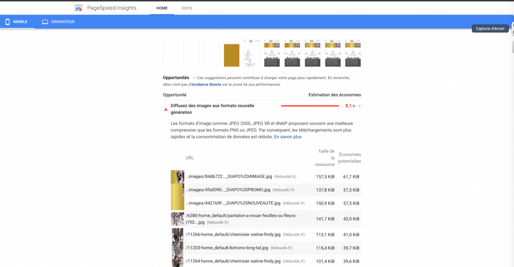

Baba deCode Posted April 22, 2021 Share Posted April 22, 2021 qq conseils, faites vos audits avec google page speed les 3 mesures critiques sont FCP, LCP et CLS utilisez cloudflare utilisez tinypng https://tinypng.com/ pour compresser vos image, utilisez le webp plutot que le jpg (un simple override d'image manager permet d'utiliser la librairie GD en compression webp) utilisez la librairie lazy size afin de faire du lazy loading sur les image et faire du responsive image: https://github.com/aFarkas/lazysizes cdt Link to comment Share on other sites More sharing options...
kate66 Posted April 22, 2021 Author Share Posted April 22, 2021 très bien je vais m'occuper des images les compresser et les reuploader, je n'ai jamais utiliser de librairie je vais voir qu'on procéder.J'avais testr google page speed mais je ne comprends pas trop les résultats FCP, LCP et CLS ? Link to comment Share on other sites More sharing options...
kate66 Posted April 22, 2021 Author Share Posted April 22, 2021 Pourtant nos images sont redimensionner avant chaque upload et je ne comprends pas c'est que bug de lenteur est sur tous le site a chaque appel d'une page cela n'indique pas que justement cela ne peut etre dut au image mais a quelques chose d'autre surtout si c'est aleatoire ? MERCI Link to comment Share on other sites More sharing options...
Baba deCode Posted April 22, 2021 Share Posted April 22, 2021 il faudrait vous rapprocher de votre infogérant si pb de serveur, ou de la personne / agence qui a fait votre site, cdt Link to comment Share on other sites More sharing options...

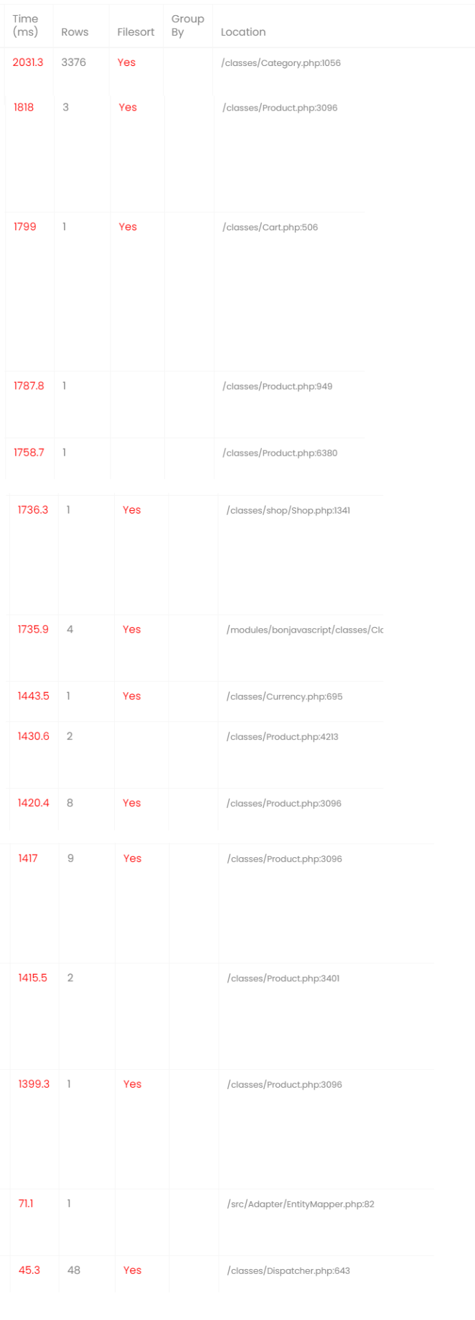

kate66 Posted April 22, 2021 Author Share Posted April 22, 2021 on nous conseiller de supprimer ORDER BY de la requete de produit et categorie pour aller plus vite qu'en pensez vous ? Link to comment Share on other sites More sharing options...
Baba deCode Posted April 22, 2021 Share Posted April 22, 2021 en desactivant ca ne supprime pas le parametrage, c'est seulement si vous desinstaller le module, la requete vers categorie.php trouve 8000 lignes y a donc un pb, cdt Link to comment Share on other sites More sharing options...
kate66 Posted April 22, 2021 Author Share Posted April 22, 2021 ok donc ca serait cela le problème comment corriger cette requete pensez-vous ? MERCI Link to comment Share on other sites More sharing options...
kate66 Posted April 22, 2021 Author Share Posted April 22, 2021 pouvez-vous m'indiquer ces 8000 lignes je ne le trouve pas dans l'imprim ecran ? MERCI Link to comment Share on other sites More sharing options...
Baba deCode Posted April 22, 2021 Share Posted April 22, 2021 pardon 3376 row Link to comment Share on other sites More sharing options...
