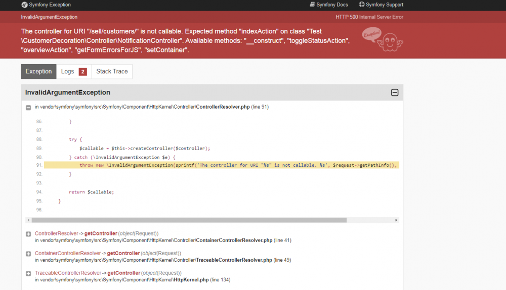

I use composer to load my Class and... it worked fine. Somehow. Except this error on the Customer index in the BO
When I declare this method in my NotificationController it works :
    public function indexAction(Request $request, CustomerFilters $filters)
        return $this->decoratedController->indexAction($request, $filters);
But for every other action (edit, view etc) I have to re-declare every methods.
So two differents situations :
1 ) I did something wrong with my code. My bad.
2 ) I did well, which means that everytime we have to decorate a controller, we have to declare again almost every methods ? With "old" override system we just have to extends the Class, and add/modify methods and/or attributes.
Again if I did right, it's going to be a pain to code in my opinion.
So now I'm stuck between those two statements, and I don't know which one is the good one.
If anybody has an answer to that, I'll very interested.

So it seems that based in my example, you have to extend CustomerController instead of FrameworkBundleAdminController.
So yeah, Dichkovky got the right answer but I haven't tested yet, you can try it by yourself.
