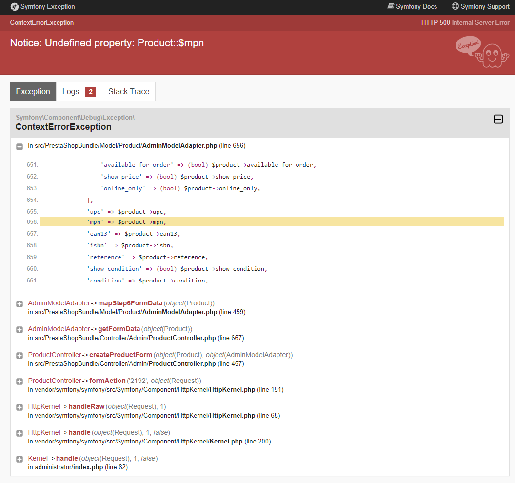

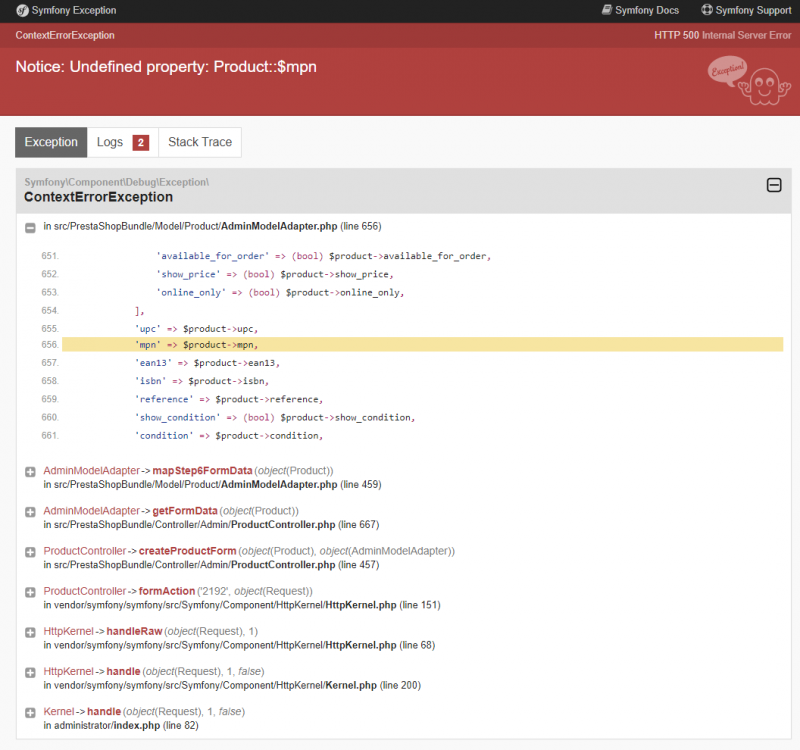

@Prestachamps I tried and it kind of worked. I now have the problem that I can't edit any product... I get the following (related?) error...
Notice: Undefined property: Product::$mpn
Symfony\Component\Debug\Exception\ContextErrorException
in src/PrestaShopBundle/Model/Product/AdminModelAdapter.php (line 656)
