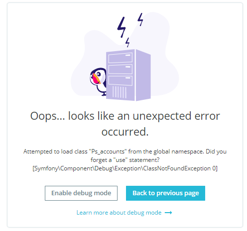

New Facebook module not working
I cannot get the new facebook prestashop module to install properly. I keep getting The controller AdminPsfacebookModule is missing or invalid. when clicking configure.
Anyone else or an idea how to fix?
Thanks! Using 1.7.7.1

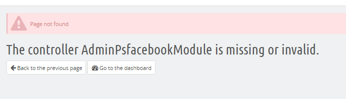

I have same problem, AdminPsfacebookModule missing, I cant allow module getting error Segment::track() requires userId or anonymousId. any idea?
  • Like 1
Share this post
Link to post
I have the same error:
"The controller AdminPsfacebookModule is missing or invalid"
However, on the first attempt to install the module (and on most subsequent attempts), I get the following error:
Only when the installation was successful do I get the first error about AdminPsfacebookModule being missing.
Exactly the same as me.

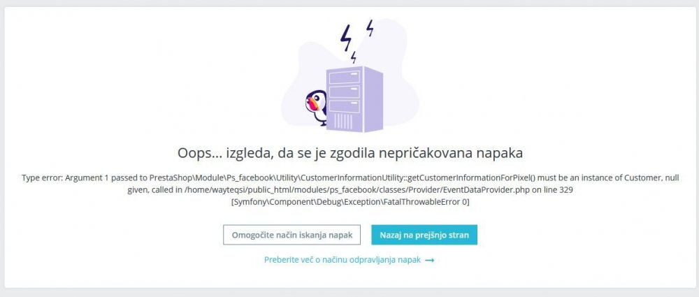

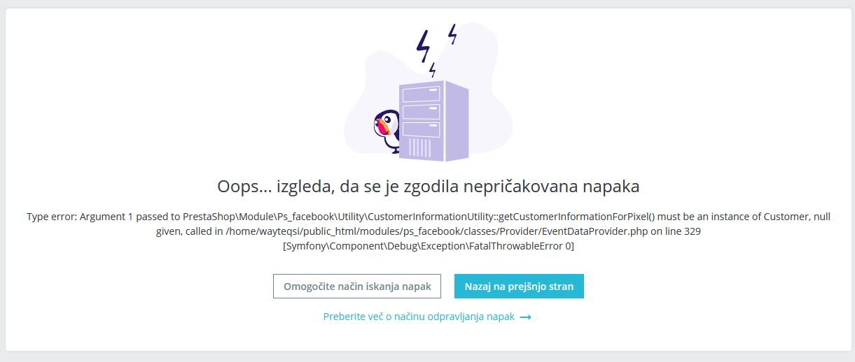

After installation of Prestahop Facebook module I have two problems.
If I send the email to the customer from BO I get the error message. (in attachment).
I am not shore if FB module is the reason but I notice that the new customer can not make a registration (SING IN/No account? Create one here).

I'm using Prestashop 1.7.4.2
For me that option worked well :
After installation of the module
( before the nex step I remember I made a cleaning of the cache )
Click on reload the module prestashop facebook in module window of the back office of prestashop.
reshresh your browser window
Then you can see the Marketing / facebook side bar in the dashboard.
Click on Marketing / Facebook and you will be able to configure your facebook plugin.
Hope it will work for you.

12 minutes ago, Muzarth said:
For me that option worked well : Click on reload the module prestashop facebook in module window of the back office of prestashop.
Then you can see the Marketing / facebook side bar.
I've tried this but its not showing. All I get is the error when trying to configure.
Share this post
Link to post
Thank you Muzarth. It works !!!!
@Chris1d : do not try to configure the module. Go on the left menu : a new item "marketing" will appear ... (I had just to wait a bit to see this new item).
I am using 1.7.7.2 and I have exactly same problem that after installation of ps_facebook, new users cannot register. When I uninstall ps_facebook, users can register.
After I installed PS_FACEBOOK 1.7.1 - These issues are now resolved. I am using PS 1.7.7.3.
