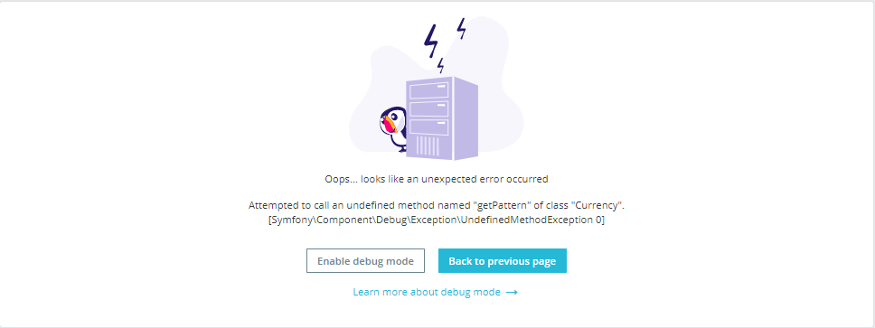

I went to update Prestashop 1.7.6 through 1-click to version 1.7.7 and I can't access the backoffice anymore because it presents this error in the debub:
CRITICAL
php Call to undefined method Currency :: getPattern ()
CRITICAL
request Uncaught PHP Exception Symfony \ Component \ Debug \ Exception \ UndefinedMethodException: "Attempted to call an undefined method named" getPattern "of class" Currency "." at /home/thenatur/public_html/src/Core/Localization/Currency/DataLayer/CurrencyDatabase.php line 120
On backoffice page shows this:
Oops... looks like an unexpected error occurred
Attempted to call an undefined method named "getPattern" of class "Currency".
[Symfony\Component\Debug\Exception\UndefinedMethodException 0]

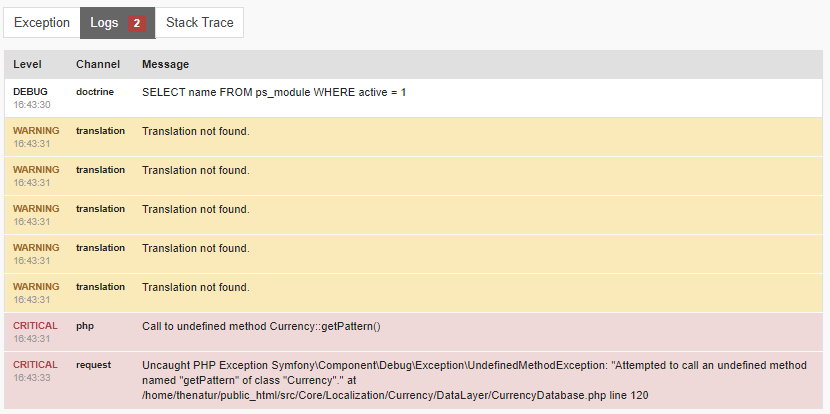

Hi,

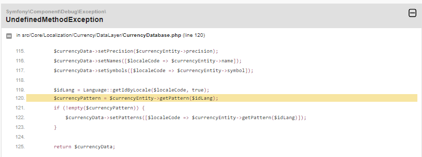

I have already entered the debug, as shown above. I went in the line of code and it appears this:
And I don't know how to fix this error because I don't know what the correct syntax would be.
2 minutes ago, joseantgv said:
Enable DEBUG mode first :)
Sure...eheheheh
Symfony\Component\Debug\Exception\UndefinedMethodException: Attempted to call an undefined method named "getPattern" of class "Currency". at src/Core/Localization/Currency/DataLayer/CurrencyDatabase.php:120 at PrestaShop\PrestaShop\Core\Localization\Currency\DataLayer\CurrencyDatabase->doRead(object(LocalizedCurrencyId)) (src/Core/Data/Layer/AbstractDataLayer.php:90) at PrestaShop\PrestaShop\Core\Data\Layer\AbstractDataLayer->read(object(LocalizedCurrencyId)) (src/Core/Data/Layer/AbstractDataLayer.php:150) at PrestaShop\PrestaShop\Core\Data\Layer\AbstractDataLayer->propagateRead(object(LocalizedCurrencyId)) (src/Core/Data/Layer/AbstractDataLayer.php:94) at PrestaShop\PrestaShop\Core\Data\Layer\AbstractDataLayer->read(object(LocalizedCurrencyId)) (src/Core/Localization/Currency/CurrencyDataSource.php:67) at PrestaShop\PrestaShop\Core\Localization\Currency\CurrencyDataSource->getLocalizedCurrencyData(object(LocalizedCurrencyId)) (src/Core/Localization/Currency/CurrencyDataSource.php:110) at PrestaShop\PrestaShop\Core\Localization\Currency\CurrencyDataSource->formatCurrenciesData(array('EUR'), 'pt-PT') (src/Core/Localization/Currency/CurrencyDataSource.php:97) at PrestaShop\PrestaShop\Core\Localization\Currency\CurrencyDataSource->getAllInstalledCurrenciesData('pt-PT') (src/Core/Localization/Currency/Repository.php:87) at PrestaShop\PrestaShop\Core\Localization\Currency\Repository->getAllInstalledCurrencies('pt-PT') (src/Core/Localization/Locale/Repository.php:207) at PrestaShop\PrestaShop\Core\Localization\Locale\Repository->getPriceSpecifications('pt-PT') (src/Core/Localization/Locale/Repository.php:150) at PrestaShop\PrestaShop\Core\Localization\Locale\Repository->getLocale('pt-PT') (classes/controller/Controller.php:189) at ControllerCore->init() (classes/controller/AdminController.php:2782) at AdminControllerCore->init() (classes/controller/Controller.php:273) at ControllerCore->run() (classes/Dispatcher.php:515) at DispatcherCore->dispatch() (admin8943a56v4/index.php:97)

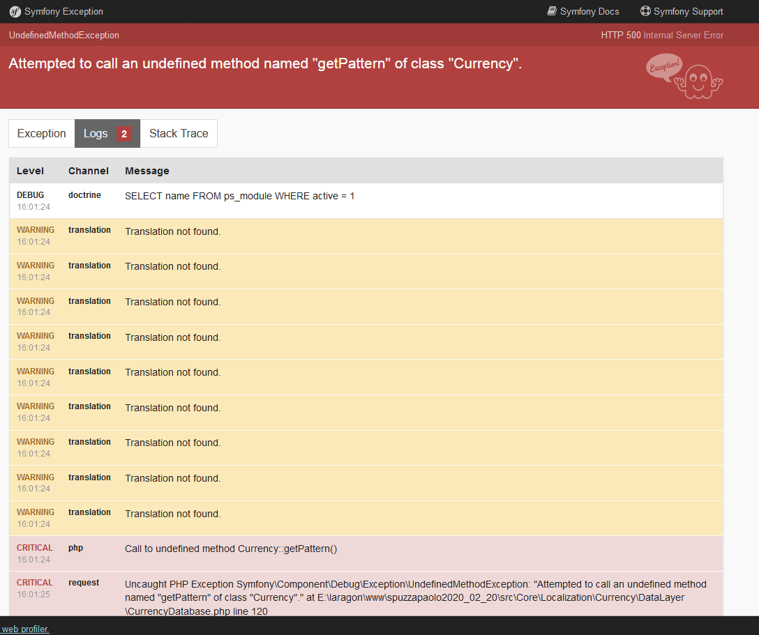

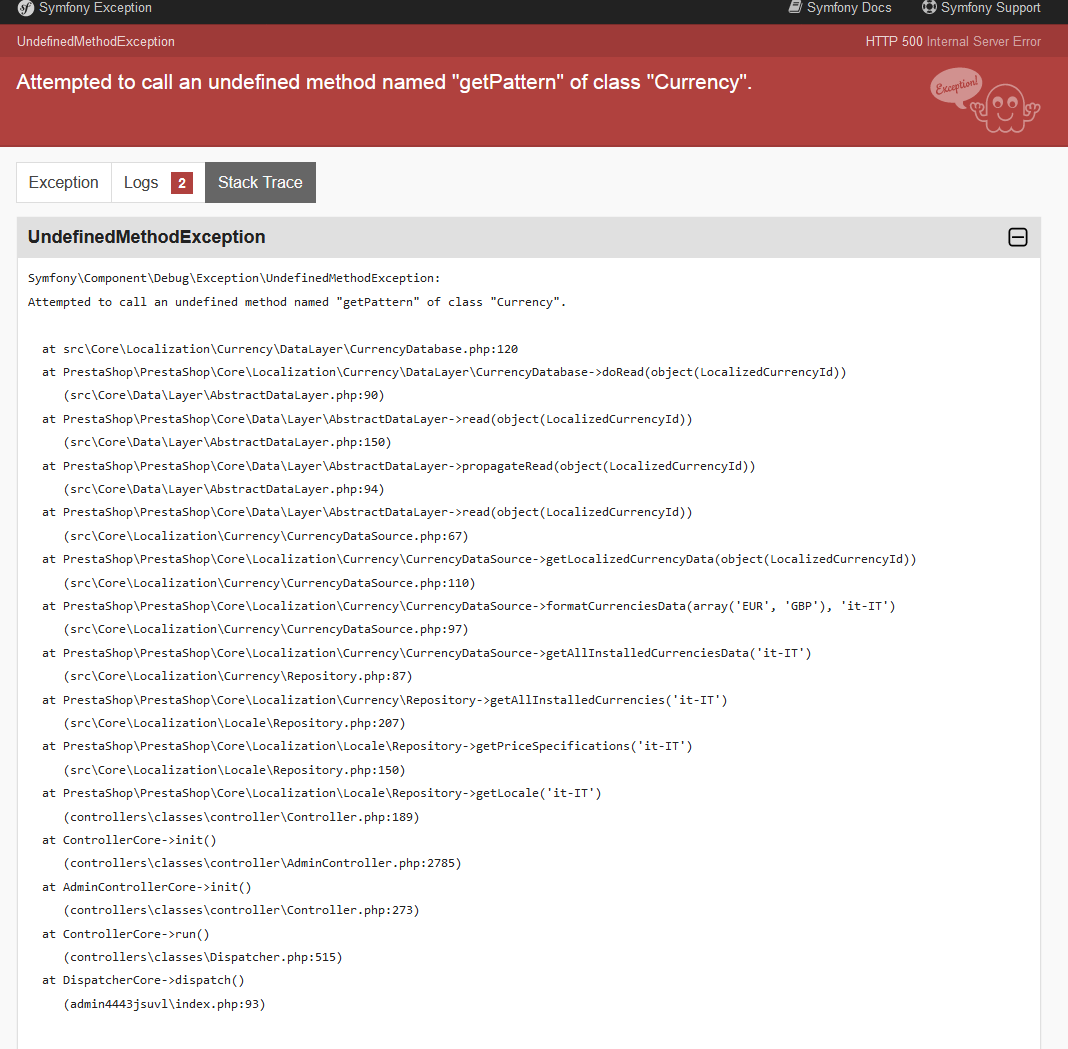

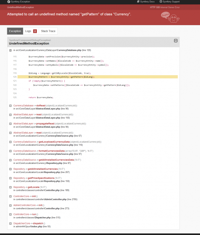

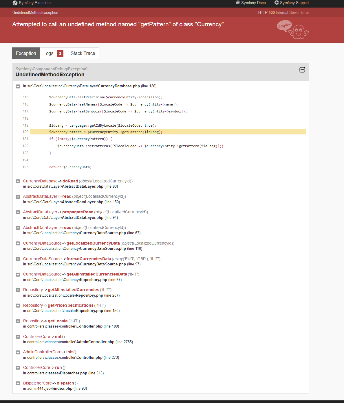

Ok, upgraded from 1.7.6.4 to 1.7.7.2
1-Click Upgrade
php 7.3.9
Received these errors on admin login
1531929725_Screenshot_2021-02-23AttemptedtocallanundefinedmethodnamedgetPatternofclassCurrency(500InternalServerError).thumb.png.45babca6242f28df461b3b1d72219ed6.png
2052389861_Screenshot_2021-02-23AttemptedtocallanundefinedmethodnamedgetPatternofclassCurrency(500InternalServerError)(1).thumb.png.74a1428ec9bbbfbad120e28d547dc97c.png
740446670_Screenshot_2021-02-23AttemptedtocallanundefinedmethodnamedgetPatternofclassCurrency(500InternalServerError)(2).thumb.png.bffbb206a0204f2a1e534c8792f62e9b.png
Received these errors in frontoffice
Fatal error: Uncaught Error: Call to undefined method Currency::getPattern() in E:\laragon\www\spuzzapaolo2020_02_20\src\Core\Localization\Currency\DataLayer\CurrencyDatabase.php:120
Stack trace:
#0 E:\laragon\www\spuzzapaolo2020_02_20\src\Core\Data\Layer\AbstractDataLayer.php(90): PrestaShop\PrestaShop\Core\Localization\Currency\DataLayer\CurrencyDatabase->doRead(Object(PrestaShop\PrestaShop\Core\Localization\Currency\LocalizedCurrencyId))
#1 E:\laragon\www\spuzzapaolo2020_02_20\src\Core\Data\Layer\AbstractDataLayer.php(150): PrestaShop\PrestaShop\Core\Data\Layer\AbstractDataLayer->read(Object(PrestaShop\PrestaShop\Core\Localization\Currency\LocalizedCurrencyId))
#2 E:\laragon\www\spuzzapaolo2020_02_20\src\Core\Data\Layer\AbstractDataLayer.php(94): PrestaShop\PrestaShop\Core\Data\Layer\AbstractDataLayer->propagateRead(Object(PrestaShop\PrestaShop\Core\Localization\Currency\LocalizedCurrencyId))
#3 E:\laragon\www\spuzzapaolo2020_02_20\src\Core\Localization\Currency\CurrencyDataSource.php(67): PrestaShop\PrestaShop\Core\Da in E:\laragon\www\spuzzapaolo2020_02_20\src\Core\Localization\Currency\DataLayer\CurrencyDatabase.php on line 120
Edited by notsureabout (see edit history)
Strange. There is a function getPattern() both in /classes/Currency.php and /src/Core/Localization/Currency.php.
My guess would be that it has something to do with the table ps_currency_lang that was introduced in PS version 1.7.6. That table contains a field with the name pattern with usually the value NULL.
Edited by musicmaster (see edit history)
