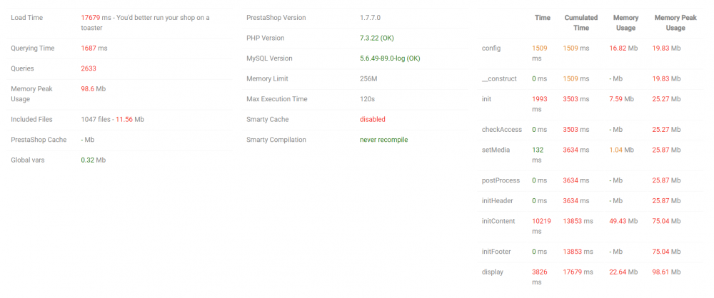

Hexawebit Posted January 10, 2021 Share Posted January 10, 2021 Hi! Yesterday i upgraded my Prestashop site with "1-Click Upgrade Module" from 1.7.6.5 to 1.7.7.0. At the end of update process the module said "Upgrade successuful" so i try to go in Front Office and the site load really really slow, with a TTFB (20s - 40s) can you help me? This is the result of profiler: Link to comment Share on other sites More sharing options...
Prestachamps Posted January 10, 2021 Share Posted January 10, 2021 Hi, According to the image sent the site Performance is set to : Never Recompile and cache is disabled. Activating Cache, as well changing the recompile option will solve your issue (probably) Go to the Advance Parameter ===> Performance set Compile to Recompile template whenever something has changed. and set Cache to yes. I would also recommend to check the apache optimization - if it's not set than it can easily happen that your Gzip option is not working either. Keep us ported. Cheers, Leo Link to comment Share on other sites More sharing options...

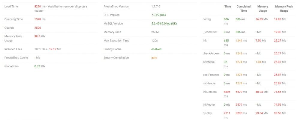

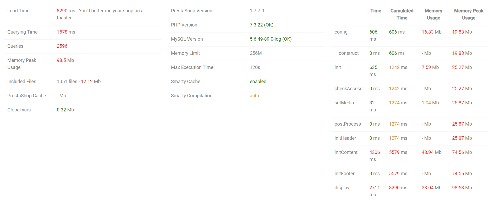

Hexawebit Posted January 10, 2021 Author Share Posted January 10, 2021 44 minutes ago, Leo @ Prestachamps said: Hi, According to the image sent the site Performance is set to : Never Recompile and cache is disabled. Activating Cache, as well changing the recompile option will solve your issue (probably) Go to the Advance Parameter ===> Performance set Compile to Recompile template whenever something has changed. and set Cache to yes. I would also recommend to check the apache optimization - if it's not set than it can easily happen that your Gzip option is not working either. Keep us ported. Cheers, Leo Hello Leo! Thanks for your reply! I set your tips on my web site, but the Load time still High 8s The initContent and the display are really high Link to comment Share on other sites More sharing options...
Prestachamps Posted January 10, 2021 Share Posted January 10, 2021 Hi, As I can see the TTFB(time to first byte) is still above 1.5 seconds. Which is ridiculously high. I would appreciate if you could share with us Advance Parameters==>information, and the entire Performance part as well. the init content can be high because of a module like a slider (usually) Anyhow, if you would share the above info, as well the URL of the site would be of great help. In case that's not possible, send me a PM with ti. Cheers, Leo Link to comment Share on other sites More sharing options...
