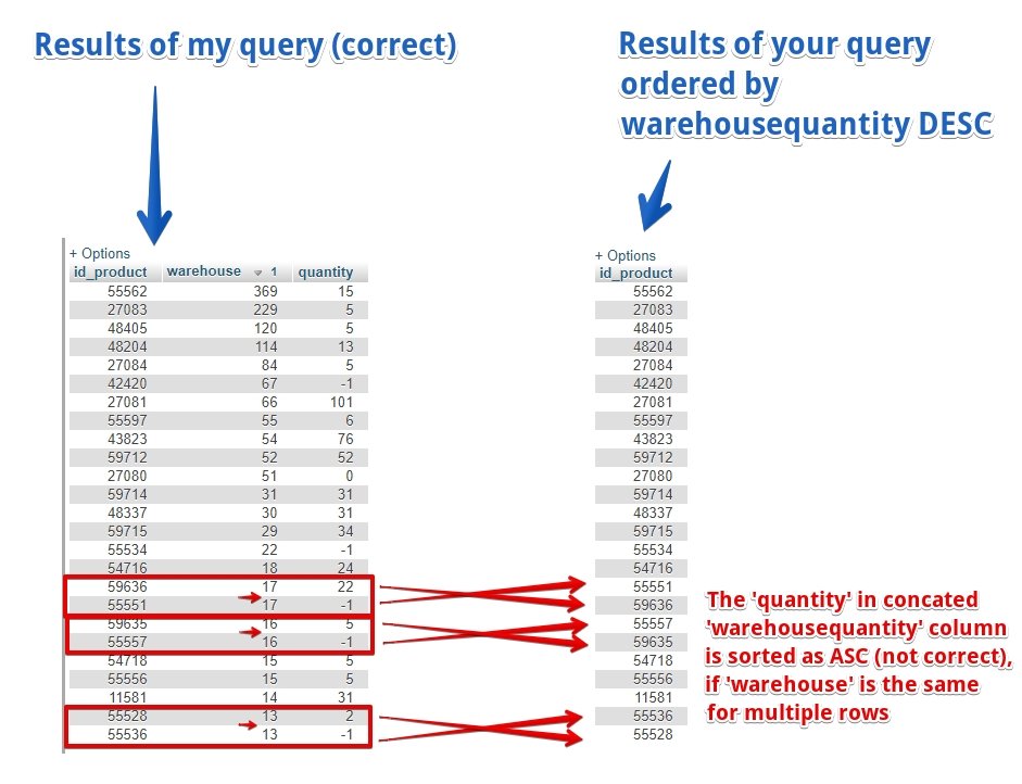

@EvaF Your original query was probably more to the point. I DO need to work with custom 'warehouse' column from ps_product_shop along with native 'quantity' column from ps_stock_available table.
Those columns do exist. The original query from my first post in this thread works well, however yours returns "No products found".
I really appreciate your help and I would be extremely happy if we could get it working somehow. Do you have any ideas why id doesn't work?
By the way, I stated in this comment, that your query works correctly when run like that directly in phpMyAdmin. Turns out it does not. I needed to sort products by 'warehouse' value primarily, and by 'quantity' value secondarily. So, this would be correct:
| # | Product   | warehouse | quantity |
| 1 | Lorem     | 45        | 120      |
| 2 | Ipsum     | 42        | 0        |
| 3 | Dolor     | 35        | 12       |
| 4 | Sit amet  | 35        | 2        |
| 5 | Blabla    | 22        | 52       |
But your query resulted in this (notice switched products 3 and 4, it didn't sort by secondary 'quantity' column correctly):
| 3 | Sit amet  | 35        | 2        |
| 4 | Dolor     | 35        | 12       |
Thank you very very much.
aha, ok
at first you have to make one premise ( otherwise you have to handle concat by php script):
quantity will be allways sorted desc
then the concat will look:
concat(10000000 + warehouse,110000000 - quantity ) as warehousequantity
and now to the problem The original query from my first post in this thread works well, however yours returns "No products found":

When I try to run it in phpMyAdmin, I am getting this error:
#1064 - You have an error in your SQL syntax; check the manual that corresponds to your MySQL server version for the right syntax to use near 'p.id_product, warehousequantity FROM (SELECT p.id_product, p.id_manufacturer, SU' at line 1
By the way, I tried to run your query sorted by warehousequantity column DESC, and the results are not correct (see the attached pic please).
Edited by TinoArts (see edit history)
ok, I would need to debug your query to answer precise - now i can only guess from queries you post:
Mysql.php:
if ($this->getInitialPopulation() === null) {
	$selectFields[]='warehousequantity';
 $query .= ' JOIN ( SELECT aps.id_product,
            concat(aps.warehouse+100000,if(asa.quantity<0, 110000000-asa.quantity,120000000 - asa.quantity )) as warehousequantity
            FROM ' . _DB_PREFIX_ . '_product_shop aps
            INNER JOIN ' . _DB_PREFIX_ . '_stock_available asa ON aps.id_product = asa.id_product ) ws ON p.id_product = ws.id_product ';
